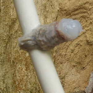

Step 4: Drill Hole. Drive Nail.
You can drive a nail through PVC pipe if you drill a slightly tight hole for the nail first. Don't make it too tight, or the plastic might split. I think I used a 2 inch nail. The nail is the post upon which the silicone rubber and string finger will be formed.
Step 5: Build Up the Finger
I use string or light rope as filler while I build up the finger with silicone. The fill material helps conserve on silicone. I buy clear silicone at the hardware store in cartridges that go in a grease gun.
Keep the string or rope saturated with silicone as you wind it around the nail. I flatten the silicone at the tip of the finger a little bit for comfort.
