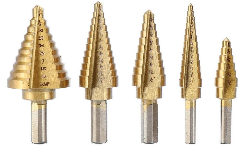

⦾ Drilling machine, with step drill bits

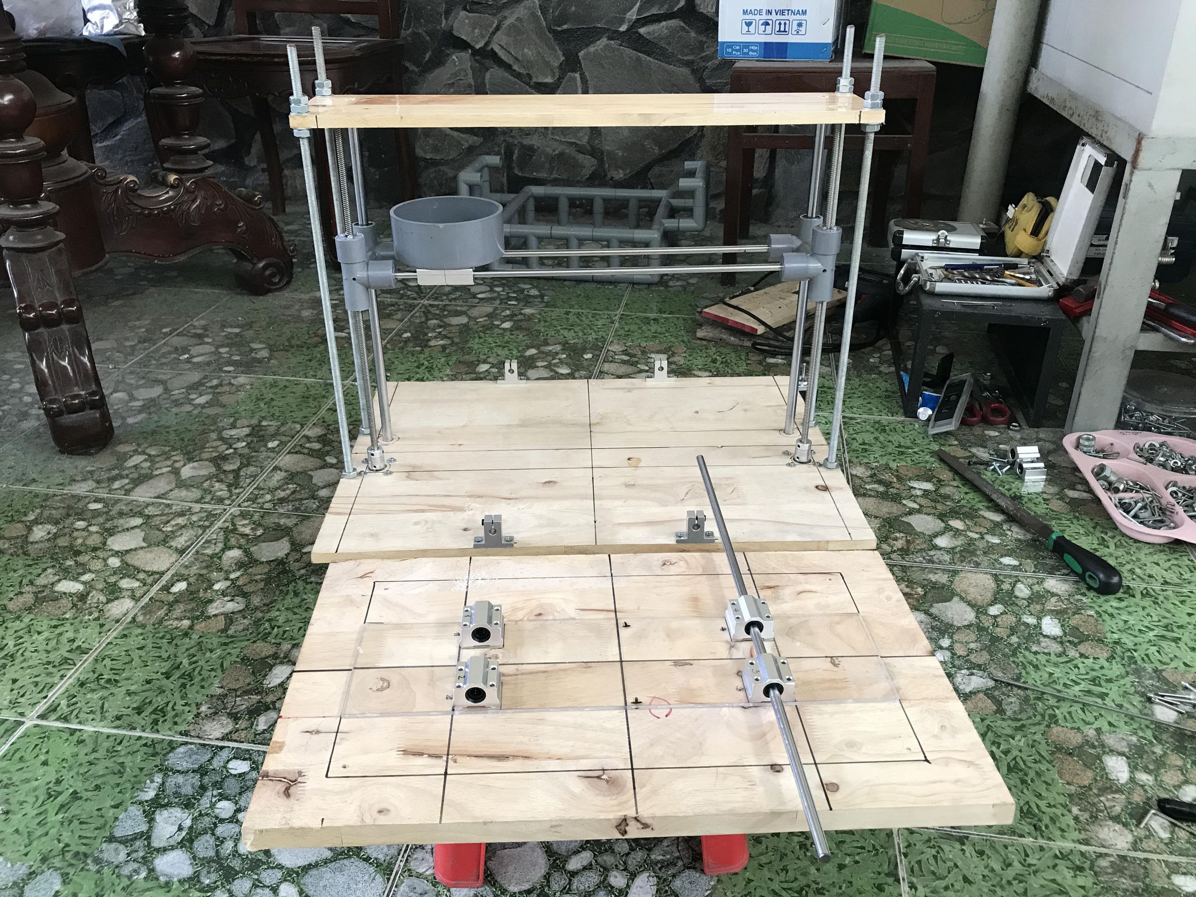

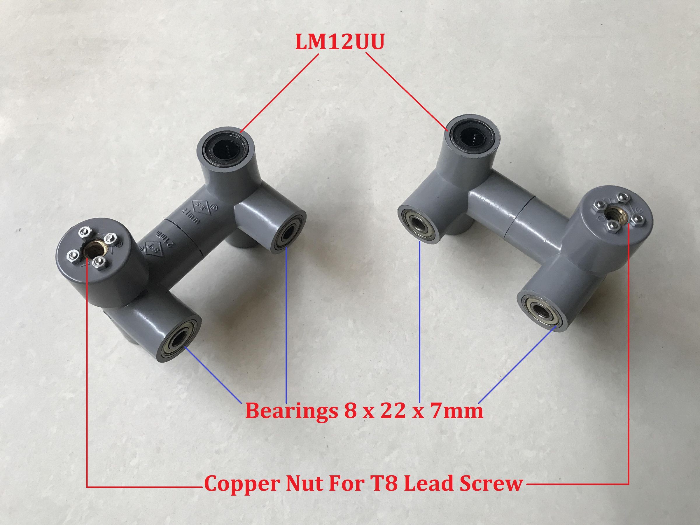

Step 1: Z Axis Assembly

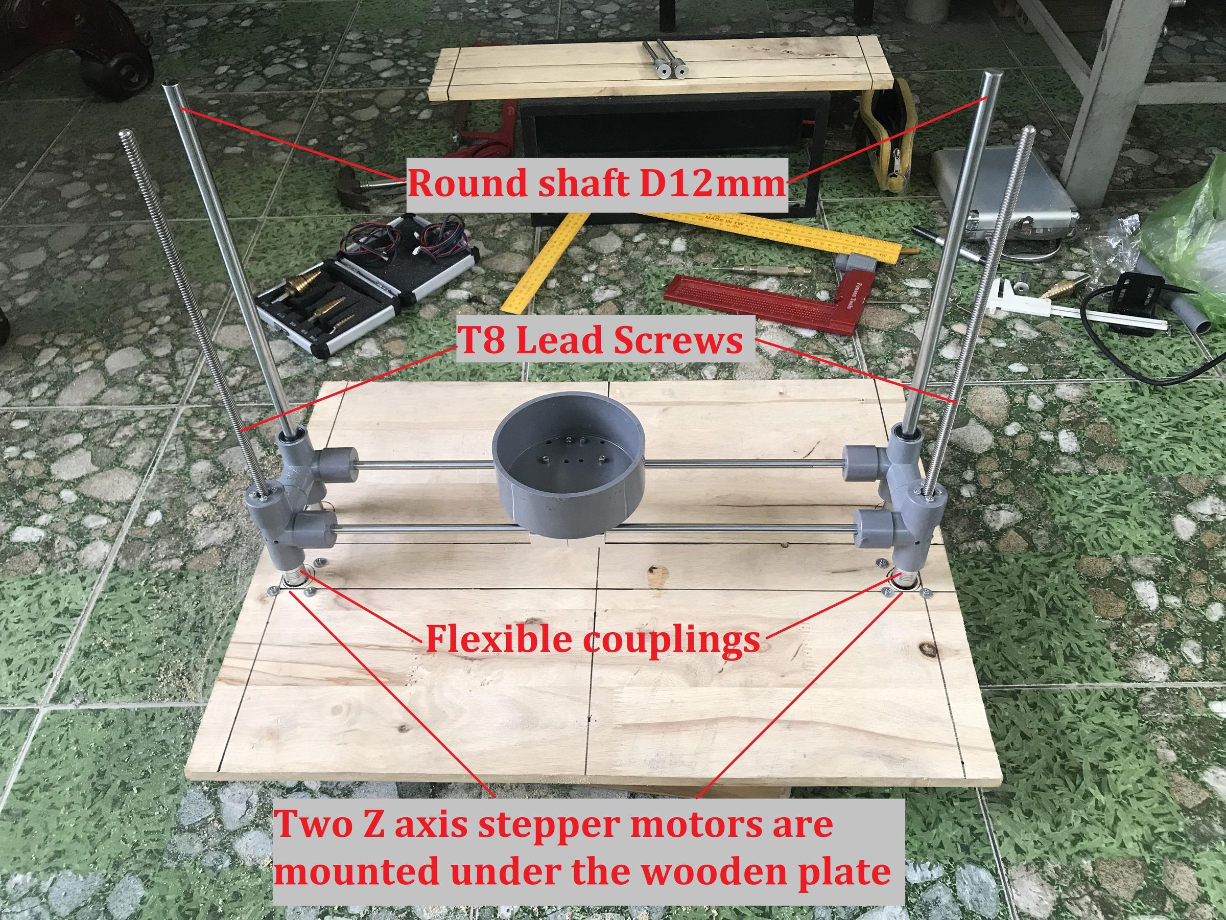

I built my 3D printer - Z parts by this way:
⦾ LM12UU bearings has inner diameter 12mm, outer diameter 21mm and length 30mm that works with 12mm shafts. Since LM12UU's outside diameter and PVC fittings' inner diameter (Ø21mm) are the same, they can be easily inserted into PVC fittings holes and adjusted by heater gun.
⦾ Firstly, I glued 2 pcs x PVC Four Way Tee Ø21mm together. After connecting them together, we are left with 6 open holes.
⦾ I chose 2 open holes through each other to build Z part. The above assembly has two pairs of such holes.
⦾ Z axis includes 2 parts: left and right. For each part, I inserted 2 sets of LM12UU bearings into the "hole through hole" position of four-way tee to guide with linear shaft 12mm.
⦾ Remaining "hole through hole" position, I inserted the copper nut at one side and bearing at the other side for T8 lead screw.
⦾ We still have 2 holes, they are connected to the X axis. I inserted 2 bearings into these holes for fixing and aligning the X axis - round shaft 8mm in the next step.

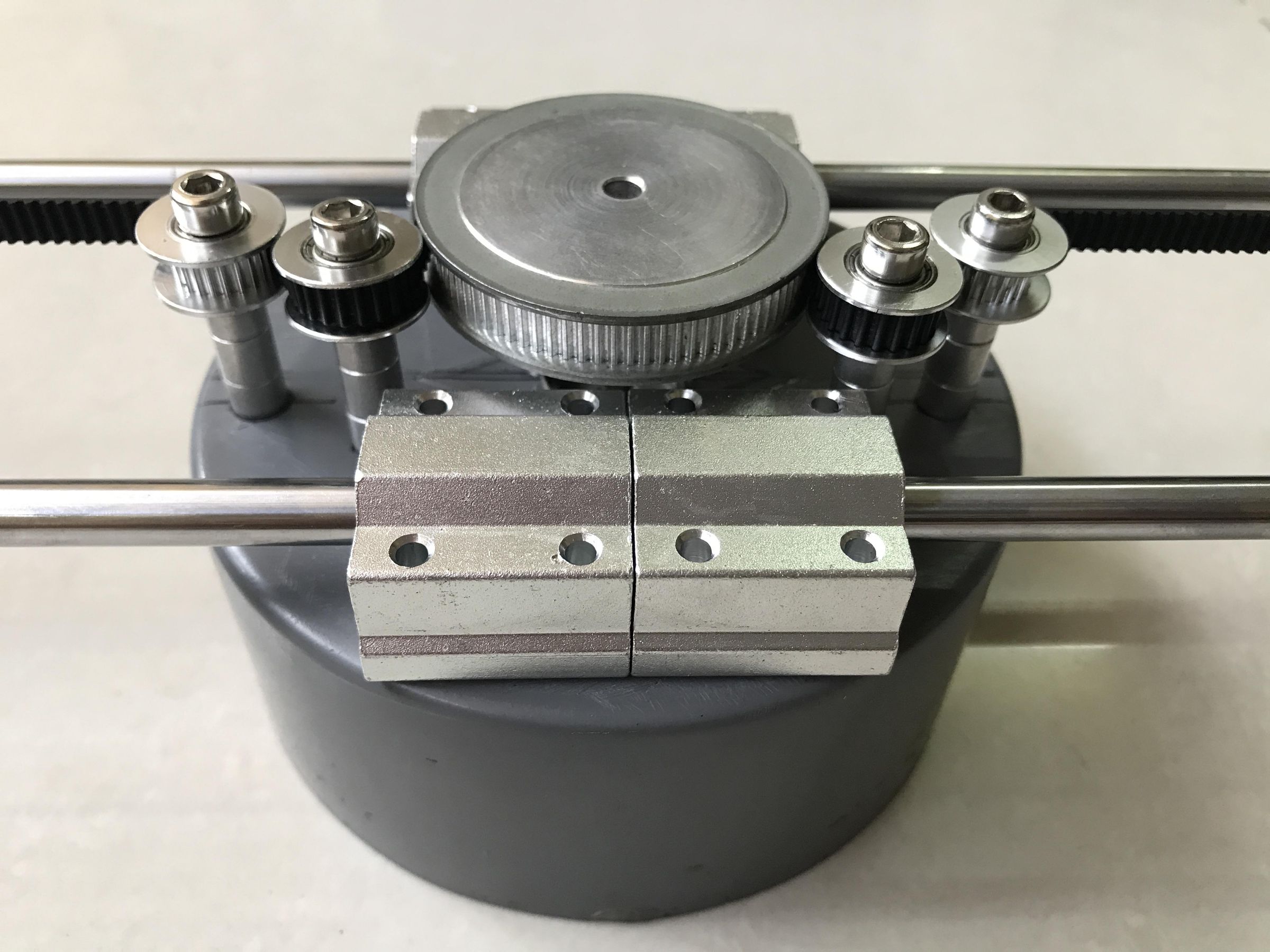

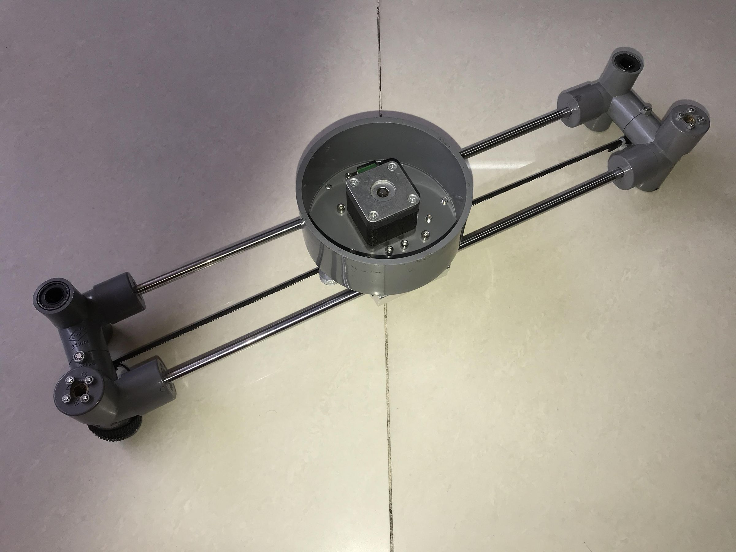

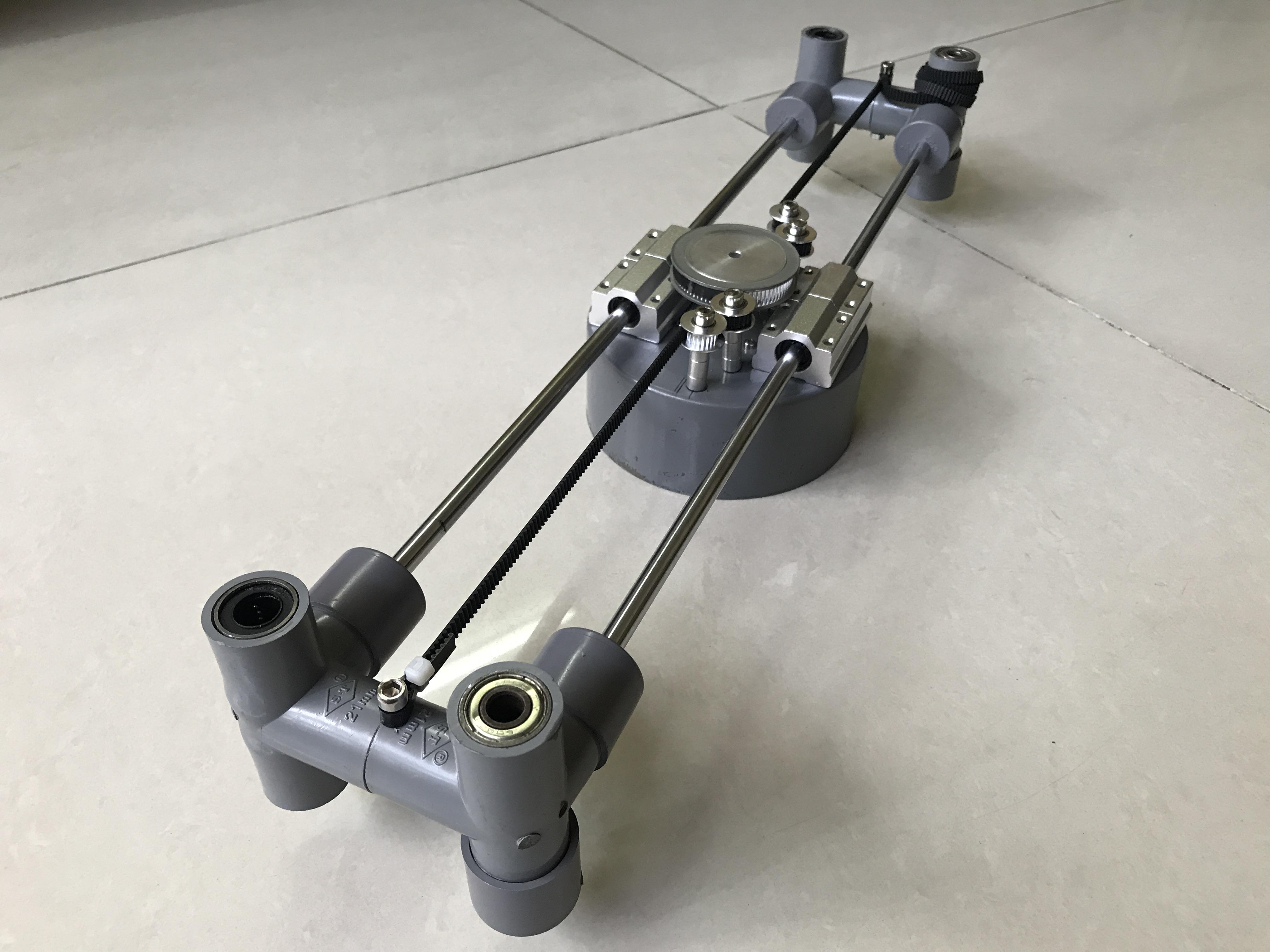

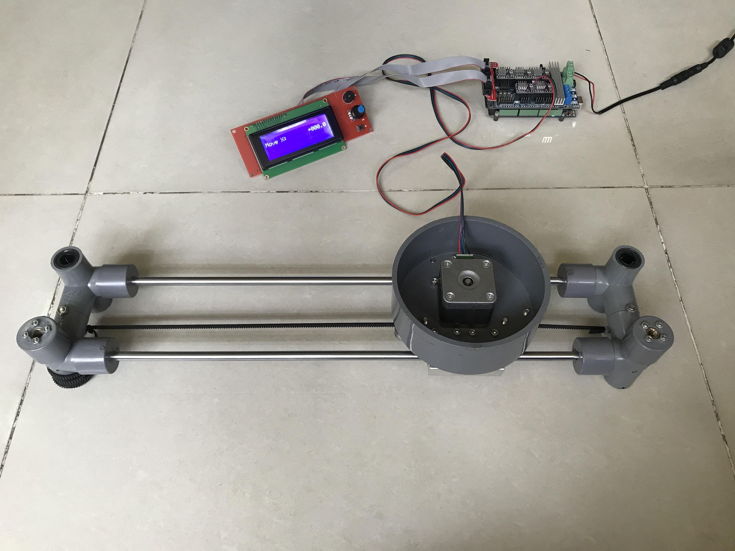

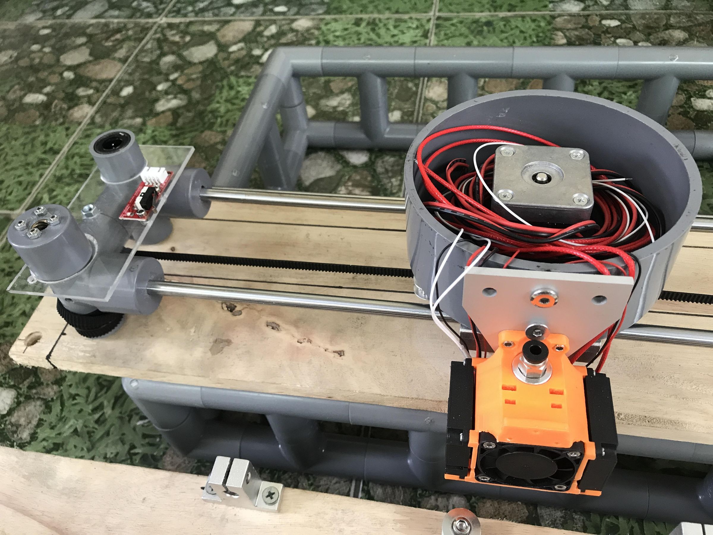

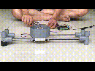

Step 2: X Axis Assembly

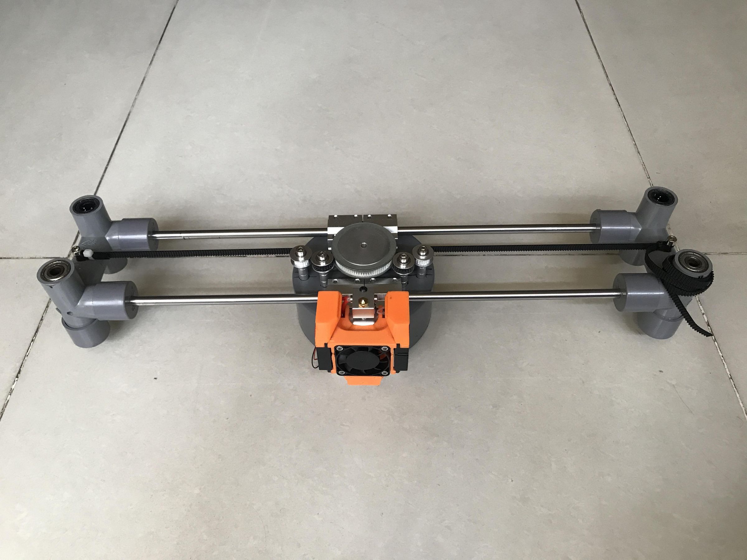

X-axis was built as follows:

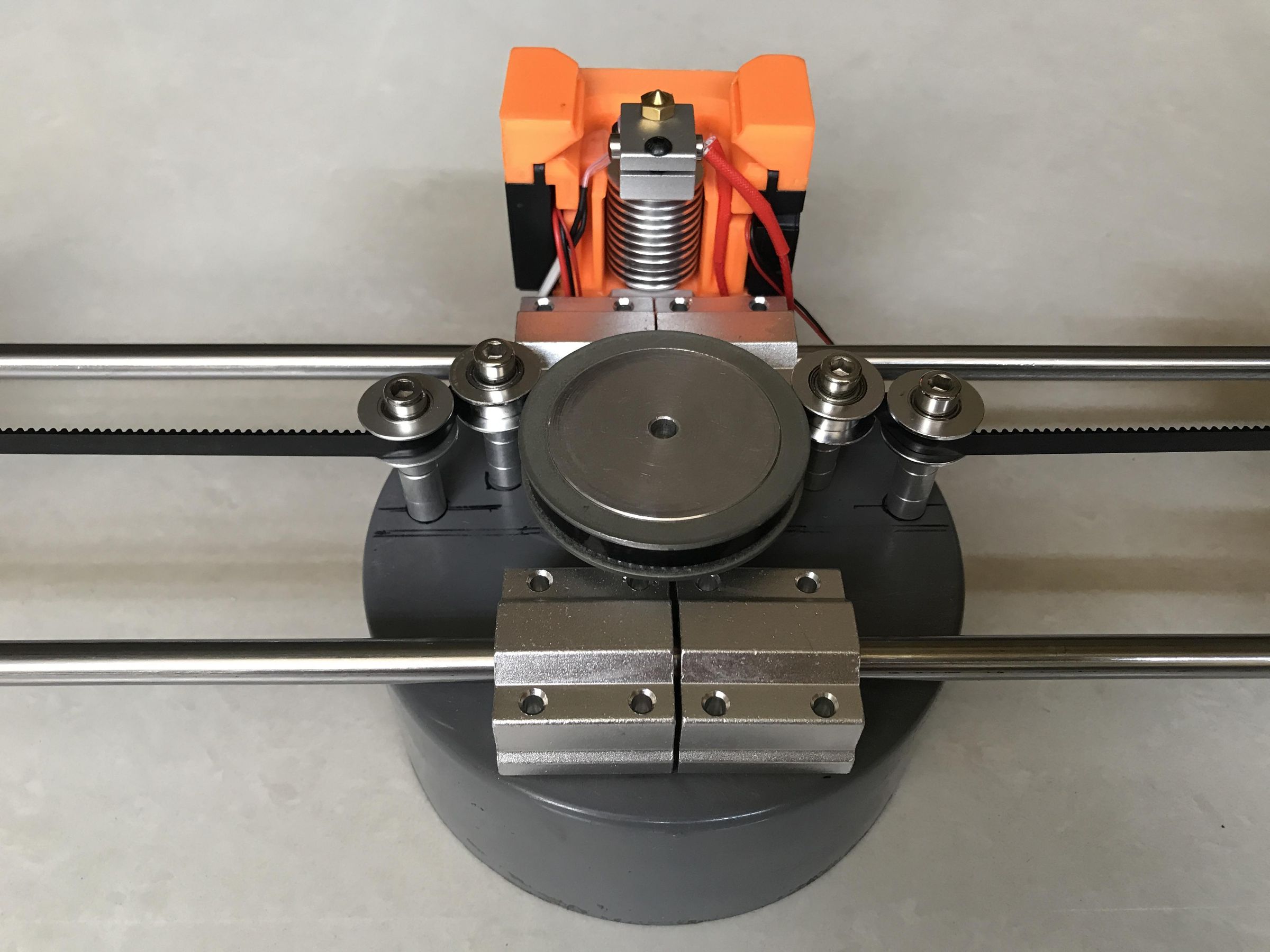

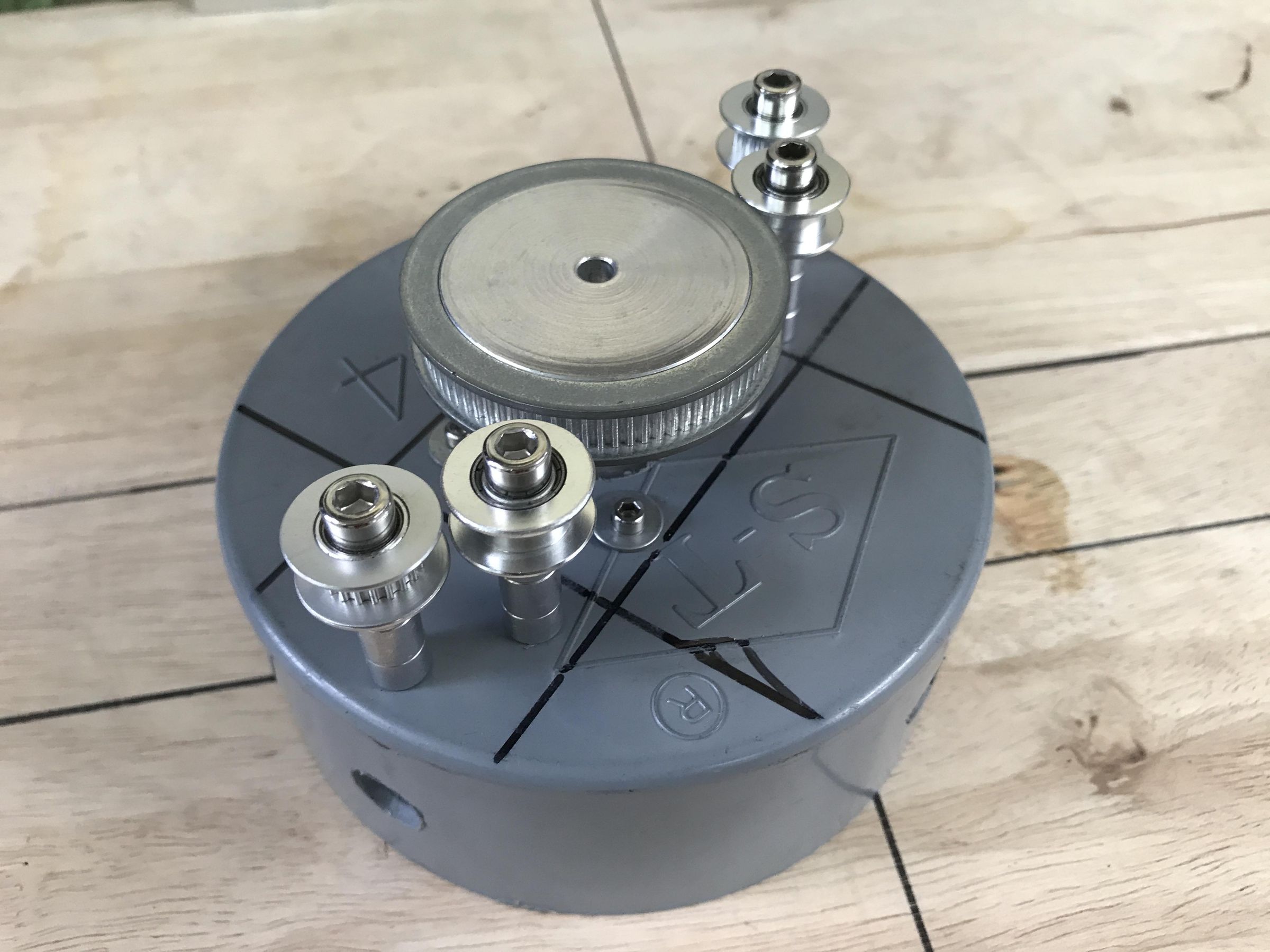

⦾ I installed X stepper motor with 80 teeth pulley on the PVC endcap Ø114mm. I liked the idea of fixing belt with moving stepper motor. So each side of 80 teeth pulley, I mounted one 20 teeth idler pulley and one toothless idler pulley. Two 20 teeth pulleys (located outside) were symmetrically aligned with the 80-tooth pulley across the center line.They are arranged as shown below.
⦾ 4pcs x SC8UU ball bearings were also mounted on this endcap for guiding X axis linear motion through 8mm round shafts, length 500mm.
⦾ I assembled this PVC endcap into the Z left and right part that made above. Then I threaded a timing belt through the pulleys and fixed it at both ends with 5mm bolts.
⦾ When operating, the X axis is in the direction shown below, with the stepper motor's bottom facing up and the belt system below. The X-axis stepper motor was fully enclosed in the PVC endcap by this way.
⦾Honestly, I didn't know if it would worked smoothly or not so I had to try it, and then proceed to the next steps.
⦾ Here is the test result:

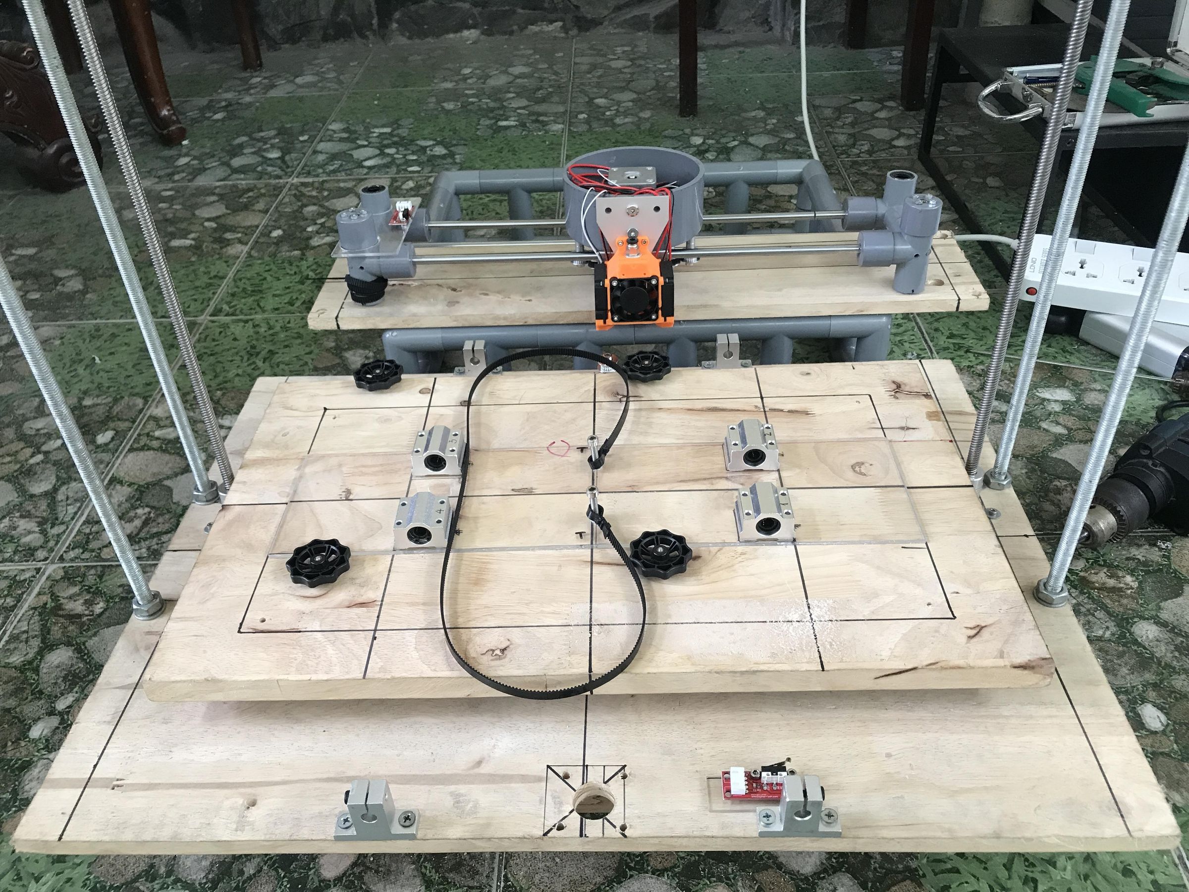

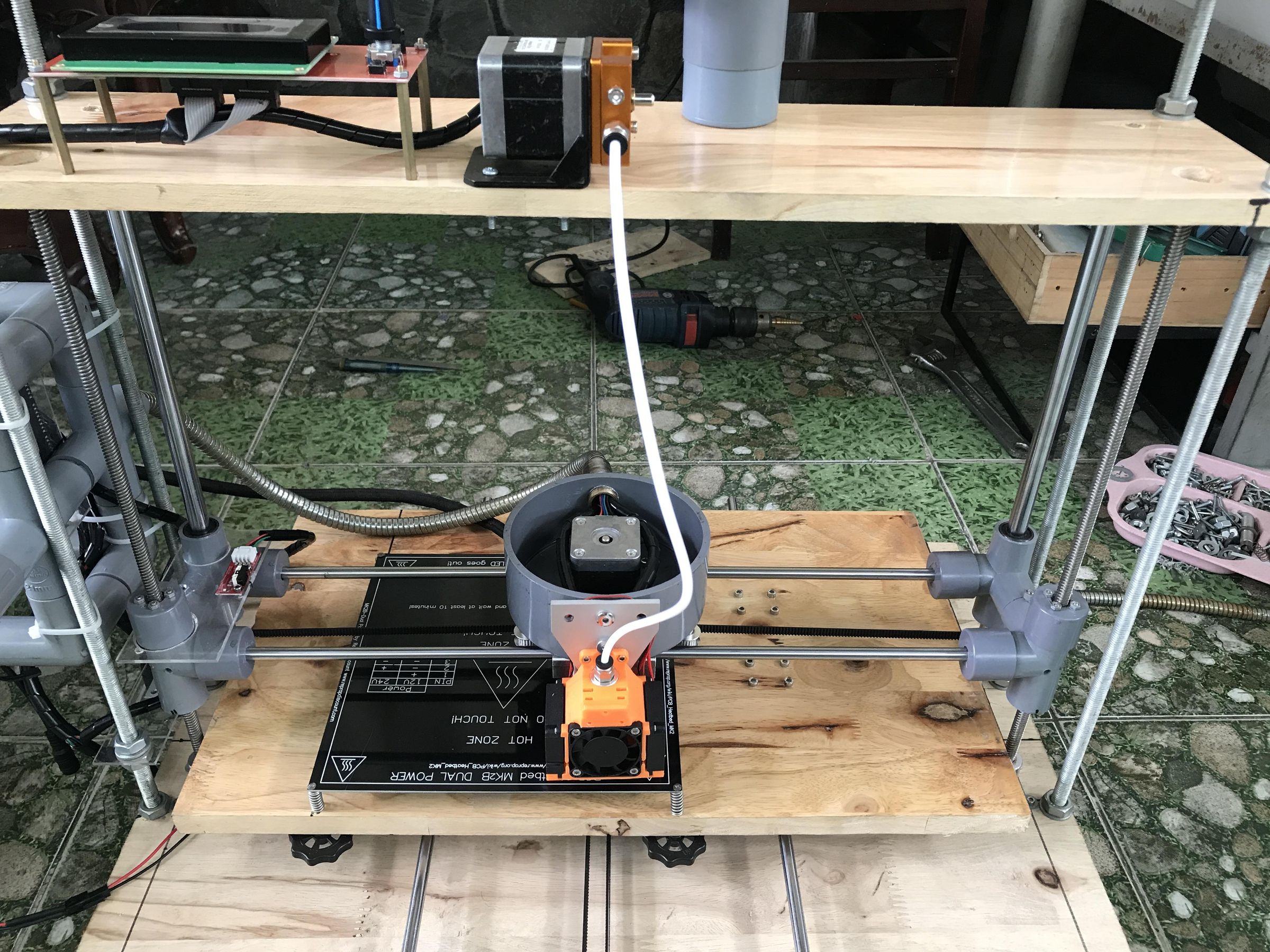

Step 3: Frame Assembly

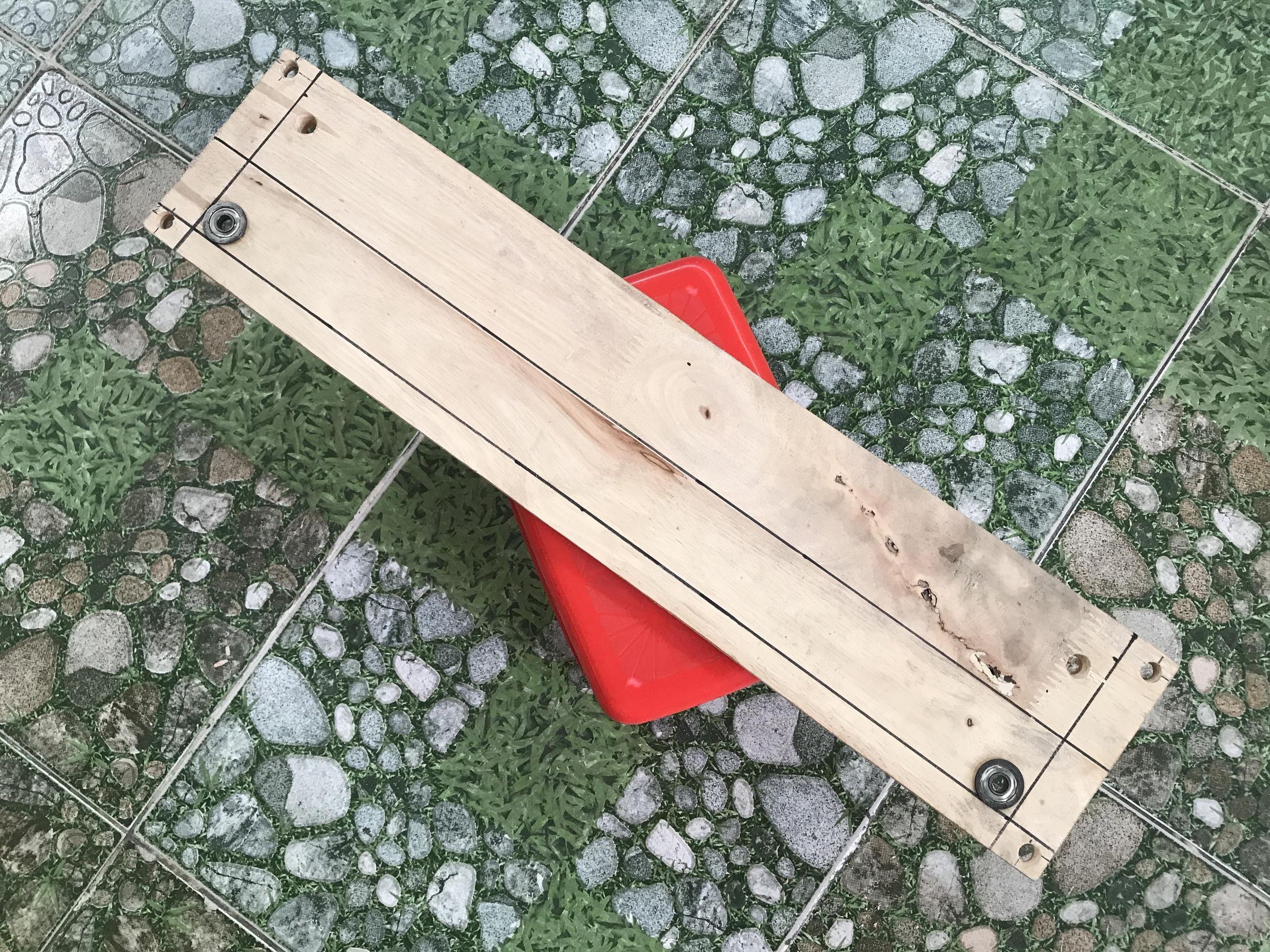

⦾ I carefully measured the XZ part assembled in previous step, marked then drilled 4 big holes on the wodden plate size 600x500x12mm for T8 lead screws and round shaft Ø12mm. Two Z stepper motors were mounted under the wooden plate and connected to lead screw by flexible couplings.
⦾ I tested and aligned by rotating the lead screws by hand.

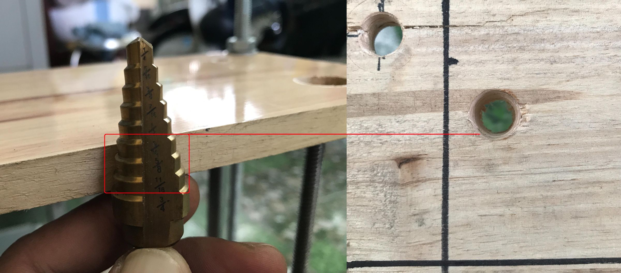

⦾ A wodden plate size 600x130x12mm was mounted on the top of frame. Two flanged shielded bearings were also installed to prevent lead screws from wobbling.
⦾ Because I used step drill bit so when the small diameter was finished drilling, it will move to the next diameter step. Since wood thickness is 12mm, and each step of drill bit has a depth of 4mm, so 3 steps of the drill bit were drilled into the wood. To fix the shaft 12mm to the wood plate, I drilled 3 steps of drill bit as follow: 12mm, 10.5mm and 9mm.
⦾ I installed this wood plate on the top of 3D printer frame, it was fixed via 4 threaded rods diameter 10mm and 2 shafts diameter 12mm.

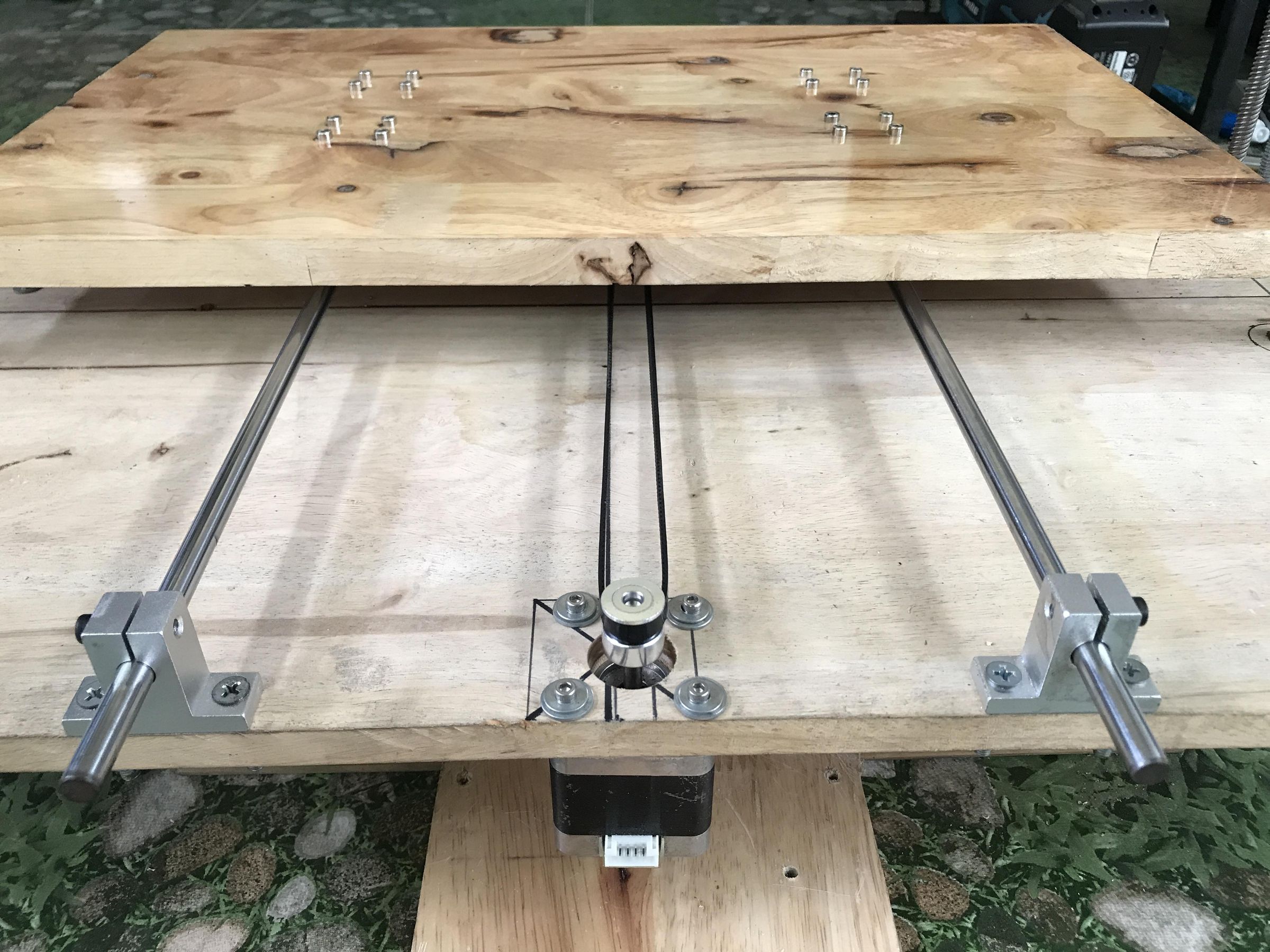

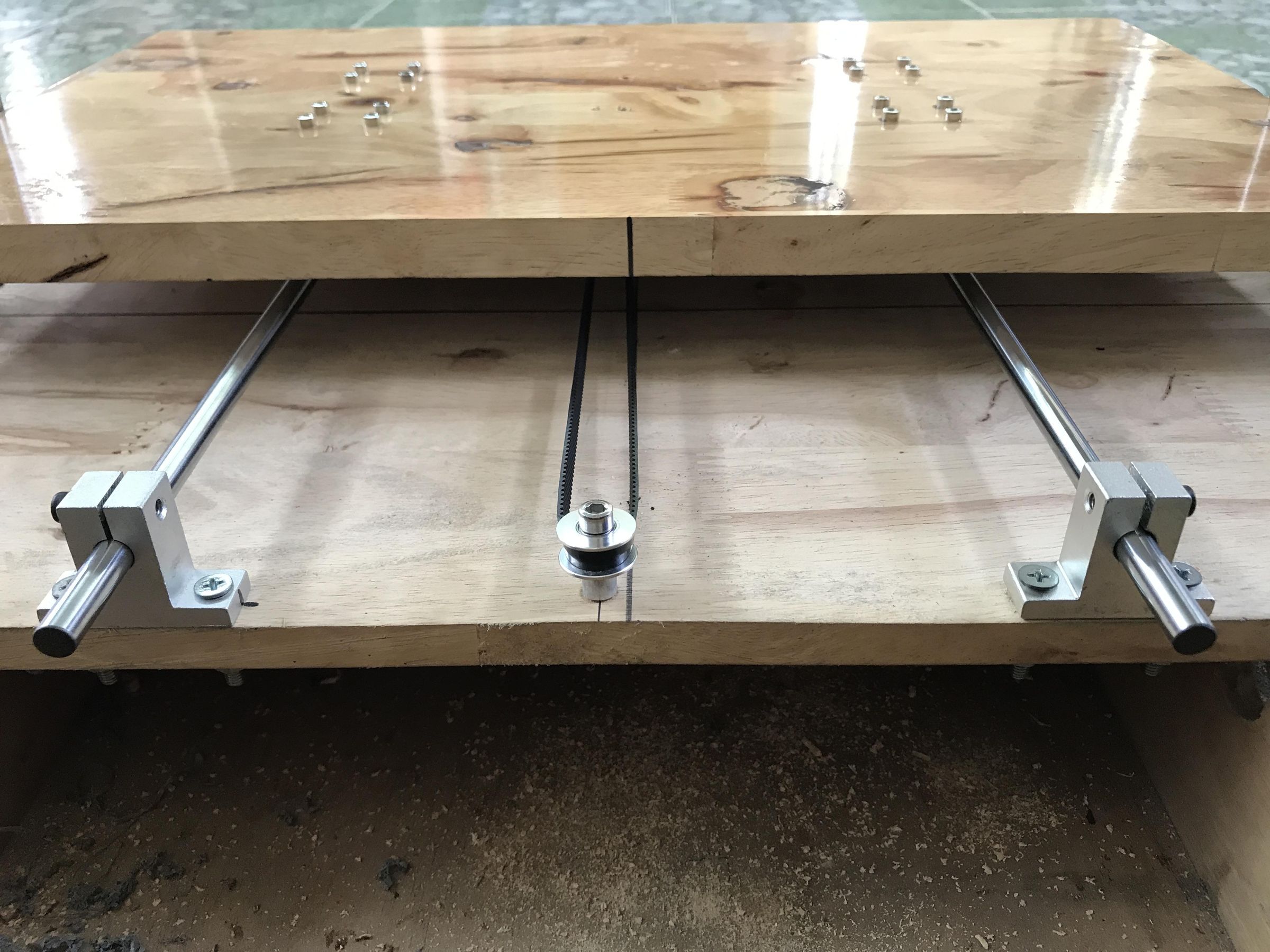

Step 4: Y Axis Assembly

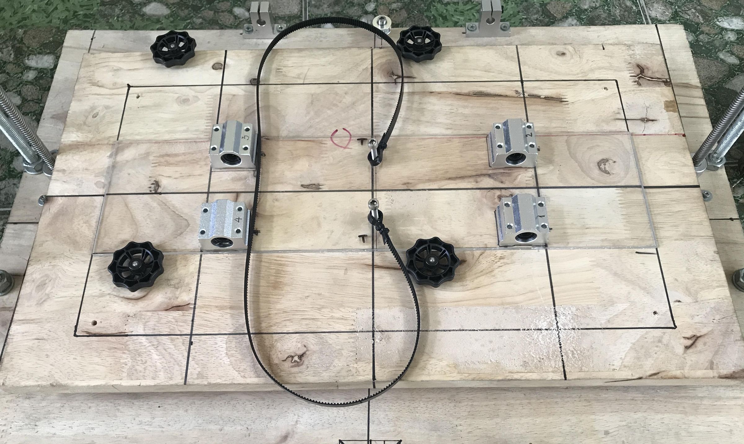

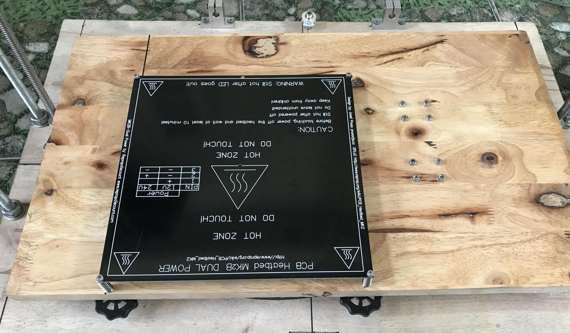

⦾ 4pcs x SC8UU ball bearings were mounted on the wooden plate 500x450mm for guiding Y axis linear motion through 8mm round shafts, length 500mm.
⦾ Y stepper motor was install at bottom wooden plate. It drives Y-carriage via timing belt and 20 teeth pulley.
⦾ Opposite the Y stepper motor is 20 teeth idler pulley.
⦾ The Y carriage timing belt was fixed by 2pcs x M5 bolts and cable ties.
⦾ Heatbed 214x214mm 12V/24V Dual Power MK2B was installed on the Y carriage. My printer can be reach a build volume about 400 x 350 x 220mm but it was limited to 200 x 200 x 200mm due to heated bed size.

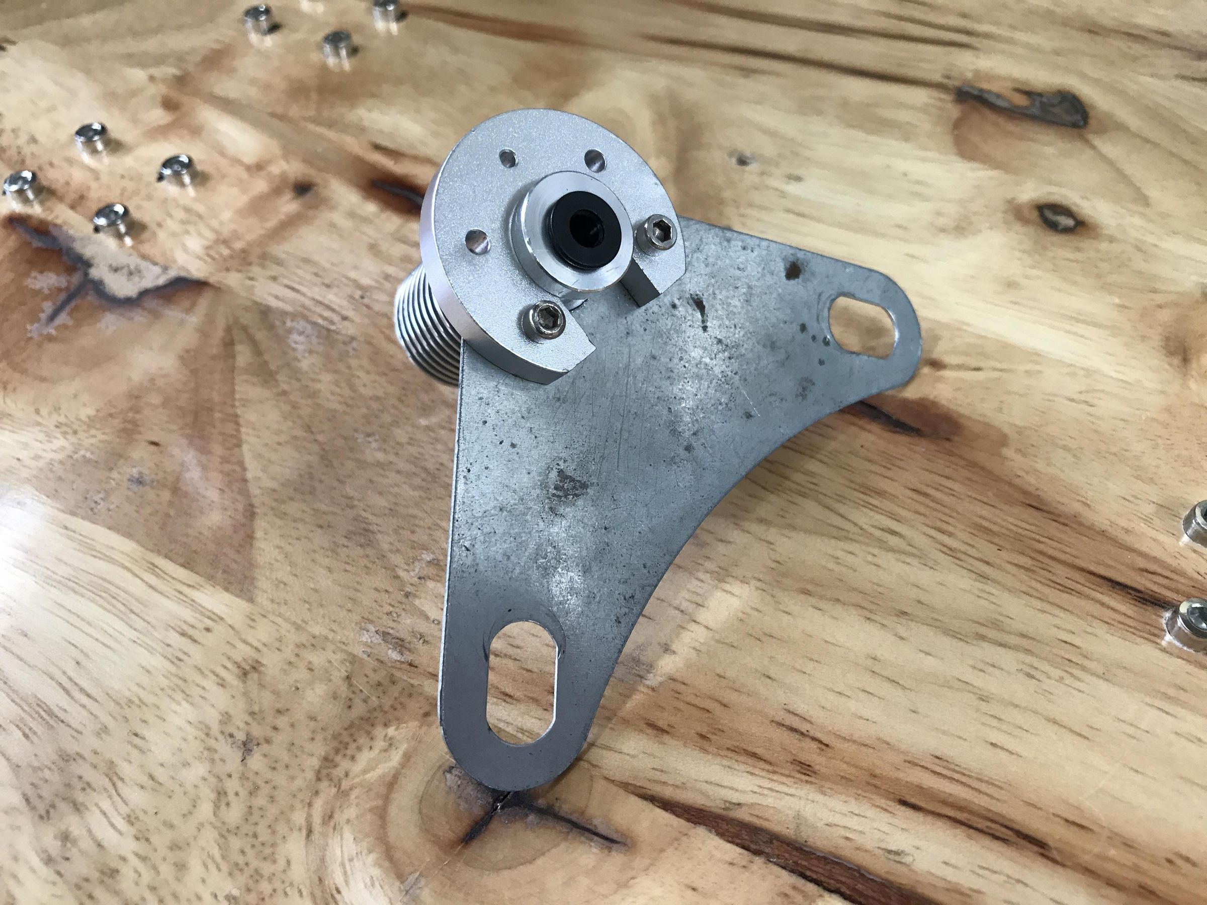

⦾ I originally planned to use a Bowen Print J-head Hot End and it comes equipped with one cooling fan bracket. We can do this way if we don't have 3D printer at home. In the below picture, I made a support to attach this hotend to PVC endcap of X axis.
⦾ But I ended up choosing another hotend that I printed for my Sapphire Plus SP-5 printer that is currently unused. This hotend mounting design and detail information is available at Thingiverse link below:
TwoTrees Sapphire Plus/Pro E3D V6, Dragon Mount "The Mint Mount"
T Shape Joint Plate (Fit 2020 series Aluminum extrusion) was used to connect between hotend printed part and PVC endcap.
⦾ The cables of hotend heater, thermistor, cooling fans were pre-connected.
⦾ During installation, I had to checked and adjusted so that the hotend nozzle tip should be located lower than the pulleys and timing belt.

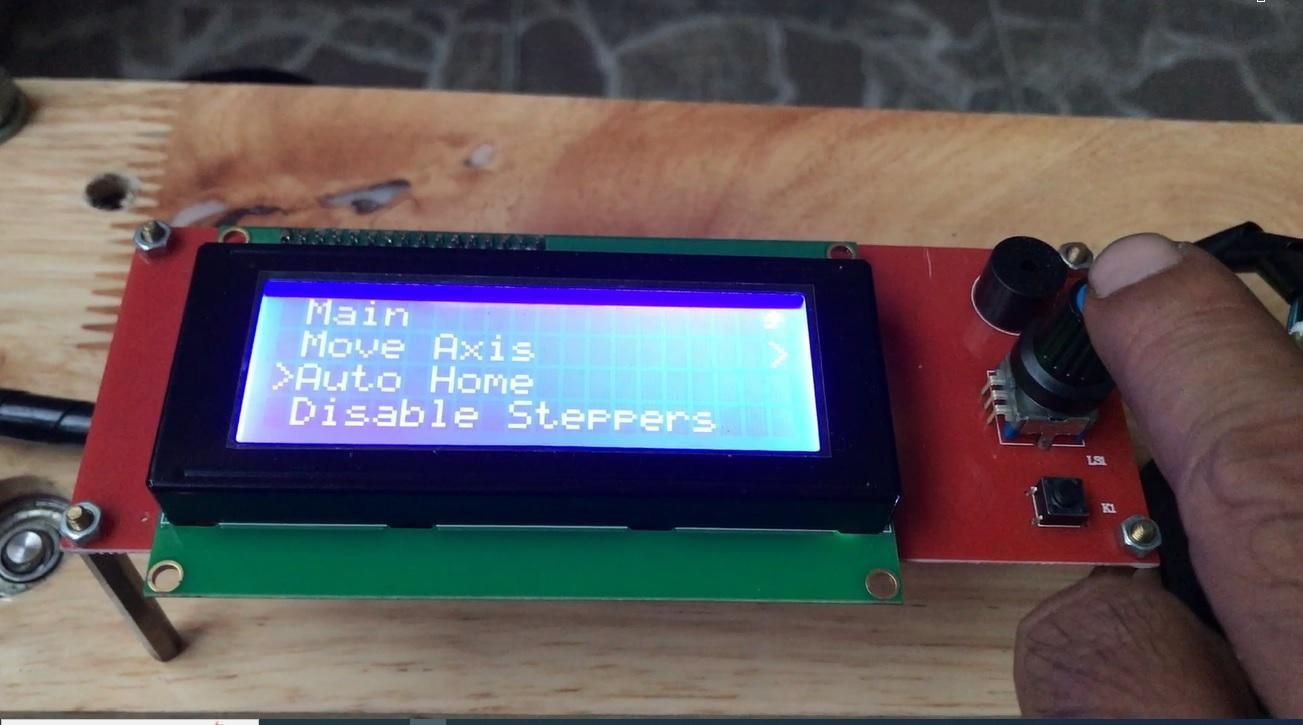

⦾ Extruder stepper motor, LCD 2004 and filament filament spool holder were mounted on the top wood plate. I made this spool holder from PVC pipe fittings Ø42mm and Ø60mm.

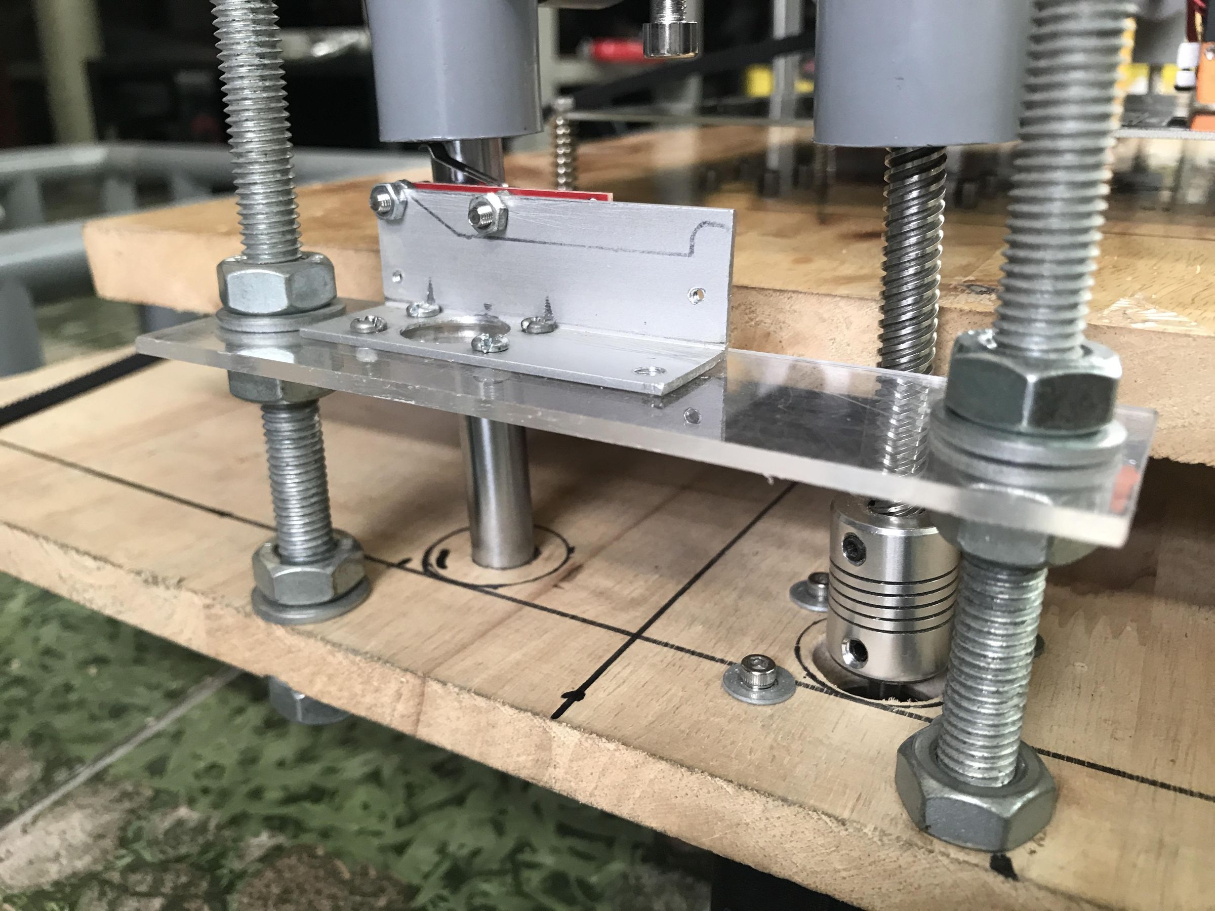

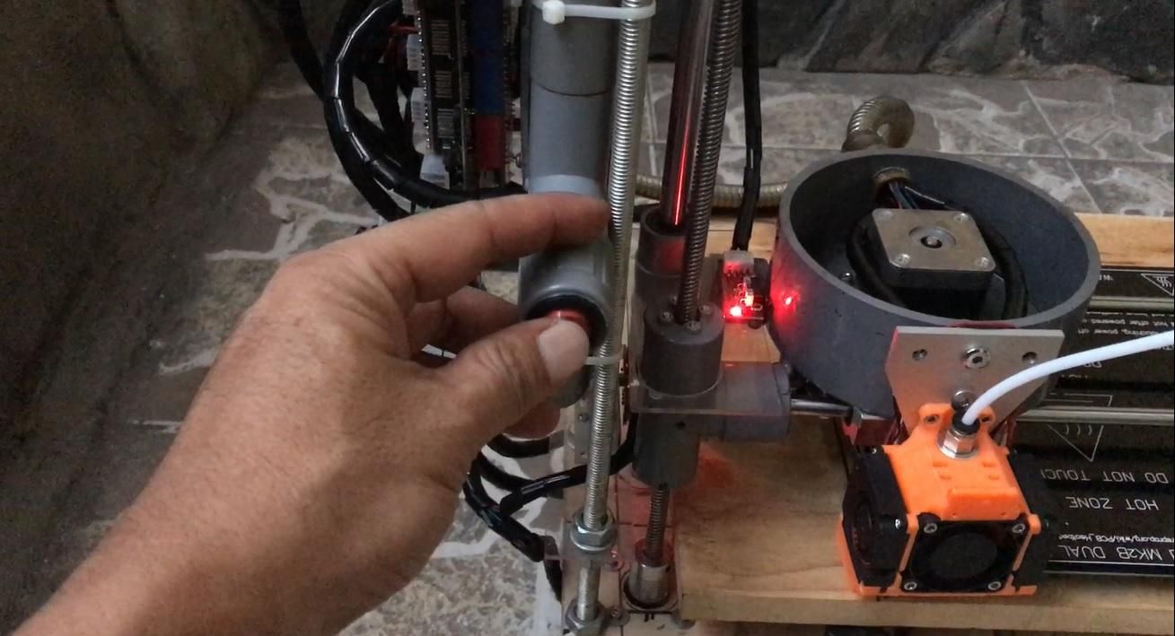

Step 6: Endstops Assembly

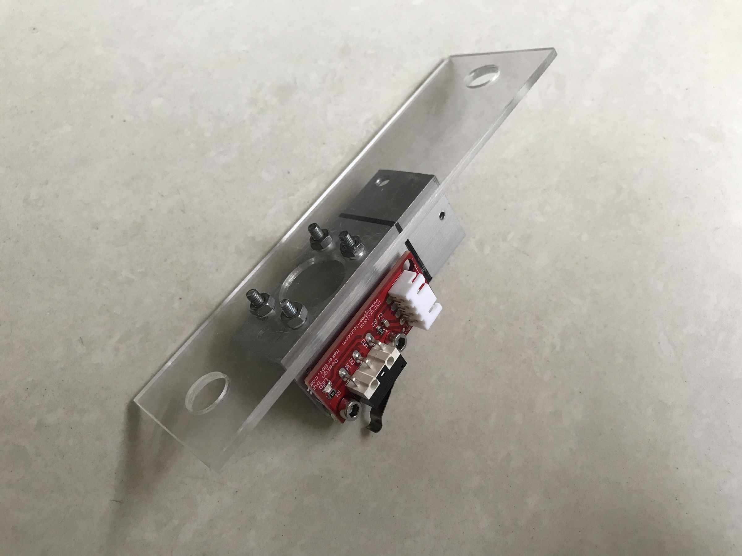

⦾ The X-Endstop was mounted on the acrylic plate and then fitted to XZ left part.
⦾ The Y-Endstop was located at bottom wood plate.
⦾ The Z-Endstop would be adjusted up or down during calibrating & operating so I drilled 2 holes diameter 10mm on the acrylic support for this purpose.
⦾ I mounted the Z-Endstop support to thread rods. Z-Endsop could be easily adjusted up/down or fixed by 4pcs x M10 bolts as shown below.

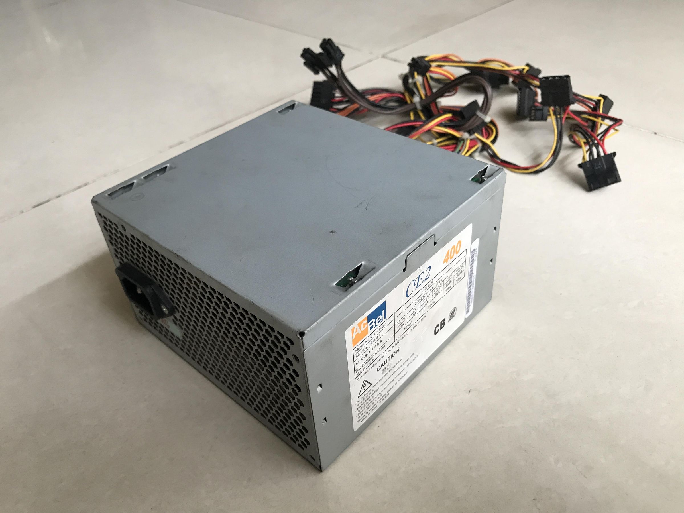

Step 7: PSU Assembly

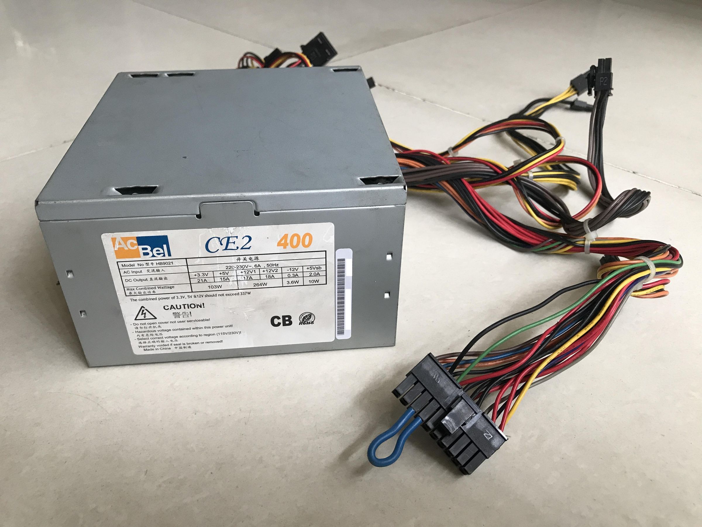

⦾ I had a power supply from my broken desktop, nameplate AcBel CE2 400W. It has dual channel outputs for 12V level voltage. So I had a chance to make it useful.
⦾ Detail information of AcBel CE2 400W is as picture below. The Power Supply Unit (PSU) needs a cable connection to the motherboard to be controlled to turn on/off. When we press the power button on our computer case, it connects the green wire to a ground - black wire, telling the PSU to turn on. To test PSU temporarily, I simply connected green wire to black wire at 20 pin connectors. Later when I put my 3D printer into operation, I would use a button to turn on/off the power.
⦾ I assembled the PVC pipe fittings (including: three and four way PVC tees) into a frame and mounted this PSU inside it. This frame was fitted under the bottom wood plate later.
⦾ I only left two pairs of yellow - black wires (12V power supply to RAMPS 1.6) and green - black wires (to On/Off button). I have tied up the rest of wires neatly.

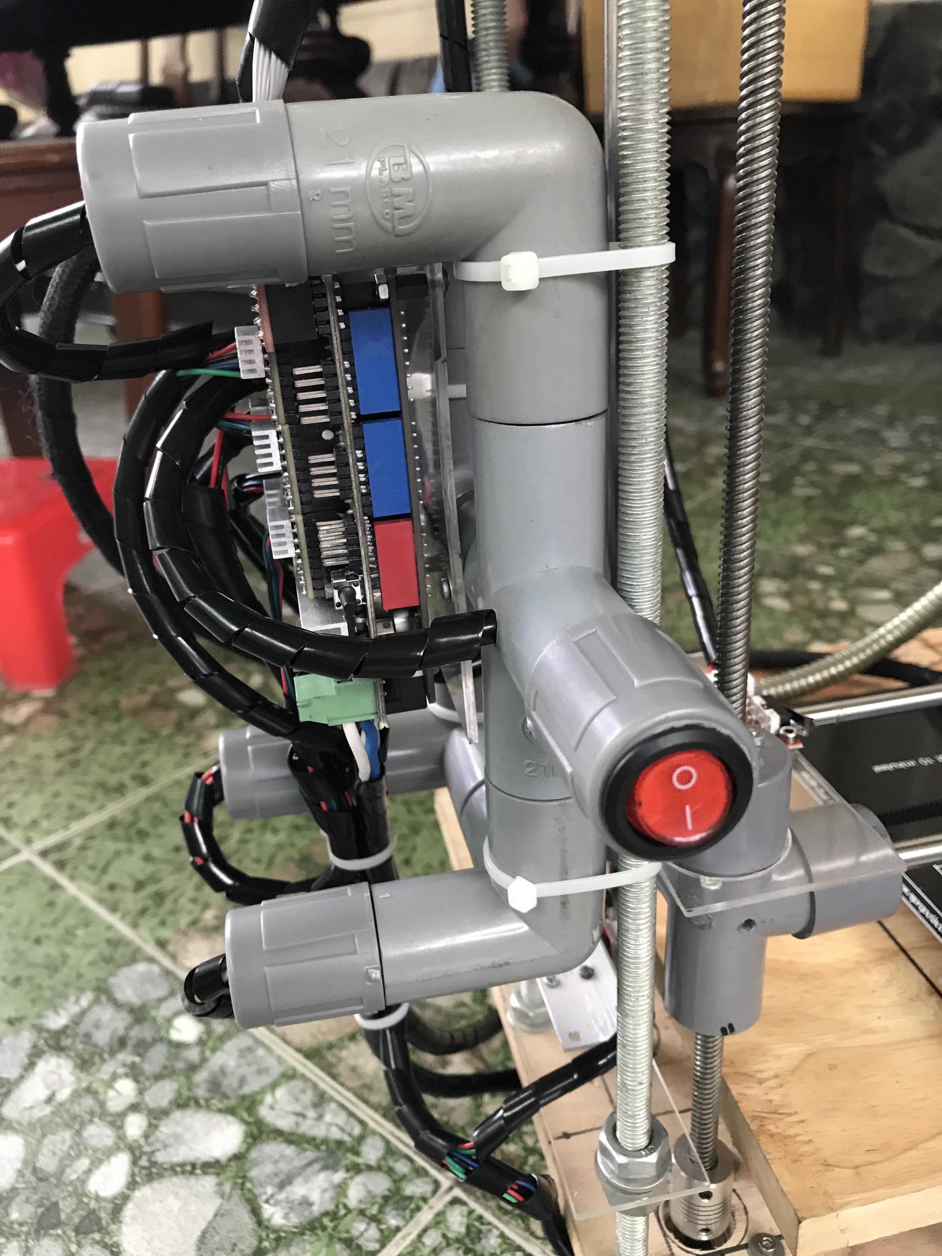

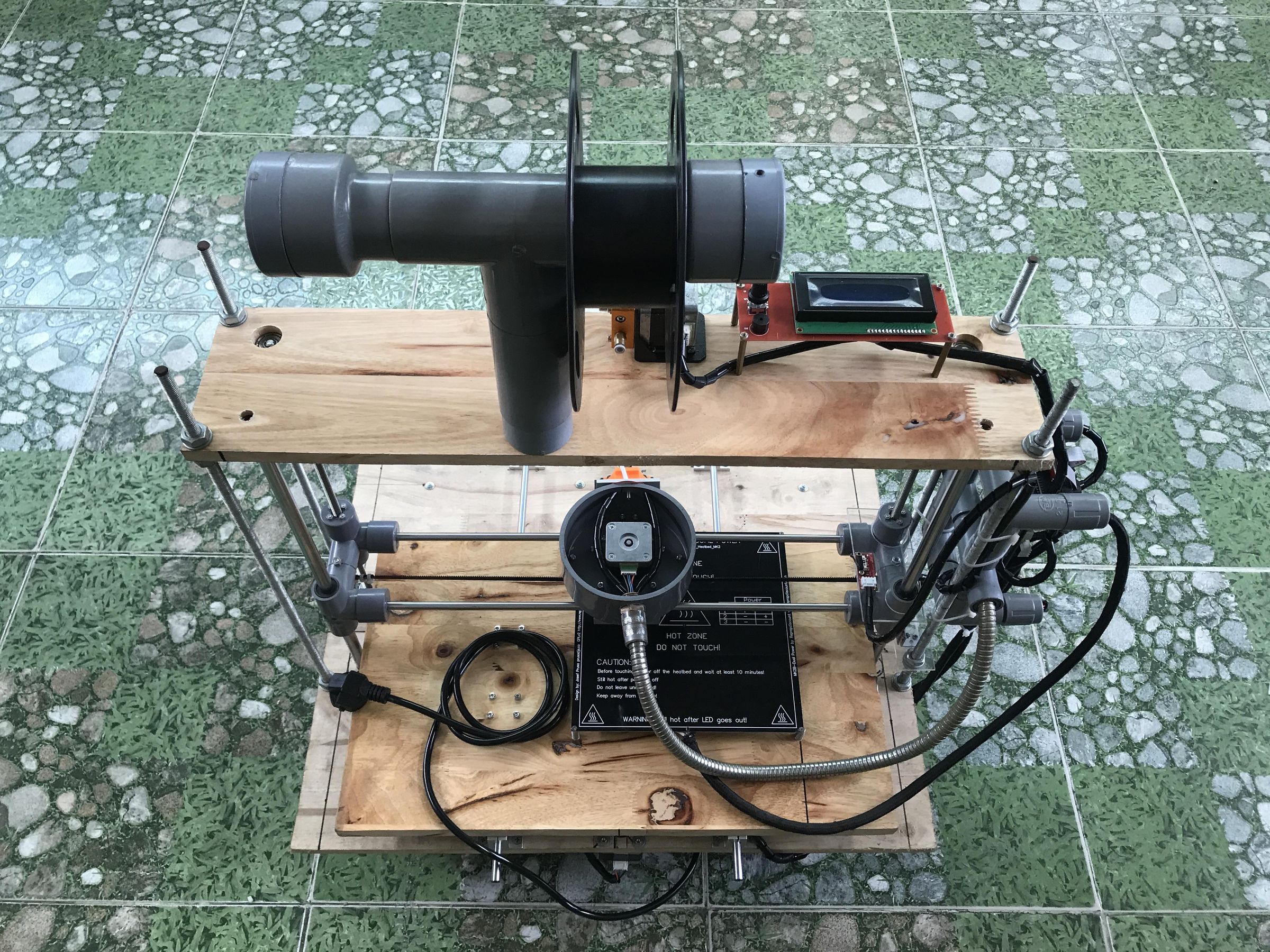

Step 8: Controller and Cabling

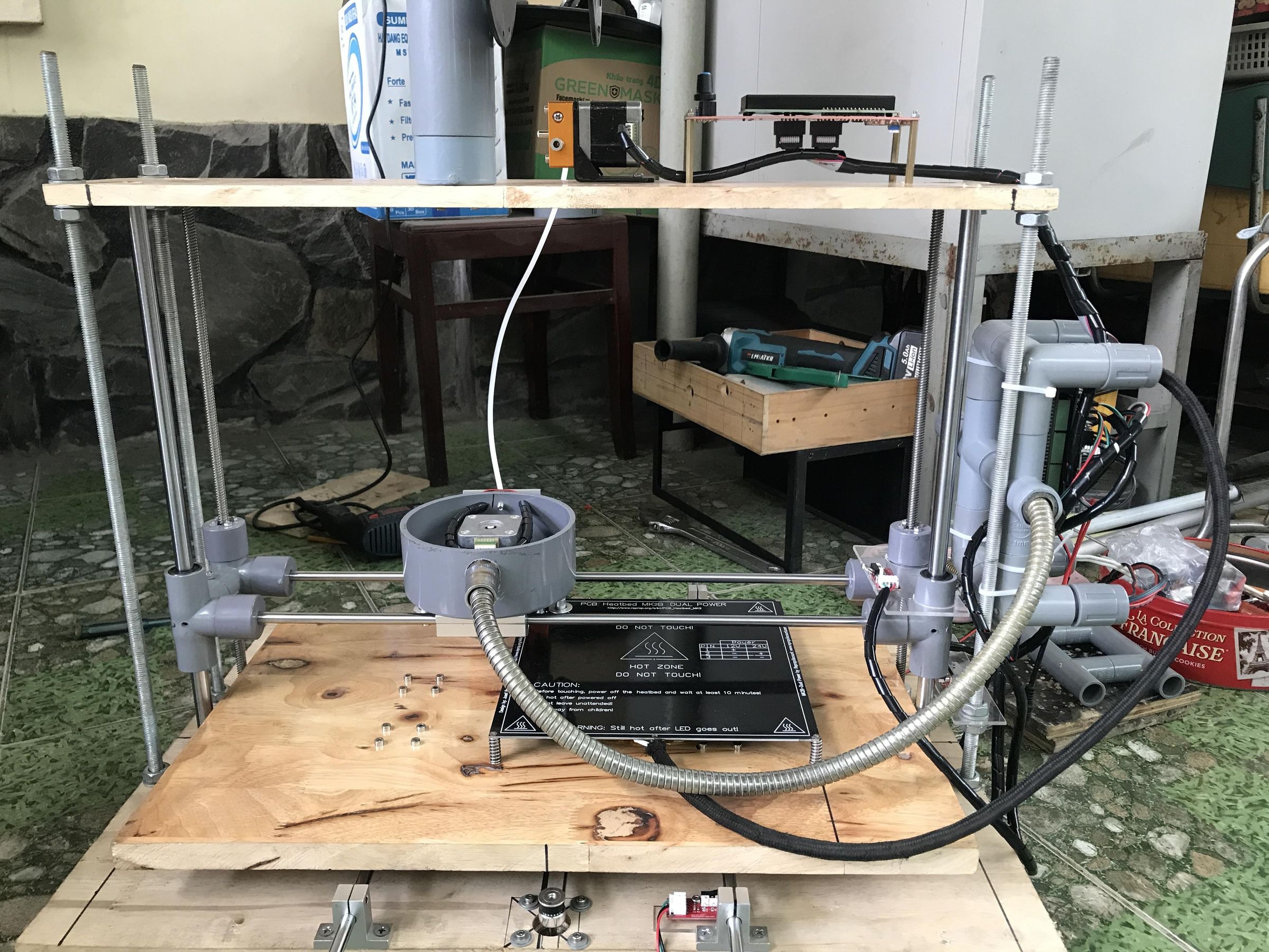

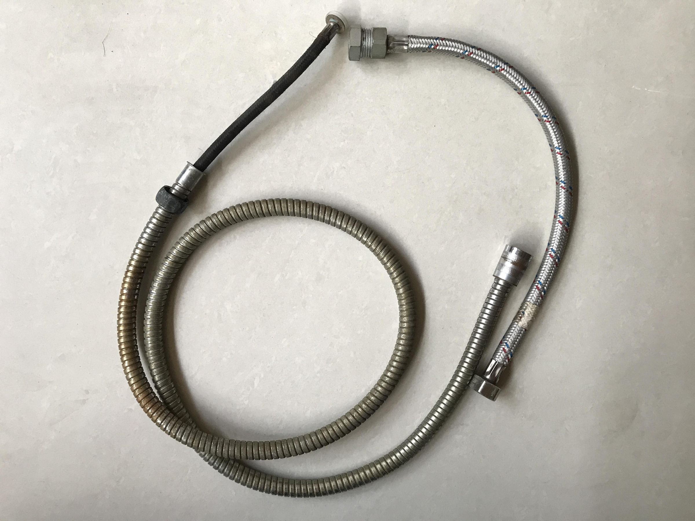

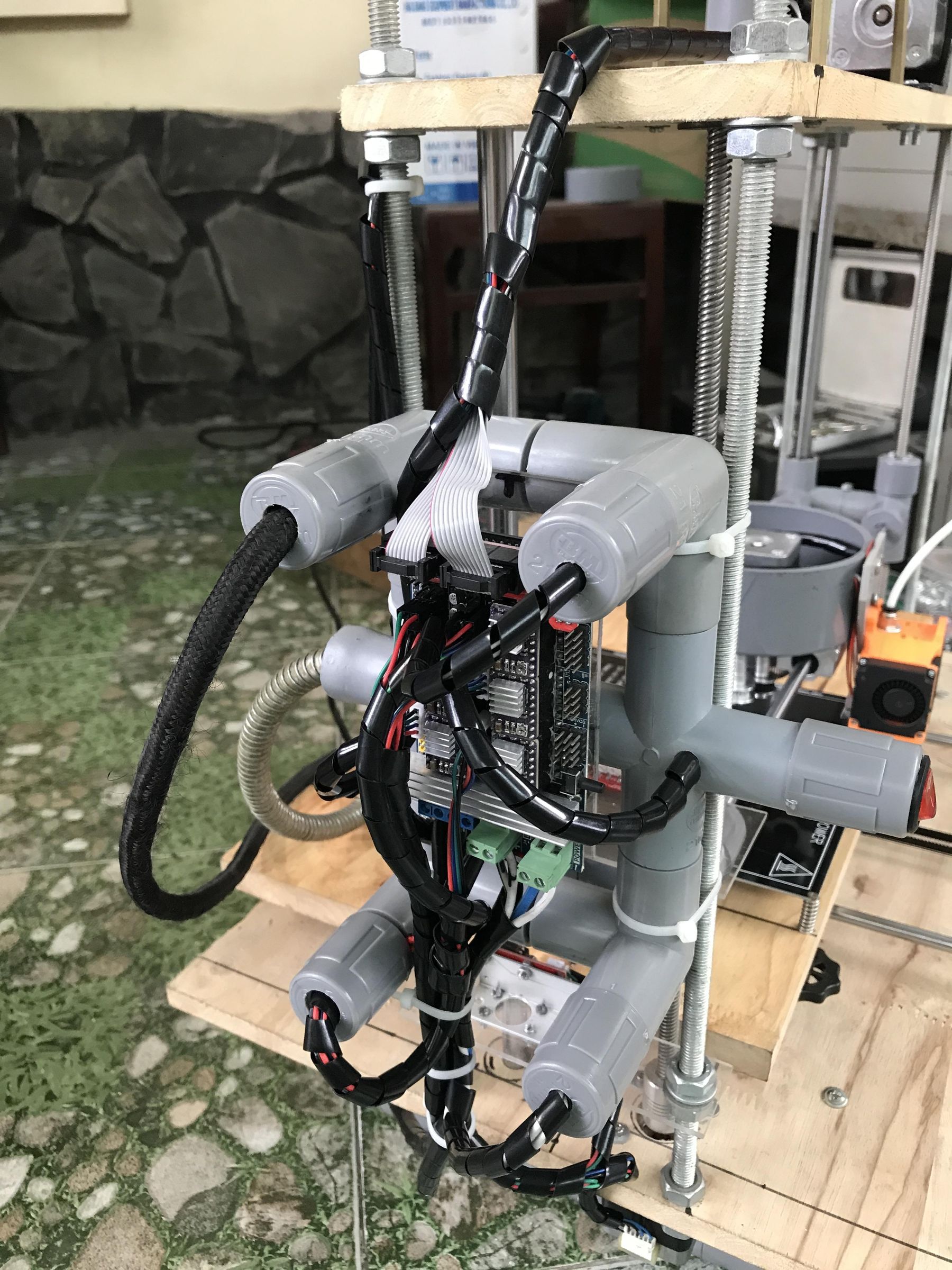

⦾ I reused one broken stainless steel flexible hose pipe in my restroom for heatbed and hotend cable covers.
⦾ A flexible hose has one outer tube made of stainless steel and one inner pipe (black color). I used outer tube for hotend cable cover and inner pipe for heatbed cable cover.
⦾ Arduino Mega 2560 and RAMPS 1.6 were mounted on the support made of PVC fittings. All wires were covered by black cable spiral wraps.
⦾ I've fitted a button to turn the power supply on/off as explained on the previous step.
⦾ I connected a PTFE Teflon tube from extruder stepper motor to the hotend.
⦾ It also looks okay, not mess at all.

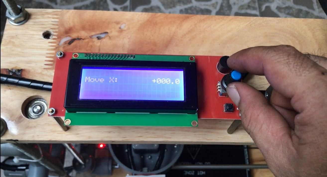

Step 9: Marlin Firmware
Marlin firmware is available at: https://github.com/MarlinFirmware/Marlin/releases
I downloaded & installed Marlin firmware version 2.1.2 to Arduino Mega 2560 by Arduino IDE.
Parameter settings in "Configuration.h" for my 3D Printer is shown as follows:

To calculate the steps per millimeter for my 3D printer axes, I refered to this site:
https://blog.prusa3d.com/calculator_3416
  • For X axis, I used the fixed belt driven systems so X step/mm are: 40 step/mm (Pulley tooth count = 80, Microstepping = 1/32).
  • For Y axis, I used the normal belt driven systems so Y step/mm are: 80 step/mm (Pulley tooth count = 20, Microstepping = 1/16).
  • For Z axis, I use the leadscrew driven system so parameter Z step/mm is: 400 step/mm (microstepping = 1/4).
  • For Extruder, the step/mm is: 142 step/mm after calibration.

#define REPRAP_DISCOUNT_SMART_CONTROLLER

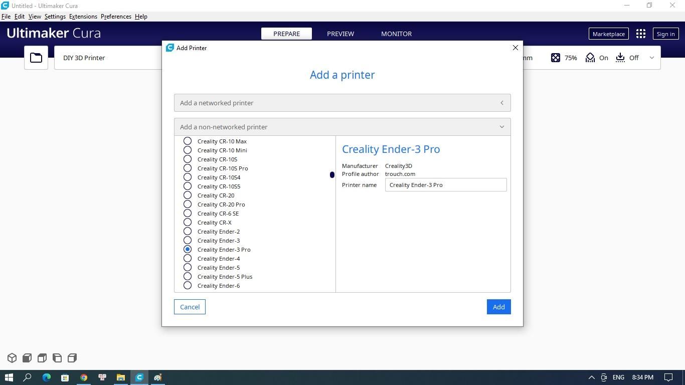

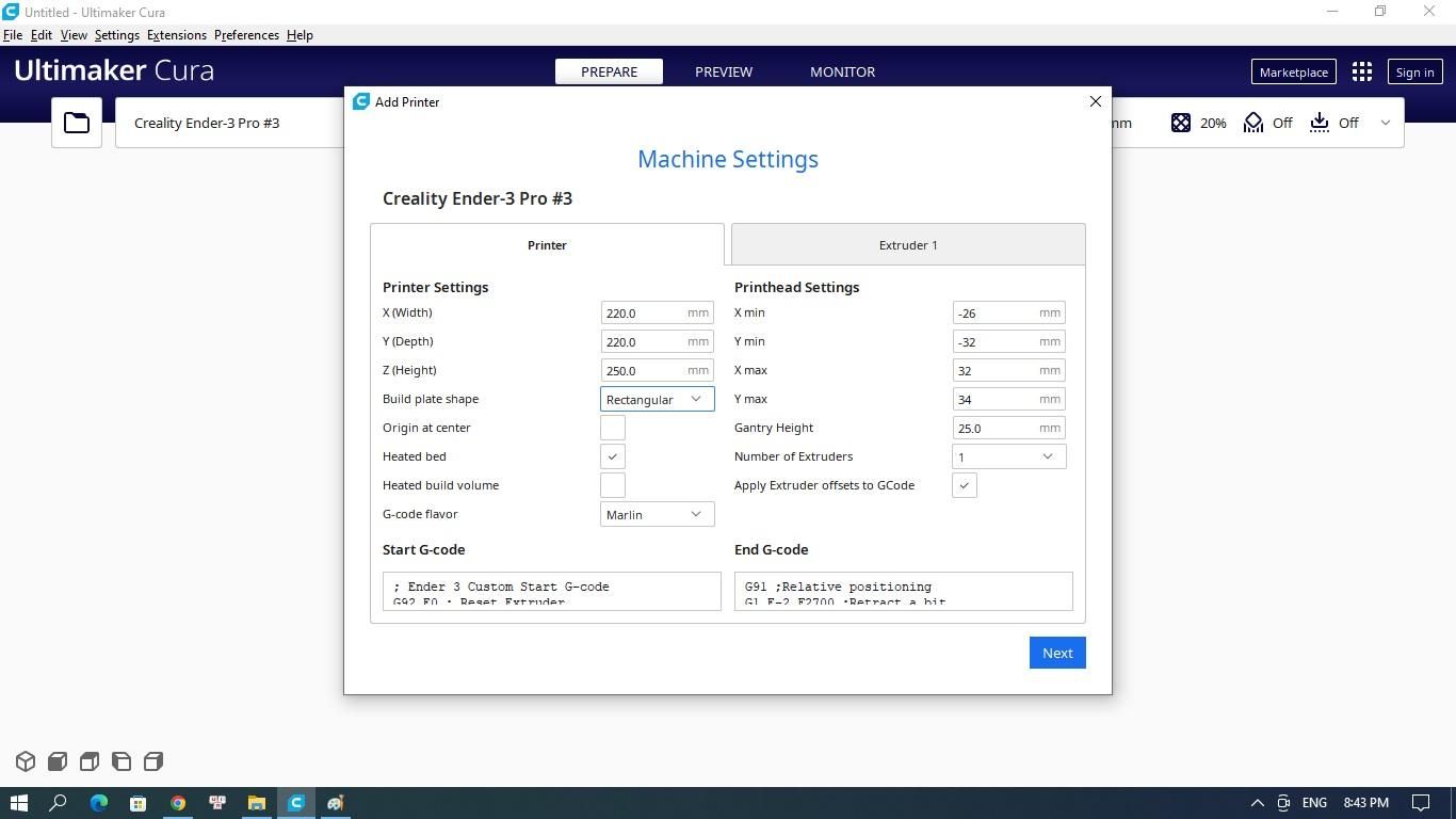

Step 10: Ultimaker Cura Settings
Open Ultimaker Cura ‣ Settings ‣ Printer ‣ Add Printer ‣ Add a none-networked printer ‣ Creality3D ‣ Creality Ender-3 Pro.
Click Add ‣ Window "Machine settings" appears Go to Tab "Printer", it shows some critical set-up parameters for original Ender-3 Pro and I can customize some parameters for my DIY printer.
We pay attention on the codes in "Start G-code" and "End G-code" windows that make my DIY Printer working as same as Ender-3 Pro when it start and end excuting a G-code file.
⦾ Start G-code
; Ender 3 Custom Start G-code
G92 E0 ; Reset Extruder
G28 ; Home all axes
G1 Z2.0 F3000 ; Move Z Axis up little to prevent scratching of Heat Bed
G1 X0.1 Y20 Z0.3 F5000.0 ; Move to start position
G1 X0.1 Y200.0 Z0.3 F1500.0 E15 ; Draw the first line
G1 X0.4 Y200.0 Z0.3 F5000.0 ; Move to side a little
G1 X0.4 Y20 Z0.3 F1500.0 E30 ; Draw the second line
G1 X5 Y20 Z0.3 F5000.0 ; Move over to prevent blob squish
⦾ End G-code
G91 ;Relative positioning
G1 E-2 F2700 ;Retract a bit
G1 E-2 Z0.2 F2400 ;Retract and raise Z
G1 X5 Y5 F3000 ;Wipe out
G1 Z10 ;Raise Z more
G90 ;Absolute positioning
G1 X0 Y{machine_depth} ;Present print
M106 S0 ;Turn-off fan
M104 S0 ;Turn-off hotend
M140 S0 ;Turn-off bed
M84 X Y E ;Disable all steppers but Z
Step 11: Calibration
⦾ After powering on the 3D printer, I moved the X, Y, Z axes in the forward and reverse directions, checking if the movement was correct, and did correction.
⦾ We can refer to the following website to understand how to calibrate step/mm of each axis, as well as, E-Steps:
https://all3dp.com/2/how-to-calibrate-a-3d-printer-simply-explained/
https://help.prusa3d.com/article/extrusion-multiplier-calibration_2257
⦾ After calibrating XYZ axes & levelling heat bed, I set my 3D printer to home position by "Auto Home" function. It can check if the endstops're working properly.
 I can power on or off the power supply by a button mounting on the 3D printer frame.
