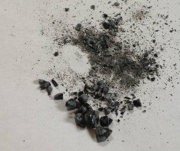

Step 3: Choose Your Stone, Then Crush It.
I wanted a dark stone in my ring. I looked at some very pretty stones, but they did not keep their color very well after they were crushed so i used a black piece of gravel. You can use whatever rock you want, but glassy rocks may become much lighter after they are crushed and inlayed.
To crush the stone you want, wrap it in a an old sock or cloth and hammer away. Don't hammer too much or you will only have powder and no variety in size. Powder is nice to fill in holes. but I like using mostly medium pieces.

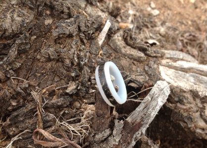

Step 6: Finish Sanding.
This ring is plastic and stone, and so I thought sanding would be a little difficult to do. It went very smoothly though. I just hand sanded it, and it curved the plastic nicely and it just polished and evened out the stone part. I used 220 grit to 1500 grit, and that gave me a really nice shine without a finish.
I couldn't find a natural finish for this ring because everything just rubbed off quickly or evaporated. I did not try a polyurethane, or lacquer finish, but don't really like using those.
Step 7: Admire Your Work.
Now go show it off, you deserve it. Take some pictures. Post it on Facebook. Give it to a loved one. Just enjoy it.
Remember that this is a soft plastic, so if you are sanding on another project or something, then you might want to take it off so you do not ruin it.
