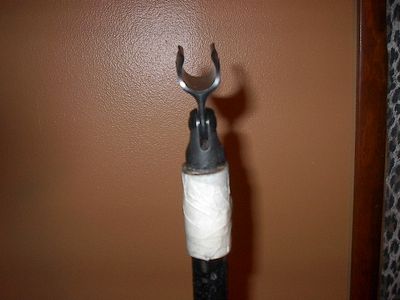

Step 6: Making the PVC Mic Clip
You have 2 options here.
Option 1 Union
Grab you hammer and gently tap the bolt into the union, stop hammering it in when the bolt reaches halfway.
Option 2 T
Grab you hammer and gently tap the bolt into the T. And remember to "Keep checking frequently! To make sure that the mic clip sits tight and firm on the bolt.
What I did
I stuck the T in some vice grips first. And used a saw to cut off the middle thingy. I then took electrical tape and wrapped up the piece 1-3 times so that it wouldn't break when I stuck my bolt in! LOL
(In the picture: I didn't have any electric tape, I ran out. So I used masking tape)
