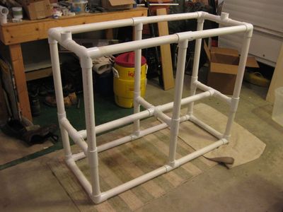

Step 2: Constructing the PVC Base:
So, there's a lot of pieces of PVC here...

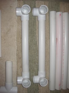

Cut the 1-1/2" Pipe into the following sections:
  Quantity  Length (inches)  Length (centimeters)  16  22 Inches  56 cm  6  12 Inches  15 cm  2  16 Inches  40.5 cm  10  7 Inches  25.5 cm
Once you get these all cut, and it is good to note that keeping them all the same length is critical to the construction, this is why I chose to use the miter saw, as I was able to cut two at a time, and after your finished, you can use all the shavings from the saw to make artificial snow.
Optional:  Now that you have everything cut, if you want to remove all the labels for a cleaner look, I recommend a rag and some acetone, takes the black, blue or pink lettering off the pipe pretty quickly (including any barcode labels from the hardware store).
First order of business is connecting the end pieces at this point leave the pvc glue in the can and just get familiar with the general assembly:

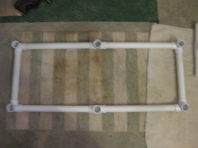

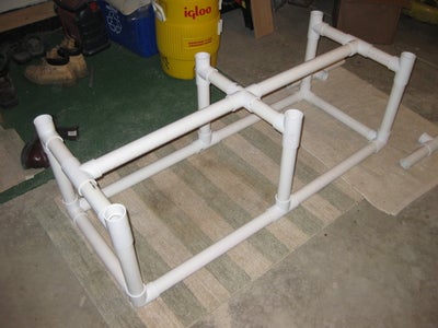

1.  Assemble the sides & Center support (Image #2):
Take the all the 7" pieces and connect two of them together using 4 of the 1-1/2" Tee fittings and 1 of the 1-1/2" Cross.  This will give you the four side pieces (2 for the top, and 2 for the shelf) as well as center cross that is used for the shelf support.

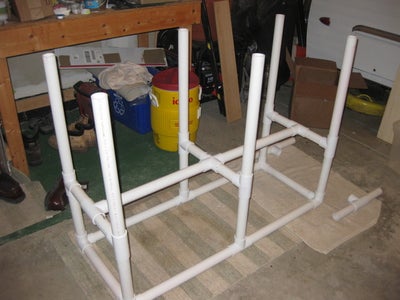

2.  Assemble the bottom side pieces (Image #3):
Using 4 of the 1-1/2" Side Elbows, take the 16" pipe and put one elbow on each ends of the pipe.   These will be used to create the bottom sides pieces.
3.  Assemble the Base (Image #4):
To make things easier, the 22" pieces are used for both the cross members and the top uprights.  I picked this size to not only keep them constant and less pieces to figure out where to put them, but also the 22" height above the shelf allows for a 5gal igloo cooler to sit on the shelf under the bar.   So using the additional Tees  construct the base of the bar using the bottom side pieces created in step #2 and 4 of the 22" pieces (see fourth image)  Make sure the Tees in the middle are facing upwards along with the side elbows.
4.  Going Up (Image #5):
Now that you got the base, use the 6 shorter 12" pieces and insert them in all the base holes facing upward, this allows for the shelf to be in the lower position, (OPTIONAL: if you want the shelf to be higher, start with the 22" pieces it works either way).

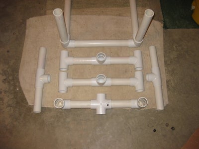

5.  Creating the Shelf Support (Image #6 & #7):
So because your liquor or favorite beverages will probably be heavy, I create cross members to support the wooden shelf to sustain the weight.  Using two of the side supports and the center support created in step #1, put Tee's on the ends of each of these (total of 6) as shown in the image.   Once these are assembled put these on the assembled base structure with the Cross fitting in the middle.  Connect the ends to the middle using 2 of the 22" PVC pieces.

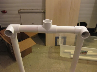

6.  Getting to the top (Image #8, #9 & #10):
Using 6 of the remaining 22" pieces insert them into the upright holes.  Take the remaining 4 side elbows and put one on each corner and the 2 remaining Tee's on the center uprights facing the corners.   Connect all these fitting using the four remaining 22" pieces and the remaining two end pieces created in step #1.  The top middle end Tees should be facing up (these will be used later for the canopy supports).   Push and squeeze all the fittings tight and this completes the PVC base!

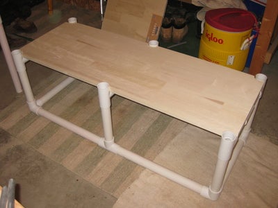

Step 3: Bar Top and Shelf
Now that you've got your PVC Base completed it's time for the bar top and shelf.   I used aspen wood from my local lowes, but you can opt for more expensive or cheaper (plywood) depending on taste.  For those that want to get really fancy I'd recommend routering the edges, but I just use a sander to dull the sharp corners.
1.  The Top:
Pretty simple actually, cut the first piece of wood 60" x 24" wide,  OPTIONAL: using a compass and a jigsaw I curved the corners on a 4" radius.  You need to create the holes for the supports to go through, to do this you can use a 2-3/4" hole saw and drill motor or using a compass and jig saw to cut the holes out.   I measured in 5-3/4" from each end and 10-1/2" from the back to mark the center of the holes (Caution:  I recommend that you measure the distance between your Tees on your PVC base twice to check to make sure the holes align correctly).  I didn't center the holes front to back as to allow a front over-hang for the bar and making the counter flush with the PVC on the backside.
2. The Shelf:
Cut the second piece of wood 18" x 51" long.  using the bottom portion of the base with the 12" pieces inserted put this on the board and trace out the template on the board to cut out the notches to accommodate the PVC uprights (see image #2)  Note:  Be sure your PVC is assembled tightly to ensure accurate measurements.  Use the jig saw to remove the pieces you trace out and the shelf should easily fit on the top of the bottom portion of the base when completed (see image #3).

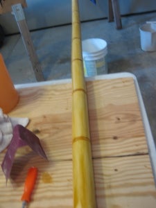

Key notes on making Faux Bamboo:
1.  Make sure you use Acetone as instructed to remove all the labels prior to scoring your PVC (I learned the hard way that if you burn the PVC with the lettering on, it doesn't come off with Acetone afterwards).
2. I recommend you give it all a good sanding prior to using the faux bamboo technique (easier to do before the bumps are created and you don't loose the burn marks)
3.  Don't cut the PVC until after you've made it look like Bamboo.  The process involves compressing the pipe to get a natural look, and if you cut it first, it won't be the same length when your done.
4.  SPAR Urethane, once you've finished shellac'ing the bamboo, I used SPAR Urethane in a spray-can to seal the shellac, it also hardened it a lot so that if you hit the pipe it doesn't chip as easily.
Ok, now that you've created faux bamboo, cut two pieces 38" in length.  If you want to get creative, I recommend that you also use the technique to at least shellac the two middle top Tee's in the base (as they stick up from your bar countertop).
If the faux bamboo pipe doesn't fit into the Tee now (because of the shellac) this can be easily re mediated by cutting slit across the end of the pipe using a hacksaw about 1/2" deep.

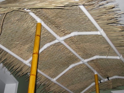

2. Flat Roof Top:
Now for something a bit less complex; in the two Tees on the ends of your centerline and your two center cross fittings, insert all of your remaining (qty 8) 6" pieces in these 8 holes, this will create a level flat top down the center of your canopy.
Once you have all of those end, put a 22.5 Degree elbow pointing down on the end of each of the 6" pieces (qty 8).
3.  Angled Roof portion:
Now to create the sloped roof supports, in the ends of each of the 22.5 Degree elbows, insert a 10" Piece in each of these pointing downward, this will create the slope for the thatch to rest on.

5.  Final Assembly:
Now that you got the centerline and the two outside edges align the Tees and elbows and attach the outside edges to the centerline.  Place your faux bamboo pieces (Urethane dried) into the lower base, and then place the two downward facing 6" PVC pieces from your canopy into your faux bamboo.
6.  Optional:
If you are making the tiki bar for a more permanent use, I'd recommend going ahead and gluing and staining the upper canopy supports using the stain that was used on the canopy supports for a more natural look.  I have not done this yet, as I'm making mine for mobile use,and didn't want to have to worry about taping off all the ends that insert into the PVC fittings ensuring that they still fit after staining.

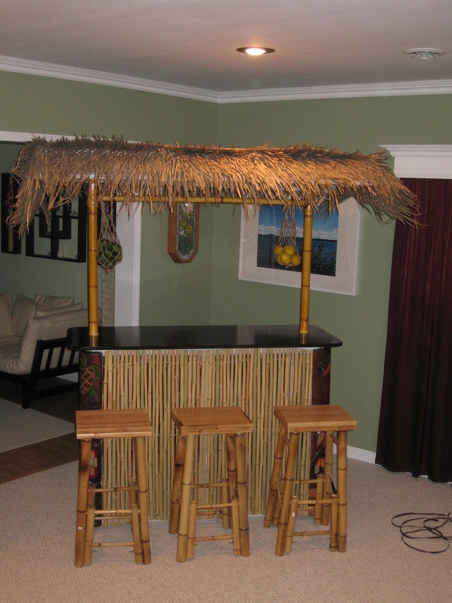

Step 6: Finalize & Accessorize
Finalize:
So by now you should have made the decision how "portable" you need your bar to be.  Using the PVC glue, you can attach those pieces and fittings that you desire, if your not going to be moving it frequently, I recommend gluing all the fittings together for strength and stability.  Because I tend to move mine often, I elected to attach all the fittings to the smallest fitting they connect to.  This allows me to break it down and throw it in a bin to take camping..
Accessorize:
Now you got the structure, it's time for the really fun part... Adding the accessories...  This is where you bring in those remaining parts.
2 - 30" x 7'  Thatch
1 -  4' x 8'  Bamboo Fence (I recommend 3/4" fencing, but smaller size illustrated below)
2 - Tiki's of your liking
Velcro Cable Ties
1. Thatch:
Starting with the canopy and illustrated in the previous step, use velcro to attach the Thatch to the canopy structure,  I overlapped the two pieces by about 6" and let them hang over about 10" on each end.   I found that if you find the velco cable ties (found in the electrical section of Lowes or Home Depot) they make it easy to strap them down to the PVC.  This is obviously easier to do with the canopy on the ground and then lift the completed assembly into the faux bamboo.
2.  Bamboo Fence:
So you'll need to cut the 48" of the bamboo fence down to approximately 39",  this is done easily with a pair of scissors or hacksaw if you get thicker bamboo.  Using Velcro or zip ties (if permanent) attach it under the bar going around the PVC pipe on the ends leaving the back open (you may have trim the 8' length as well).
3.  Tiki Gods:
I attached velcro strips to the back of the Tiki masks at the top and bottom using a little glue and staple gun,  then ran the velcro through the bamboo fence and around the PVC pole to hold them tightly to the bar.  I picked these two up a http://www.things2die4.com  as they have several that are 39 inches in height and fit perfectly.
4.  Bar Stools:
As much as I would like to say that I built the bamboo bar stools, I found it  much easier to order these and assemble them using the manufacturing instructions :)   I got mine from Home Depot Online (came in a set of two) for about $25/each.
I did end up adding a bar to the top of the canopy in faux bamboo later on, I use this hang patio lights on, an easy option to add using two additional PVC Tee's and a little more PVC pipe.  Found some old netting and fake lemons and limes to add a few extra touches.
That's it!   Oh wait? Don't forget to stock the bar with your favorite beverages!.  Enjoy!
