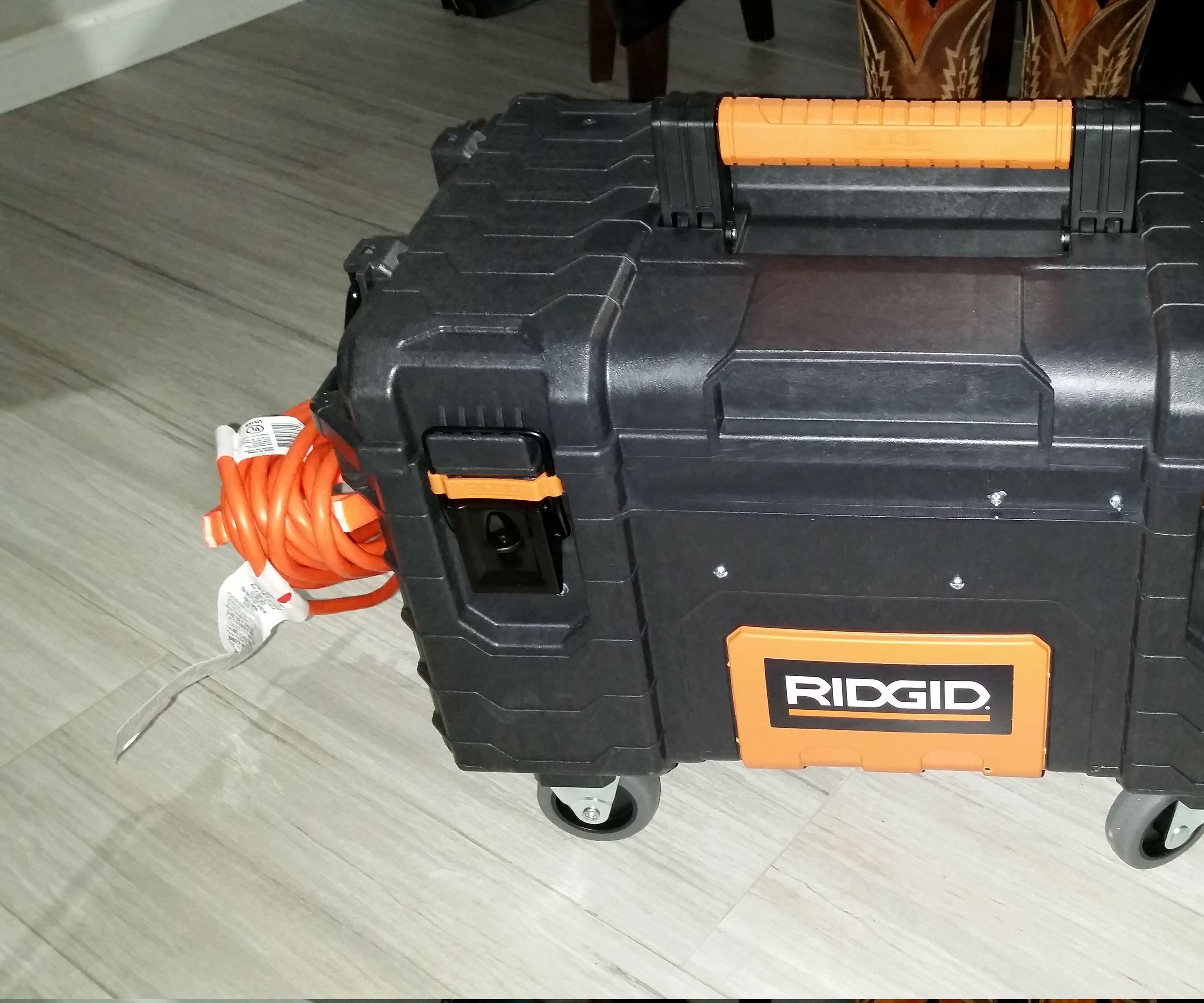

My design also features 2 full toolboxes bolted onto the back, of the same modular type as my other toolboxes (As can be seen in my first Instructable, the Rigid Powerbox). This modular stacking ability allows me to simply lock my work toolbox onto the rack and go, taking advantage of the secure mounting bracket.
