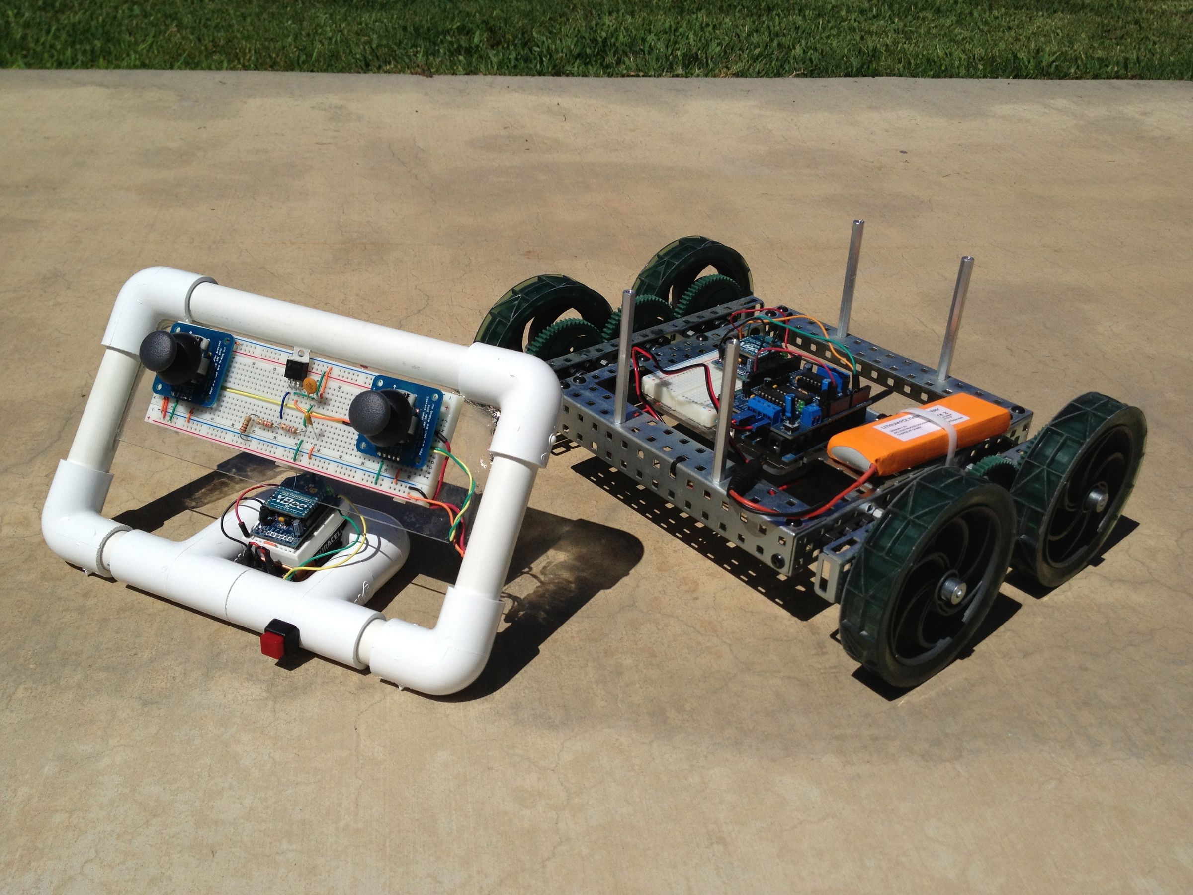

I've used PVC in other projects including an Xbee remote control and I am impressed with its versatility, cost effectiveness and relative ease of prototyping quickly. The vision for the present project took over six months to really take shape in my mind before I began to prototype. In robotics the tank drive is used frequently for small scale drive systems so with the not-so powerful 24V motors on hand could we build a transport to carry 200lbs on a PVC frame?
