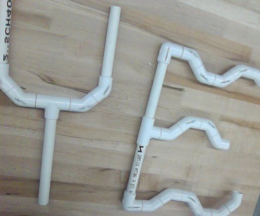

Step 3: Build 2 of the Middle Sections
Attach 2 of the 7" sections with wideners to the two 3/4" tees. Connect the tees with a 1 1/2" piece of 3/4" PVC. Build 2 of these.
Step 4: Construct the Base
Connect two 5' Sections each to a 1" connector. on each of the ends, add a 3-way elbow. Insert a 2" piece of 1" PVC into the vertical outlet of each 3-way elbow and add a 45º elbow to the ends of the 2" pieces. Connect a middle section assembled in the previous step to the front 3-way elbows and the middle 4-way tees.
Step 5: Assemble the Arm Supports
Attach one of the 6" sections with a cap to the edge of a 1" 4-way tee. Connect a 3/4" tee to the bottom of the 6" piece. Attach 2 45º elbows to the sides of the 1" 4-way tee with two 2" pieces of 1" PVC.
Step 6: Assemble the Arm Supports (2)
Attach a 6" piece of PVC with widener to a 90º elbow. Drill holes in the elbows for the trebuchet arm. Attach a 1 1/2" piece of PVC to the elbow and connect a 45º elbow to that. Attach a 6" piece of PVC to the 45º elbow and add another 45º elbow to that. Add a 1 1/2" piece of PVC to that.
Step 7: Assemble the Arm Supports (3)
Join the sections created in steps 5 and 6 together
Step 8: Add the Diagonal Supports
Connect the 6' 9" sections to the 45º elbows on the base.
Step 9: Add the Vertical Supports
Connect the 4' 4 1/2" to the 2 center 4-way tees. Add the arm supports to each side.
