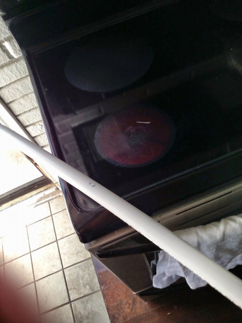

Soften them up with your heat gun (or in this case, an electric stovetop) but avoid burning them. PVC that has been burned becomes very brittle and could potentially lead to injury when stress is put on it.
Once you have all the bend points softened and bent, you will have two 8" x 26" PVC rectangles which can be finished with a coupler.
