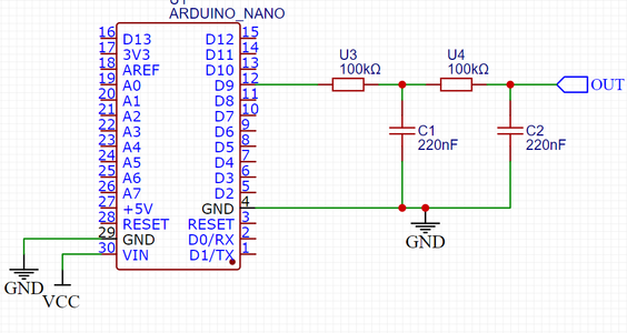

But you can see the signal is not continues, it's not a analog signal. But we need a continuous time signal out of PWM. To achieve this we can either connect a capacitor across the output, or I would recommend to add a 2nd order low pass filter to PWM output. Low pass filter or capacitor acts as an averaging circuit, takes the average of the PWM hence give a smooth analog signal in output.

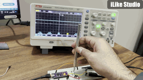

Here is the Sine Wave I got from the above signal. And as I am using 50 samples, the frequency of the signal will be very low because of high computation samples and delay. The code can be optimized for high frequency by minimizing the delay function. The output can be seen on the Digital pin number 9 of the Arduino.

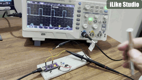

The charging and discharging time of capacitor is very crucial in LPF, I designed this circuit keeping all the considerations. Please use the same values for the best output.
Let me show how with the change in duty cycle the average value of signal is changing. I will give the whole idea of converting a Digital signal into analog with PWM function of Arduino.
Let me feed a 2.5 volt signal into Arduino ADC which is interpreted as 512 by it's 10 bit ADC (Formula: (2.5/5)*1023). And in Arduino I am using 8 bit mode, hence mapping function is used to map 0-1023 value to 0-255. Now the PWM will output a square wave signal but with 50% duty cycle and when given to a LPF we get 2.5v value back. Get all the required code and schematics material from my Github repository.
Step 10: Generation of an Arbitrary DC Signal:
Here is the second example of converting the PWM into stable DC voltage, the same circuit is used in addition this time the value is not given through array. The value is feed into the Arduino externally using potentiometer through ADC pin. Now ADC interpret the position of potentiometer on a scale of 0-1023 and convert that signal into the respective PWM. As the potentiometer is rotated the PWM values will change. When given to a Low pass filter it will convert the signal into Stable analog signal.
