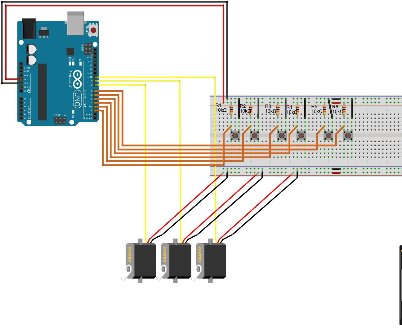

Step 2: Install the LED and Push Buttons on the Breadboard
Orientate the breadboard so the red line is at the bottom.
Push the LED legs into the breadboard taking care to make sure that the negative leg, the ground, is on the left.
Take a pair of thin nosed pliers and straighten the bend in the legs of the buttons, then use a flat surface to get them aligned correctly, with pin 4 and 2 towards the bottom side of the bread board (pin 4 on the left side) gently push the buttons into the breadboard.
Step 3: Ground the LED and Buttons
Orientate the LED so the long leg is on the right hand side
Connect the ground leg of the led to the negative power rail using a 330
Step 4: Insert the Two 4.7k Ohm Resistors Into the Breadboard
Take a 4.7k resistor and push one leg into the positive rail (coloured red) and push the other end of the resistor into the same line as leg 4 of the button (the left leg of the button), repeat this for the other button)
Step 5: Connect the Positive Leg of the LED to the Raspberry PI
Take a male/female cable, push the male end into the same line as the positive leg of the LED.
The female end of the cable will attach to a pin on the Raspberry Pi. Take a look at the GPIO pin out diagram, find the GPIO18 pin (physical pin 12) and connect the cable firmly.
Step 6: Now We Connect the Buttons to the Raspberry Pi
Take a male/female cable and attach the male end to the same line as pin 4 on the button., just above the resistor. Take the female end, and again consult the GPIO pin out diagram. You are looking for GPIO25 (physical pin 22) Connect the cable to this pin.
Now connect another male/female cable to the same line as pin 4 on the second button, and connect the female end of this cable to GPIO9 (physical pin 21) on the Raspberry Pi
Step 7: Adding 5v Power and the Raspberry Pi's Ground to Our Breadboard Circuit
Before applying power to the breadboard, check all your connections carefully or your components and Raspberry Pi could get damaged.
Take a male/female cable and attach the female end to the ground pin located at pin 6 (GND) on the Raspberry Pi. The male end of the cable should be plugged into the ground rail on the breadboard, the blue line at the bottom of the breadboard.
Take another male/female cable and connect the female end to pin two (5v) on the Raspberry Pi, the male end plugs into the red line at the bottom of the breadboard.
The last thing top do is to connect the power rails across the breadboard so that the power and ground rails extend fully across the breadboard. Take a look at the diagram for the small red and black cables at the bottom middle of the breadboard.
Once that's done and you have checked everything carefully once more, power up the Raspberry Pi. Assuming there are no explosions or fires you have finished the physical setup and are ready to get programming with ScratchGPIO!
