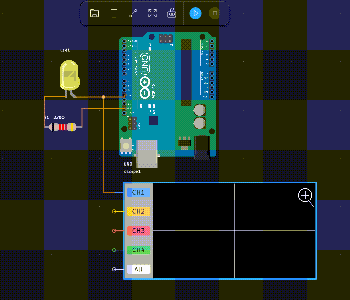

Step 2: Setup in PCBX
Access PCBX: Open PCBX in your web browser. You may need to create an account if you don’t have one.
Create a New Project: Join the EDA&Simulation Community, click on "Create New Project" and give your project a descriptive name, such as “PWM LED Brightness Control.”
Or just use the example project to recreate a new one.
The PWM Signal project code and details are here.
int pwmPin = 11;
void setup() {
pinMode(pwmPin, OUTPUT);
void loop() {
for (int i = 0; i <= 255; i++) {
analogWrite(pwmPin, i); // PWM signal
delay(5);
for (int i = 255; i >= 0; i--) {
delay(5);
Step 3: Testing and Results
While running your simulation, observe the intensity of the LED. Note how it smoothly transitions from off to full brightness and back. If it doesn’t behave as expected, double-check your connections and the code for any errors.
Step 4: Conclusion
You have successfully simulated a PWM LED brightness control project using the PCBX online simulator. This project demonstrates how PWM can be used to control the brightness of an LED effectively. You can experiment further by modifying the delays in the code or changing the resistance to see how it affects the brightness level.
