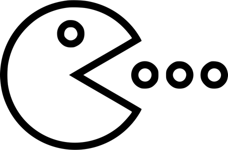

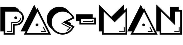

The Pac-Man logo was first engraved using the laser cutter in two places, on the upper back wood piece of the machine and on the front center piece just below the buttons. Unique colors of acrylic were used for each different symbol and cut into circles, with Pac-man being the largest in the center. All images used to engrave are attached.
