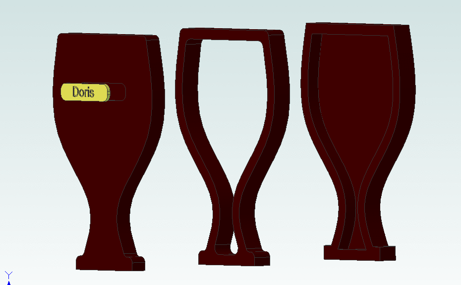

The jewelry boxes are constructed from 3/4" thick poplar boards so multiple levels are required to create an internal cavity of sufficient volume to hold jewelry. The base and the core are glued together to create the box and the lid encloses and protects the contents. The following animation shows the 3 key parts of the assembly - the base, the core and the lid. The base and the lid are hollowed out using a pocketing operation on a DIY CNC router, which is a lot quicker and more accurate than a hammer and chisel. However, if hammer and chisel are all that you have, then working with care will result in the same outcome.

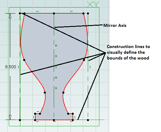

To create a model, first draw the outline of the object (called "sketching" in most 3D CAD programs), then extrude it to the require thickness. In my case, the outline is that of a wine glass sketched using splines to give the smooth shape. To ensure symmetry of the design, it is better to sketch the left half, and then use the "mirror" feature to mirror the sketch to the right side.
Once the first sketch is complete, this gets extruded to 5/8" thick.
The next step is to create a pocket in the lid to increase the internal cavity space of the final jewelry box. Draw another sketch at a 0.375" offset from the edges and use the "extruded Cut" tool to remove material to a depth of 3/8". This leaves a remaining lid thickness of 0.25" which is plenty.
The next step is to create the ridge that fits the lid to the box and prevents the lid from sliding. This is done by creating a set of lines and then extruding them 1/8" from the surface which brings the top surface of the ridge to 0.75" which is the the thickness of the polar board.
The pocket for the nameplate is cut into the front side of the lid. The sketch is cut into the lid 1/8" to match the thickness of the brass stock.
The final step is to filet the edges to match the radius of the cutting tool. This ensures that inside and outside corners match properly on the final jewelry box. I forgot this on the one I made.... so had to make adjustments with a file and chisel. For the round jewelry box, this is not an issue.

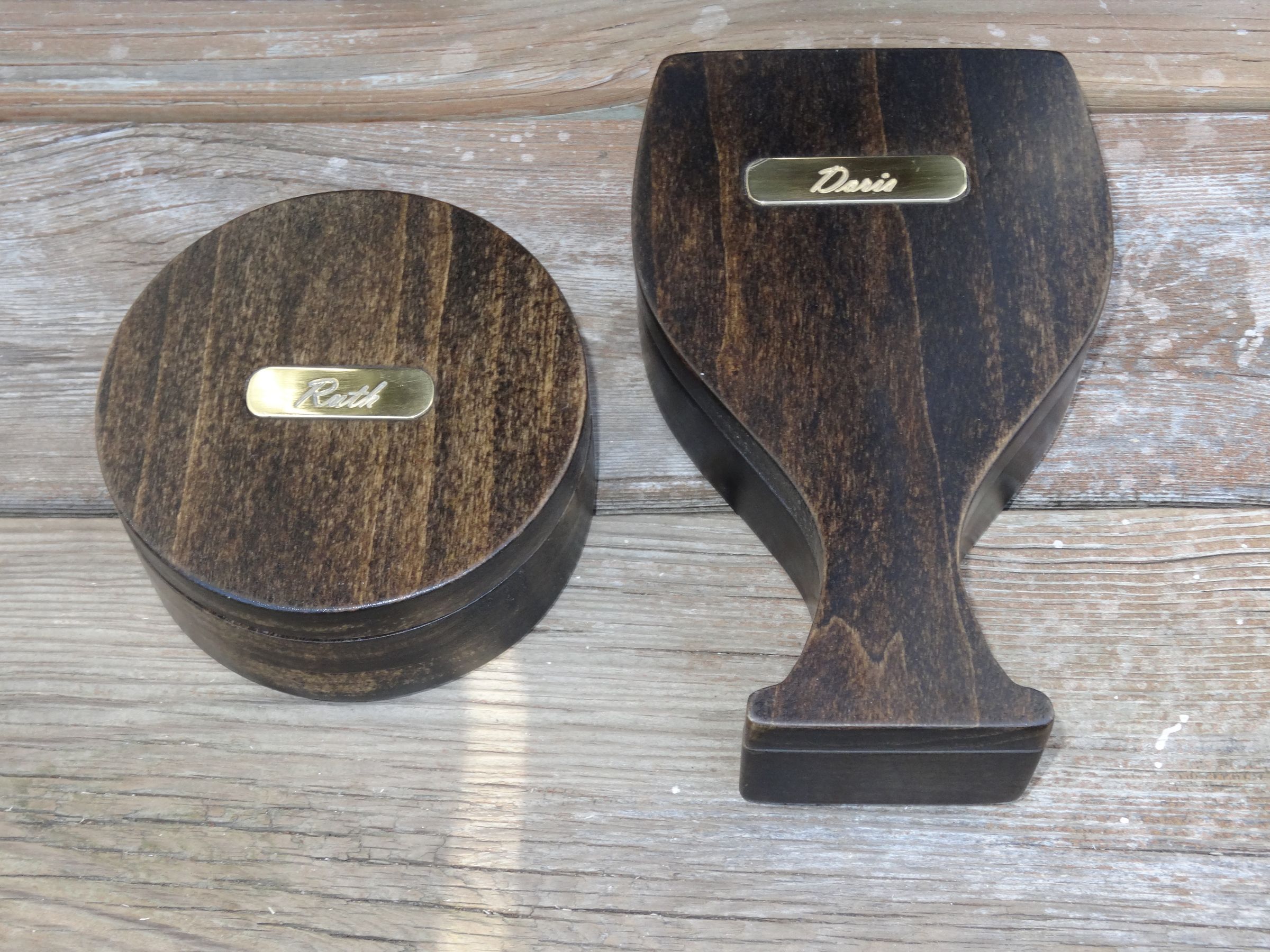

Step 7: Brass Nameplates
The brass name plates are engraved on the CNC. I made both names on the same length of brass and then used a hack saw and file to fit each one into the recess milled into the lid. This is a trial-and-error process accomplished using sandpaper, files and patience. It would have been quicker had I machine the parts completely on the CNC machine. The engraving tool was a 0.005" V bit which enables very fine features to be engraved.
The brass nameplates can be polished with a suitable metal polish. I used Meguires Metal Finishing Polish after sanding with 1200 grit sandpaper. Worked just fine.
Step 8: Staining
Staining is a very messy business. The stain gets on everything and is difficult to remove so use gloves and clothes that you don't mind discarding. I used Minwax Dark Walnut stain applied with a paintbrush. The process is very simple - apply the stain to the wood for 5-10 minutes and then wipe it off with a clean rag ( an old t shirt works best) when you have a color close to what you think is right. The longer you leave the stain the darker your wood will be but avoid letting the stain dry because you will end up with a sticky coating on the wood that is difficult to deal with. Stain can be reapplied to further darken the wood after a certain time - follow the instructions on the side of the can of stain. All the manufacturers of stains have a slightly different set of rules to get the best results. Stains require drying time after which you can apply polyurethane or acrylic coating to protect your project. I used water based poly acrylic because it is low VOC.

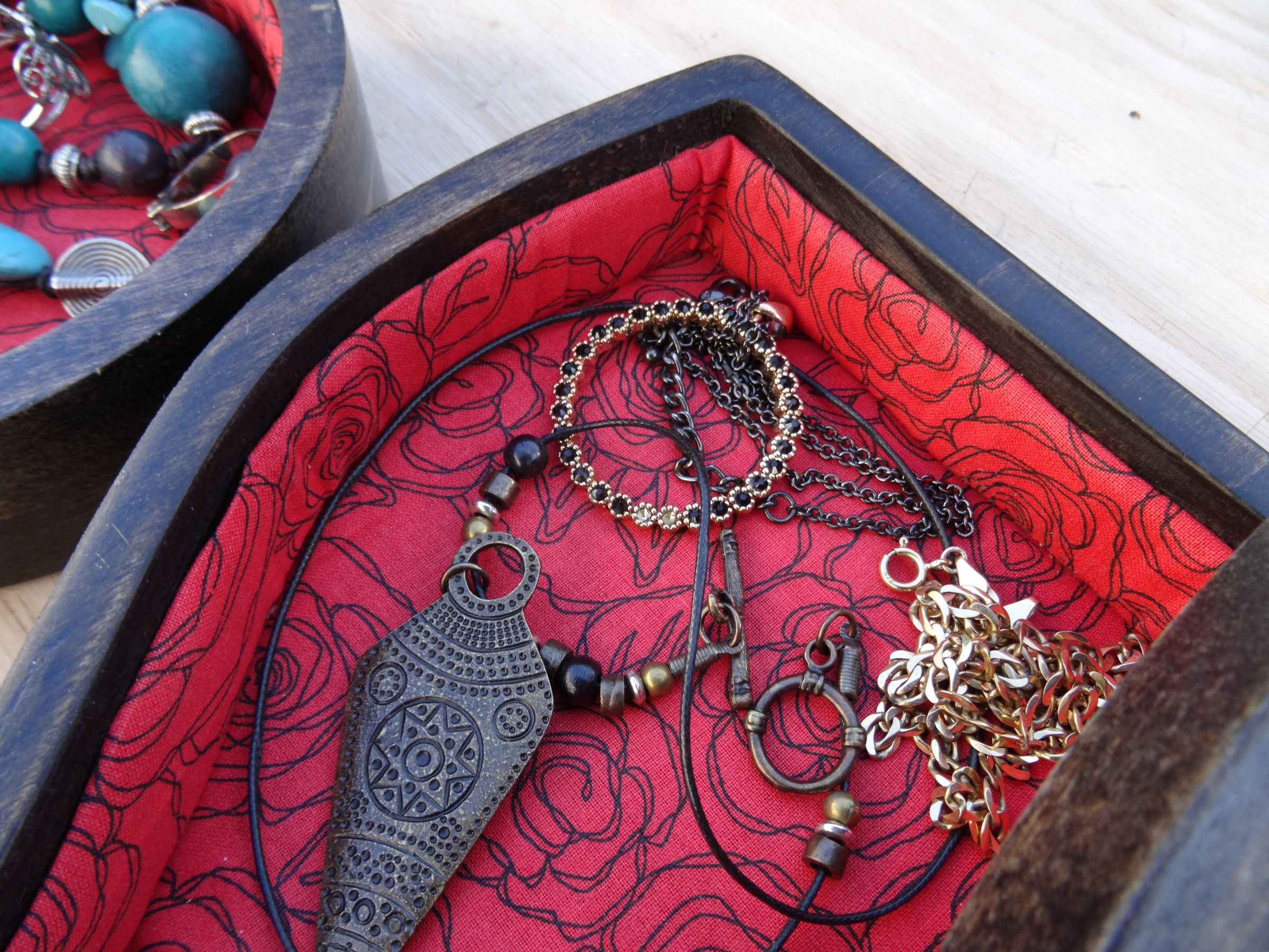

Step 9: Lining the Insides
The lining consists of a layer of poster board to which a layer of thick felt is glued. This is then covered with a layer of fabric.
Start by printing out a 1:1 scale of the 2D file which is attached here as a PDF file. Tape the page to the poster board and then using a pair of scissors or sharp knife, cut the shape out and transfer the shape to the felt using a piece of chalk as shown. Cut the shape about 1/16" inside the lines so that the poster board is smaller than the insides of the jewelry box. This will avoid it bulging up when you finally install the completed lining. Then cut the felt to shape and glue it to the poster board. I used Elmers glue for the first jewelry box but it takes a long time to dry. Hot glue is much faster so this was used for the round box.
Then cut a piece of fabric roughly 1/2" larger than the poster board/felt glue-up. Using the hot glue, fold the edges of the fabric over the edge of the board and glue them down. Take care to ensure that you avoid bunching on the visible side of the liner. Cut little darts into the fabric particularly around the curves to keep the front looking as good as possible.
Then cut a long 1" strip of poster board for the sides. Do a trial layout inside the jewelry box to get the right length and then repeat the process of a felt layer followed by a fabric layer. Don't worry too much about the back side as this will be against the wall of the jewelry box.
Then place the large shaped lining in the bottom of the jewelry box. You can use some hot glue to keep it in place but I didn't find it necessary. The long strip is then hot glued to the side. Take special care where the ends join - you want to fold over the fabric on the one end to make it nice and neat.
