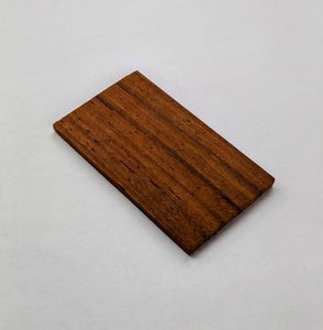

For materials, I chose to use some small scraps of Paduak wood I had laying around! You could use many different materials, though I found that for wooden earrings, hardwoods tend to work best!

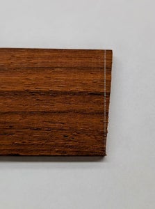

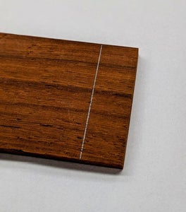

I squared the edge of the wood blank before layout to ensure that both sides of the earrings would be parallel. After that, I drew a line 3/8ths in from the end to mark the cut line.

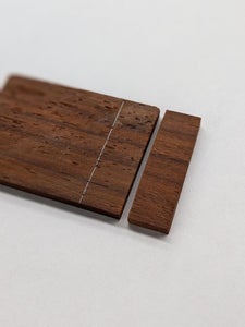

To cut the earrings out, I used a small Japanese style wood saw cutting against a wooden block to ensure the least amount of splitting and cleanest cut possible!

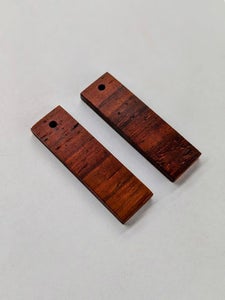

I drilled the holes with a 1/16 bit, making sure to drill through both sides to prevent blowout.

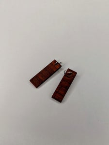

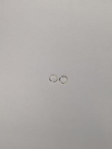

Here you can see the process of bending the earring hooks into shape. I used two inches of 20 gauge sterling silver wire and then bent it into shape using round jewelry pliers. After that, I made the jump rings out of the same material.

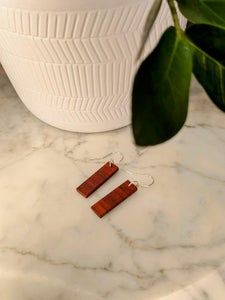

Step 7: Finished Product
Overall, I'm pretty happy with how these turned out and would love to see your take on this!
