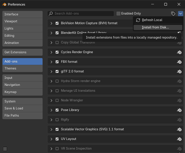

To install an add-on, just go to:
Edit > Preferences > Add-ons > Install → pick the .zip file → enable it.

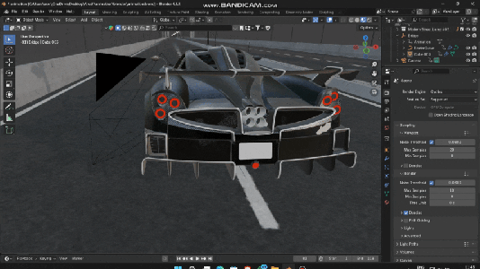

Step 3: Setting Up the Car Model
I wasn’t a fan of the default textures, so I gave the car a makeover:
  1. Metallic blue body + carbon fiber accents (via BlenderKit).
  2. Black tinted glass for the windows.

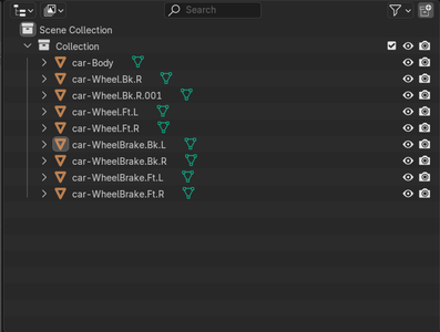

Then I rigged the car:
  1. Joined smaller sections into 4 wheels, 4 brakes, and 1 body.
  2. Renamed them properly.
  3. Added the Rigacar rig → hit Generate Car Rig.
For headlights and brake lights, I modeled small meshes, gave them an emission texture to glow, and mirrored them to the other side. Finally, I joined everything with the car body.

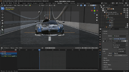

Step 5: Redoing the Environment(Bridge Scene )

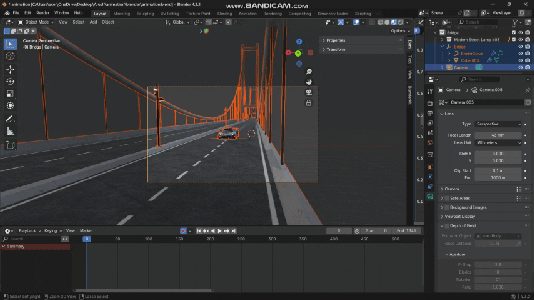

Instead, I decided on a bridge scene — simpler, lighter on rendering, and still cinematic. I imported a bridge and street lamp model using BlenderKit, then applied an Array Modifier to place them in a repeating line.
For the background, I used a beautiful sunset HDRI by EB Adventure Photoscans. I lowered its brightness slightly, boosted the lamp glow, and rendered a quick test. The lighting finally felt right.
Step 6: Animating Scenes 1 & 2
To start off, I wanted the animation to feel like a racing game intro — stylish shots circling the car.
I positioned cameras at different angles, set their start and end keyframes, rotated the HDRI for the best lighting, and rendered the test shots.

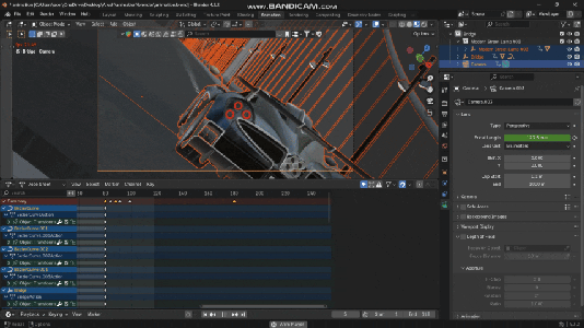

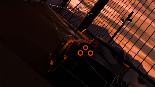

Step 7: Animating Scenes 3 & 4
Since the first two shots were simple, I went for something more dramatic
In Scene 3: a dolly zoom. I placed the camera behind the brake lights with a slight tilt, set a keyframe for the focal length, moved the camera back, adjusted the lens, and added another keyframe. With a bit of car body tilt and forward motion, the effect looked intense.
For Scene 4, I wanted to show speed. I placed the camera beside the car and parented it to the body. By animating the car forward and tweaking the focal length, the car looked stretched, simulating speed. I also shifted the camera sideways so the car gradually entered the frame. Finally, I enabled motion blur in the render settings to smoothen the movement.
Step 8: Animating Scenes 5 & 6
Scene 5: Was another dolly zoom, but this time from the front of the hood to make the car look like it was bursting forward.
Scene 6: Was a close-up of the suspension. I animated a slow zoom on the wheel and added motion blur to finish it off.

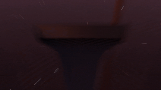

Step 9: Final Scene (Scene 7)
The last shot shows the car from multiple angles before ending on the starry night sky.
To pull this off:
  1. Enabled Fly Navigation in Blender (View > Navigation > Fly Navigation).
  2. Turned on Auto Keying so every camera movement was recorded.
  3. Smoothed out shaky motion in the Graph Editor.
Now the camera glides naturally around the car for the big finish.
