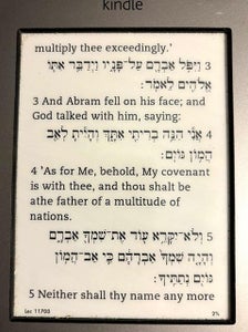

The photo above shows a screen from the parallel Hebrew and English Old Testament I have on my Kindle Touch. Look at verse 5 at the bottom of the screen. The last lines of the English text cannot be read without swiping to the next page. But, then the Hebrew text of verse 5 is no longer visible. If the user needs to compare both texts, it can become frustrating. It would be much more helpful to learning unfamiliar words or making sense of a difficult sentence if the complete verse in both Hebrew and English could be viewed on the same screen. The text displayed is Genesis 17:5.

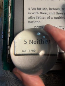

In the first photo I have used a 5x magnifier for the benefit of those who read this Instructable. Notice the Location Number for the page displayed is 11700. By trial and error I discovered each page or screen is about 60 Location Number units long. I shift the Location Number by adding 30 to it, but that is a starting point that usually works.

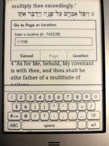

On my Kindle Touch, I touch the top of the screen with a finger or a stylus. The navigation box in the second photo appears. I enter 11730. and tap "Location."

The photo shows the screen with the new Location. Notice all of verse 5 is now visible, both in Hebrew and in English. But, also notice verse 6 is split just like verse 5 was.
Step 4: A Simple Solution
In order to get verse 6 back so both the Hebrew and the English are on the same page, go back one screen by swiping (Kindle Touch) and then swipe forward one screen. Verse 6 will be properly displayed, but verse 5 is split again.
