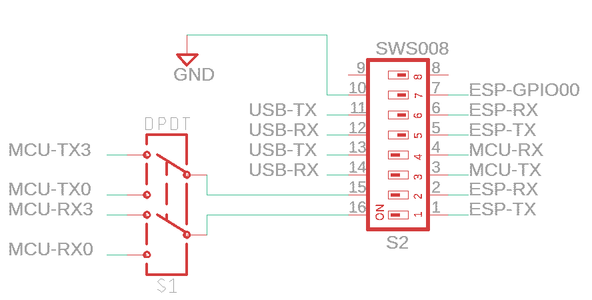

Step 2: Setting the DIP Switches on the Mega
On the Arduino Mega+WiFi, you should find 2 sets of switches that I have highlighted in the photo. On my board one switch is a 8 way DIP switch block (with tiny little switches that require a tool - e.g. small screwdriver - to move). The other switch is a larger switch which is in the form of a slider.
To try to minimise confusion, I will refer to the main serial port that is available on all Arduino boards as Serial(0). In code, this is the serial device that is named Serial and is normally connected to the USB port on Arduino boards.
The first block of 8 switches control the primary communications paths on the board. The options include:
- Connect the Mega's Serial port to the ESP (switches 1&2 on)
- Connect the USB to the Mega's Serial(0) port (switches 3&4 on)
- Connect the USB to the ESP (switches 5&6 on)
- Cause the ESP to enter programming mode on next reset (switch 7 on)
- Switch 8 is unused.
The second large switch determines how (i.e. by which path) the Mega is connected to the ESP (switches 1&2 on). This switch controls which of the Mega's Serial ports is used to communicate with the ESP. The choices are Serial(0) or Serial3.
What this means is that we can:
- use the Mega's Serial3 port to communicate with the ESP and hence utilise its WiFi capabilities.
and - Use the USB in the traditional way to upload code to the Mega and interact with the Mega's program via the Serial Monitor without having to constantly adjust switches 1&2 and switches 3&4 while programming and testing.
In short, this switch resolves the hardware conflict associated with the Serial(0) port that I outlined in step 1.
To set this up, configure the switches as follows:
- Turn switches 1, 2, 3 & 4 -> ON.
- Turn switches 5, 6, 7 & 8 -> OFF.
- The big slider should be set to the end with the TXD3 and RXD3 end (i.e. positioned away from the USB connector and the 8 way DIP switch).
The circuit diagram shows how I believe that the two switches are likely to be connected. I say this because I've found lots of diagrams online that (how can I say this?) do not appear to accurately reflect the actual circuitry on the board - some might say that the diagrams I found were "completely wrong".
I produced this circuit diagram from extensive testing/trial and error. In my diagram, it is possible that I have the TX and RX lines reversed on each switch pair, but this shouldn't matter as the switches should always be used in pairs (i.e. switches 1&2 should be set the same way, similarly 3&4 should be set the same way as should switches 5&6).

For this step, I am assuming that you didn't comment out the code to set the operating mode and join the WiFi (step 4). If you did, uncomment it before continuing. Once you have successfully joined your WiFi using the Uno, you can re-comment out the setting of the operating mode (AT+CWMODE=1) and the joining of the WiFi (AT+CWJAP="...","...") as the ESP will remember these settings even when powered off. Again, I would recommend not commenting this out, but if you really really want to, then do so once it has run successfully on the new hardware.
On the Uno, the one and only hardware Serial port is used to either upload code, interact with the serial monitor -or- communicate with the ESP - but not all at the same time. This is a conflict. To resolve this conflict we need to tell the board what we are doing (uploading or talking to ESP) using the DIP switches on the WiFi Sheild (or Uno+WiFi's) board.
In brief, we set the switches to allow the Arduino code to be uploaded via the USB. Once the upload has fully completed, we need to reset the switches to allow the Arduino to communicate with the ESP (this is the time critical bit).
To set the switches for upload, hold the Arduino Uno + ESP WiFi shield so that the USB is on the left hand side, you will notice 2 DIP switches near DIO pins 1&2 on the top right hand side of the board. Switch both of these to the off position. Refer to the image with the blue circuit board containing just 2 DIP switches.
If you are using an Uno + WiFi integrated board, there is an 8 way DIP switch in a similar position to that as on the integrated Mega + WiFi board. Refer to the image with the black circuit board containing 8 DIP switches. When uploading code to Arduino, you must switch the switches as follows:
- Switches 1 & 2 - Off
- Switches 3 & 4 - On
- Switches 5, 6, 7 & 8 - Off.
Upload the code in the normal manner. Unless debug mode is turned on, you will not see anything relating to the sending of the AT+GMR command - however, it will have been sent and the Arduino will be waiting for a reply - which will never come. We need to reset the DIP switches to Running the code mode before the Arduino times out waiting for the AT+GMR response. This is the time critical bit, so please - read on...
Running the code - MCU to ESP
Before the Arduino times out waiting for the AT+GMR response, we need to reconfigure the Board for running the code. As an alternative, you can just set the switches as described here and restart the Arduino (use the Arduino reset, not the ESP reset - or just power it off and then back on again).
If you are using the Arduino Uno + WiFi shield, turn the 2 DIP switches mentioned above to the on position.
If you are using the integrated Arduino Uno + WiFi board, set the block of 8 DIP switches as follows:
- Switches 1 & 2 - On
- Switches 3 & 4 - Off
- Switches 5, 6, 7 & 8 - Off - i.e. no change from the previous sub-step.
If you were quick enough, or you used the alternative (set the switches and restart), your Arduino should join your WiFi network.
