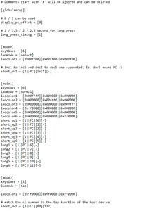

Step 1: Enter USB Setup Mode
Hold down the "Key 0" switch while powering on / connecting the device to your computer.
Step 2: Copy / Backup the Default File Structure
Copy / backup the default file structure from the midi captain duo. If you ever accidently delete any files / folders you can recover them.
The documentation is a bit vague when it comes to the layout of the file structure.
  1. Open the setup folder
  2. Open the Key0 or Key1 files.
Step 3: Key / Button Program Files
The Key 0 file is used to program all the actions associated with that button. The Key 0 file also contains comments (a hashtag # followed by text) which are used to describe what each action does. For clarity lookup "comments in programming". Key 1 file is used to program all the actions associated with that button.

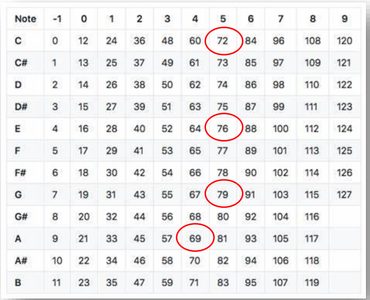

[][][] - commands to be executed when button is pressed. Multiple commands can be executed with a single button press. E.g. [1][NT][2][127] [3][PC][5][-] The first 4 brackets are for the note change command: First bracket is for the midi channel, the next brackets denote the Midi command to be executed, the next set of brackets denote the note to be sent (2 represents D-1) see note table. The 127 represents the velocity of the note. [3] is the start of the next command. [3] represents midi channel 3, and [PC] is a program change. [5] is the value of the program change. [-] is blank but necessary to include.
Sample Code [KEY0 file]:
[mode0] # Code below contains actions for mode 0 (first mode)
keytimes = [1] # Number of actions the button can loop through
ledmode = [select]
ledcolor1 = [0x00ff00][0x00ff00][0x00ff00]
# inc1 to inc5 and dec1 to dec5 are supported. Ex. dec5 means PC -5
short_dw1 = [1][PC][inc1][-]
[mode1] # Mode 1 (second mode)
keytimes = [6] # 6 different actions will be executed / each action will be executed after each button press
ledmode = [normal] # LED Mode follows button loop
ledcolor1 = [0x00ffff][0x000000][0x000000] # Sets button LED colors (3 LEDs can be controlled independently)
ledcolor2 = [0x000000][0x00ffff][0x000000] # See color chart in manual to select colors.
ledcolor3 = [0x000000][0x000000][0x00ffff]
ledcolor4 = [0xff0000][0x000000][0x000000]
ledcolor5 = [0x000000][0xff0000][0x000000]
ledcolor6 = [0x000000][0x000000][0xff0000]
short_up1 = [1][PC][0][-] # Sends Program change command on channel 1, Program change zero.
short_up2 = [1][NT][1][127] # [Channel] [Command] [value 1] [value 2]
short_up3 = [1][NT][2][127] # [Channel 1] [Note] [note 2] [ velocity 127]
short_up4 = [1][PC][inc1][-] # inc / dec can only be used for program changes
short_up5 = [1][PC][dec1][-] # inc1-5 can be used to increment a number / decrement a number
short_up6 = [1][PC][5][-]
long1 = [1][PC][6][-]
long2 = [1][PC][7][-]
long3 = [1][PC][8][-]
long4 = [1][PC][9][-]
long5 = [1][PC][10][-]
long6 = [1][PC][11][-]
[mode0]
keytimes = [1]
ledmode = [select]
