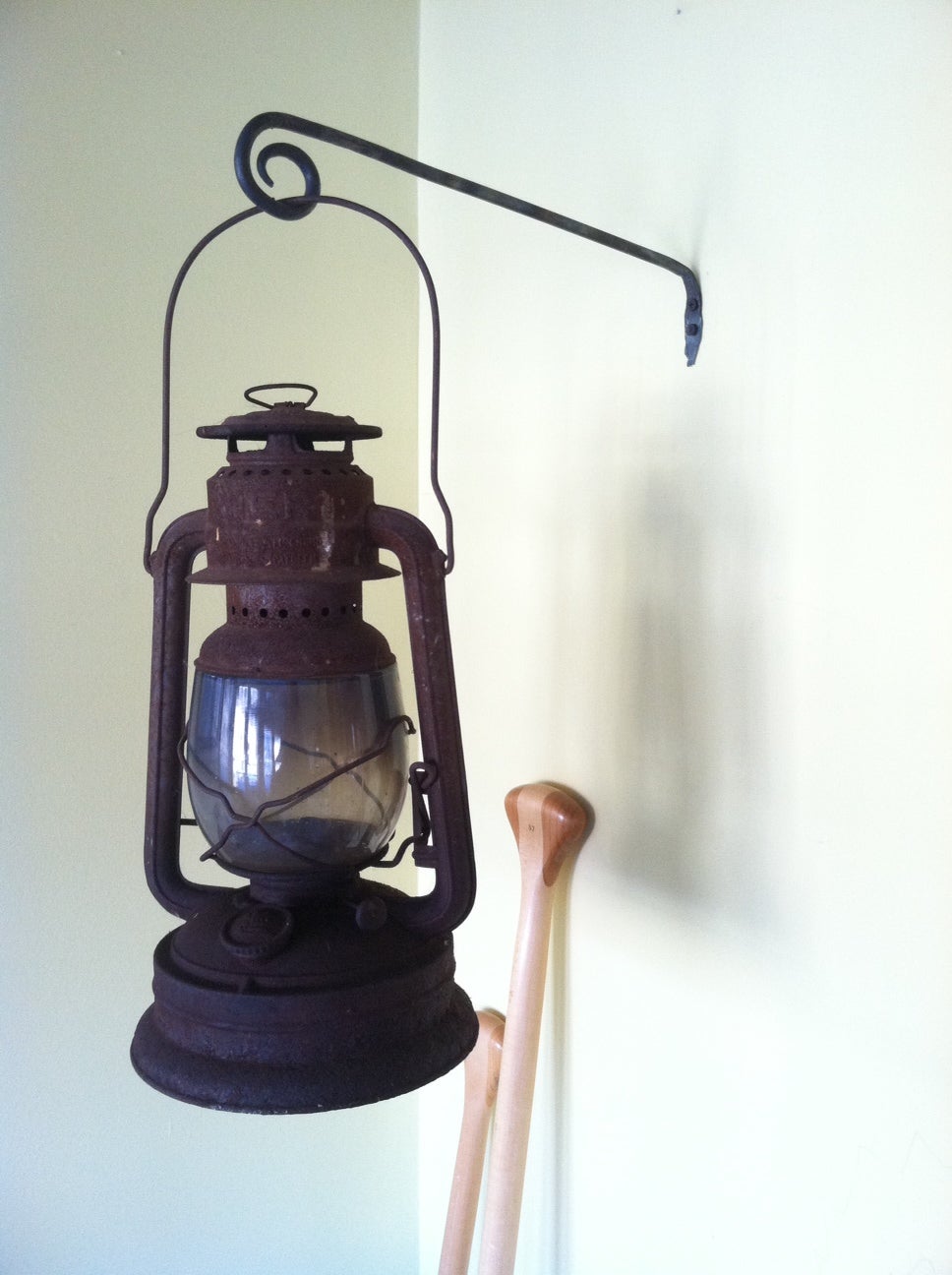

Step 6: First Project
My first project with this was to make an old looking hanger for my Wife's Antique lantern.
I don't have a real Anvil, just a piece of Railroad track "anvil shaped object" that I picked up at an estate sale.
The curled hook seemed to look good on my first attempt but it took a bit of work because it kept twisting to the side as i rolled it.
The flattened section against the wall took 3 tries to make. I figured out that to make a leaf like shape you first have to point the tip of the rod before flattening it. I don't have a closeup but I used the peening side of hammer to make leaf like marks on that.
Shown is the hook installed and hanging the Lantern. I think it looks pretty good for my first forging attempt ever.
