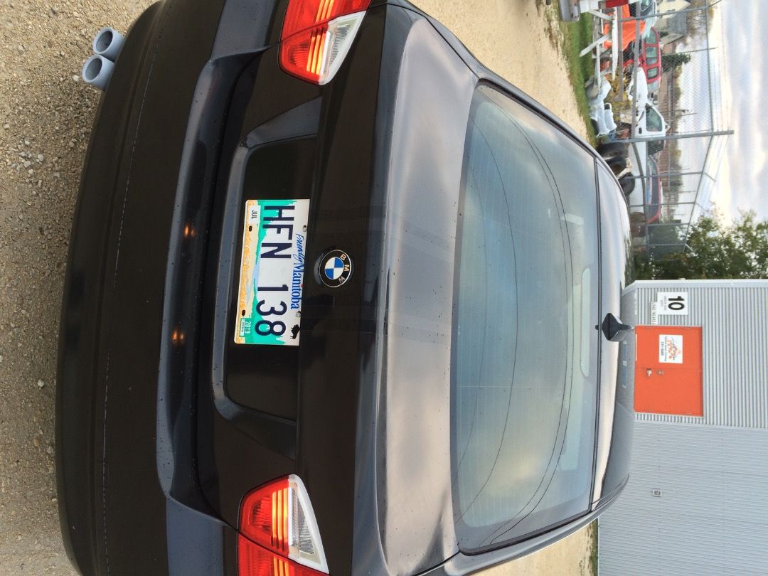

Step 9: Long-Term Results
After almost 2 years, I have finally washed the car for the first time! Lots of people have been asking for new pictures of the car, so on America's birthday I washed off a thick layer of dust to find that....it looks as good as new! When compared to the original photos, the paint looks as bright, shiny and clean as ever.
For a while I kept the car under a UV-shielded car cover, and for the last 6 months it's been under a carport, to minimize the UV exposure (a good practice for regular automotive paint too). Note that there are a few issues...in one or two locations the paint has cracked from impacts, but more noticeably there are a few spots where bird droppings dissolved the paint. This happened because I neglected to wash off said droppings for several weeks. I will probably touch up these spots with the spray-paint version of Rustoleum.
Anyway....below are the photos, which speak for themselves! They are not altered in any way besides resizing and blurring the plates. Also, it was much sunnier out (July at 2:00 vs December at 5:00) when I took the new pics, so the color doesn't look exactly the same as the old ones.
