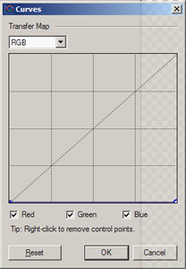

For the black parts there's even an easier way. Using the Black and White and Curves... from the Adjustments menu.
The Body, Left wing, Right wing, Left eyelid and Right eyelid layer:
1. Select the layer
2. Turn it into a black and white using Black and White from the Adjustments menu
3. Open the Curves... window from the Adjustments menu. Drag the curve to the bottom-right corner
The left wing has a little flaw at the top. Use the Rectangle Select tool to delete it.

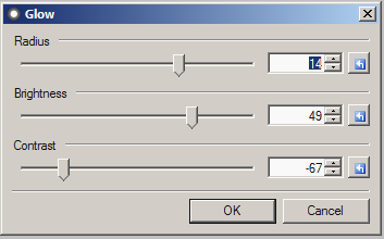

The eyes are done a little different then the Photoshop tutorial. There's no inner glow effect, but there's a glow effect, close enough.
The Left eye and Right eye layer:
1. Select the eye layer
2. Turn it into a black and white using the Black and White from the Adjustments menu. The eye should have color #848484 (or R: 132; G: 132; B: 132).
3. Choose Magic Wand, set Tolerance to 75% and select the eye
4. Invert the selection with Ctrl+i and delete
5. Select the eye again with the Magic Wand
6. Choose Glow... from the Effects > Photo menu with Radius = 14; Brightness = 49; Contrast = -67
