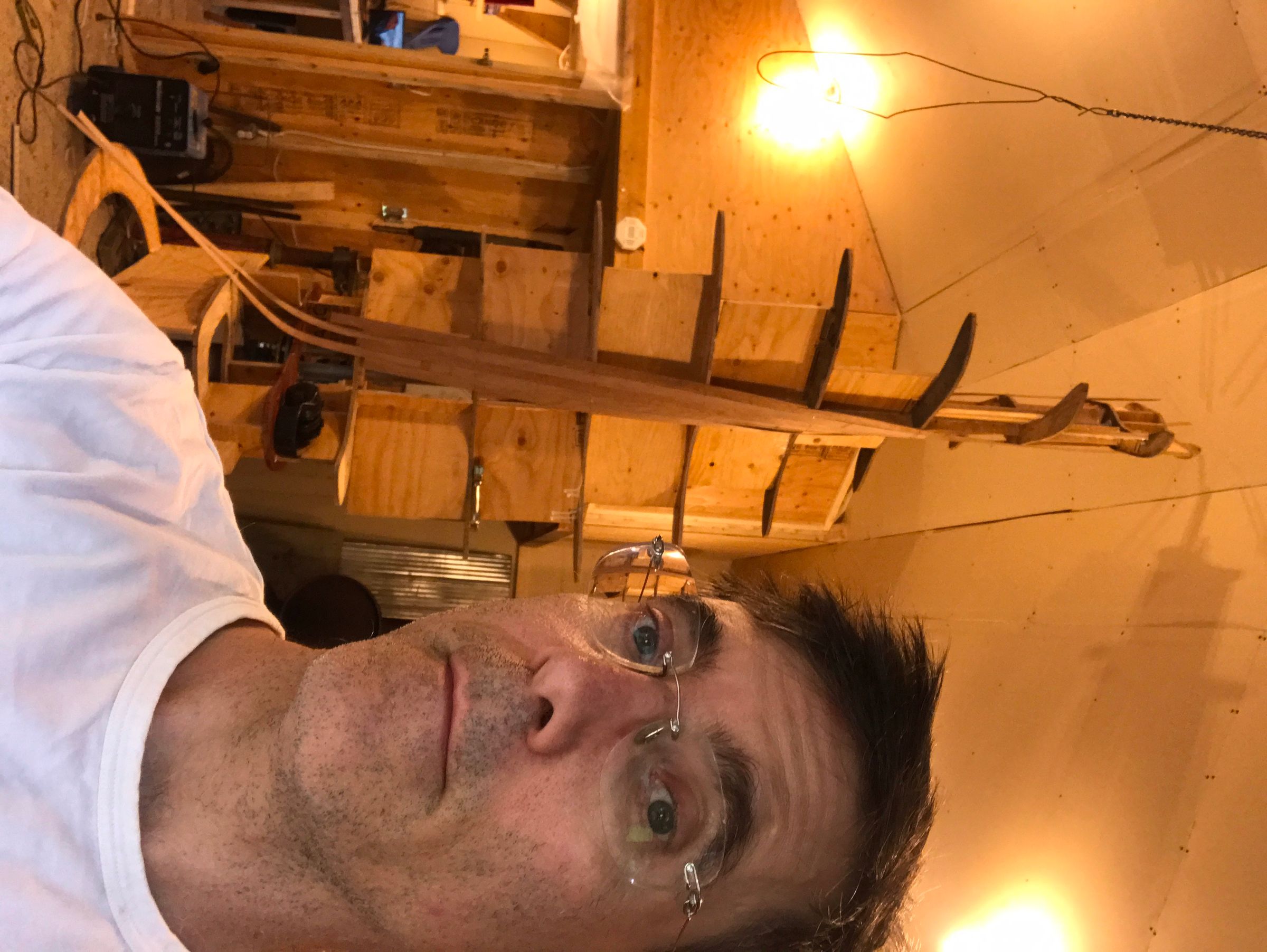

Step 2: Starting the Build, Layout, Glue, Cut
I had the 2 pdf's printed twice (4 pages)at my local print shop for about 5$. I cut them out and joined them to have 2 templates. I stuck the paper templates(reinforced with packing tape) to plywood and marked around them. The second template I cut into two pieces as it was unwieldy and thin in the centre. I ended up with 2 large parts, and 4 smaller parts. I glued paper to two sides of one part as a test, another part I used white glue and heavy paper drywall tape just over the fold lines. All the parts, taped, papered or nothing, got a coat of PVA glue.
Then, after carefully marking all the lines, I used a knife and scored all the bend lines.
This was all a bit of a mess, were I doing it again, I think I'd get the paper templates printed full size on heavy paper, or canvas, then I'd glue the paper templates directly to the plywood, and then more paper to the other side of the plywood. I'd then use a hand router and guide rail to cut all the bend relief lines, and bandsaw out the profile.
Step 3: Assemble Sides
After cutting the relief slots on the inside of all the bends, carefully prebend each joint. If joints don't bend easily enough, don't force them too much, instead just cut a little more out of the relief joint.
Something that might have saved me a lot of work, is before the joints are bent, or relief joints cut, I should have drilled all, or most of my tie wire holes.
With the prebend long piece, and it's mating shorter part, join the top vertical seam between the two with tie wire. Then the next horizontal seam, and on and on. I found it handy to have a good size work space for the turbine to lie down in, and had a number of heavy blocks and things to rest it on as you stitch it together. Continue with the second smaller piece, and now that you are an expert, join the 3 parts of the other side.
