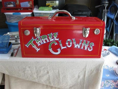

Just wanted to provide some additional photos of my hack.
Step 3: Additional Pictures of My Work
I try to do a different theme on each tool box
