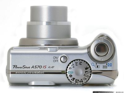

A digital camera WITH ability to manually adjust shutter speed.

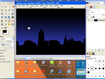

Download the picture out of the camera and save it to the computer. Get a dark picture off the internet or take one yourself with your camera, open it in the GIMP.

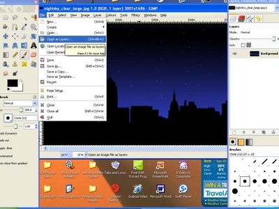

Save the smaller image as a JPEG image with a file name that you can remember such as "painting with light_small.jpg". Close the picture. Open the dark picture from the internet or camera in the GIMP if you have not already done so. Click File, Open as layers and open "painting with light_small.jpg" or whatever you called it.

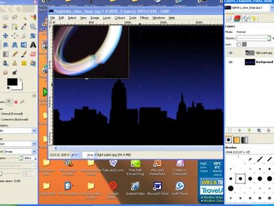

Make sure that the painting with light image is on the top layer. Drag it to where ever you want it and scale it to whatever size you want.

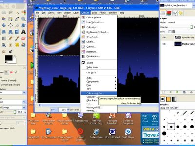

Step 6: Colour to Alpha

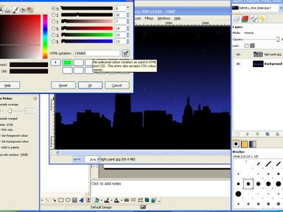

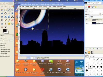

With the painting with light layer selected, select the color picker tool and click on the dark background of the painting with light picture. Click on the foreground color button. Copy the HTML notation to the clipboard.Click cancel. Click colours...color to alpha and click the colored box in the bottom of the window. Paste the HTML notation and click OK. Click OK to the color to alpha window. wait a few seconds. If both photos blend together seamlessly you are done. If not keep repeating these steps until all shades of black/gray are removed. You might also want to lower opacity of the painting with light layer a little bit.
Step 7: Done
Save your image and your done. Tell your friends that you have seen a UFO :).
