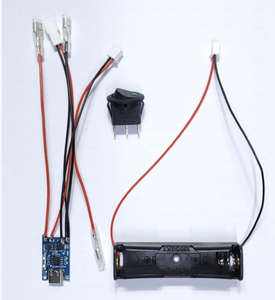

Battery Charger _ TP4056 5V 1A
Battery _ 18650 350mAh with Protect Shield
Battery holder for 18650 Battery
DC-DC Step Up Module _ XL6009 4A DC Converter

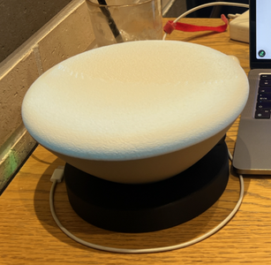

  1. Final product model:
  1. Why?
  2. Unique shape with plausible design to create and has the general form of a sphere, which also suits name

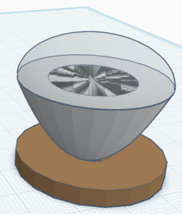

Step 3: 3D Modeling
As shown previously, the first model was made with tinkercad. In order to make the model more detailed and prepared for 3D modeling, the design was made in Fusion 360. It could make simulations of the model, which allowed better preparation than tinkercad.
Step 4: 3D Printing - Test Print, Final Prototype Print
Test print - We printed the dummy model of the product in two sizes – one with a smaller size than original and the other one with actual size – and saw how it felt like to hold it with our hands. This helped to adjust the placement of the on/off button and the heart sensor based on the position of the hands.
Final prototype print - Using the information got by the dummy model, we made holes in advance during printing and assembled them together. While printing, in order to get a strong structure of the product, we slanted the model by 30 degrees in order to increase the merged area of the layers. The fuzzy skin technique allowed me to express a cozier sense.

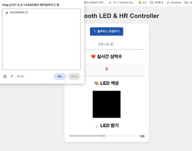

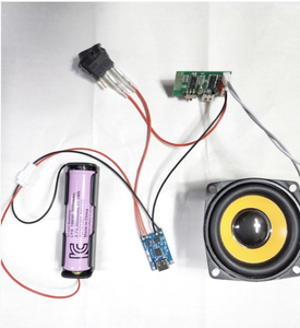

Step 5: Physical Computing - LED, Heartbeat Sensor, Control
Using the ESP32 Dev Kit V4 with the MH38 board, we connected the speaker to bluetooth. We used one battery or the USB 5V 2A to do the power of the entire product. It is expected that the model will work 2 hours with the full charged battery. Therefore, it is recommended to use the product with the charging cable for increased time of use.
While using the SZH SSBH 035 sensor, it is necessary to block the light passing the back of the sensor with a black object in order to get accurate results.

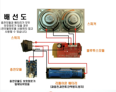

Below are the boards, power button, and sensor connection used.
  1. Sensor: S(signal)
  2. ESP32 board pin: GPIO 34
  3. Role: Analog Input
  4. description: Pin for reading the analog signal from the heart rate sensor.
  5. + (VCC)
  6. ESP32 board pin: 3.3V
  7. Role: Power source
  8. Description: Pin that supplies power to the sensor.
  9. – (GND)
  10. ESP32 board pin: GND
  11. Role: Ground
  12. Description: Ground pin of the sensor.
  13. NeoPixel LED 스트립
  14. Data
  15. ESP32 board pin: GPIO 13
  16. Role: Digital output
  17. Description: Pin for sending data signals to the NeoPixel strip.
  18. 5V
  19. ESP32 board pin: External 5V Power
  20. Role: Power source
  21. Description: Supplies power to the LED strip (The board’s 5V pin may not supply enough current, so an external power source is recommended)
  22. GND
  23. ESP32 board pi: GND
  24. Role: Ground
  25. Description: Ground pin of the LED strip, Must be connected in common with the ESP32 board’s GND

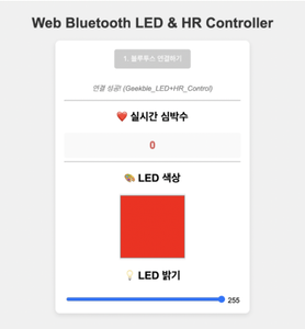

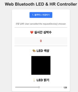

Step 6: Control Interface
## 3. Control Interface (Web Bluetooth HTML)
This HTML file uses JavaScript to connect to the ESP32 via Bluetooth and provide the user interface. Save this as index.html in VSCode.

const BRIGHTNESS_CHAR_UUID = "c83059f0-0051-4091-a12b-a8108e860d5b";
const HEARTBEAT_CHAR_UUID = "a1b2c3d4-e5f6-a7b8-c9d0-e1f2a3b4c5d6";
let colorCharacteristic;
let brightnessCharacteristic;
let heartbeatCharacteristic;
// --- UI Elements ---
const connectButton = document.getElementById('connectButton');
const statusDisplay = document.getElementById('status');
const colorPicker = document.getElementById('colorPicker');
const brightnessSlider = document.getElementById('brightnessSlider');
const brightnessValue = document.getElementById('brightnessValue');
const heartRateDisplay = document.getElementById('heartRateDisplay');
// --- Event Listeners ---
connectButton.onclick = connectToBLE;
colorPicker.oninput = writeColor;
brightnessSlider.oninput = writeBrightness;
brightnessSlider.onchange = writeBrightness; // Ensure change event also fires
brightnessSlider.onmousemove = updateBrightnessDisplay; // Update display continuously
function updateBrightnessDisplay() {
brightnessValue.innerText = brightnessSlider.value;
// 1. Connect to BLE Device
async function connectToBLE() {
try {
statusDisplay.innerText = "Attempting to connect...";
// Request device based on Service UUID
const bleDevice = await navigator.bluetooth.requestDevice({
filters: [{ name: "PAIXSPHEARE_Controller" }], // Filter by name for clarity
optionalServices: [SERVICE_UUID]
statusDisplay.innerText = "Connecting to GATT server...";
const server = await bleDevice.gatt.connect();
statusDisplay.innerText = "Discovering services and characteristics...";
const service = await server.getPrimaryService(SERVICE_UUID);
// Get Characteristics
colorCharacteristic = await service.getCharacteristic(COLOR_CHAR_UUID);
brightnessCharacteristic = await service.getCharacteristic(BRIGHTNESS_CHAR_UUID);
heartbeatCharacteristic = await service.getCharacteristic(HEARTBEAT_CHAR_UUID);
statusDisplay.innerText = "Subscribing to Heart Rate Notifications...";
// Subscribe to Heartbeat Notifications
await heartbeatCharacteristic.startNotifications();
heartbeatCharacteristic.addEventListener('characteristicvaluechanged', handleHeartbeat);
statusDisplay.innerText = "Connection successful! PAIXSPHEARE is ready.";
connectButton.disabled = true;
colorPicker.disabled = false;
brightnessSlider.disabled = false;
} catch (error) {
console.error("BLE Connection Error:", error);
statusDisplay.innerText = `Connection Failed: ${error.message}`;
// 2. Handle Heart Rate Data (Notify)
function handleHeartbeat(event) {
const value = event.target.value; // DataView object
// Read 2-byte (Uint16) value sent from ESP32
// 'true' indicates Little Endian format
const sensorValue = value.getUint16(0, true);
heartRateDisplay.innerText = sensorValue;
// 3. Send Color Value (Write)
function writeColor() {
if (!colorCharacteristic) return;
let hex = colorPicker.value.substring(1);
let r = parseInt(hex.substring(0, 2), 16);
let g = parseInt(hex.substring(2, 4), 16);
let b = parseInt(hex.substring(4, 6), 16);
// Send 3-byte data
const data = new Uint8Array([r, g, b]);
colorCharacteristic.writeValue(data)
.catch(err => console.error("Color Write Failed:", err));
// 4. Send Brightness Value (Write)
function writeBrightness() {
if (!brightnessCharacteristic) return;
let brightness = parseInt(brightnessSlider.value);
brightnessValue.innerText = brightness;
// Send 1-byte data
const data = new Uint8Array([brightness]);
brightnessCharacteristic.writeValue(data)
.catch(err => console.error("Brightness Write Failed:", err));
</script>
</body>
</html>

The images above are screenshots of what the application showcases. It requires to type in:
  1. Name
  2. Age
  3. Gender
  4. Job
  5. Stress rate(1-10)
  6. Music title(what you want to listen to)
  7. Singer
After that, it shows bluetooth connection, BPM rate, and LED light controller. This is made so that the users could easily access the object.
This application was created for potential paixsphere users in the future, but needed some improvements.
One of the main problem was that due to the phones' strict privacy policy, the bluetooth would not connect easily. This was also happening because the application would only open on google chrome. Therefore, the next step might be actually launching an application for the paixsphere if it becomes an actual product.
