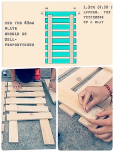

Join the part of the storage sides, front and top. Leave 1,5cm (0,59 in) space by the top of the sides - it's approx. the thickness of a slat and place the 8 40cm slats well-proportioned. Then hammering nails into it in order to fix them. Repeat it by the front - but here need only 5 40 cm slats and must saw the rest.

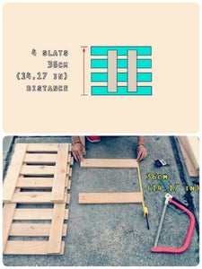

The top: Need 4 slats 36cm (14,17 in) distance and here use the 2 slats,
that earlier saw. If you want position handle on the top too, it looks good :) For the bottom need 5 40cm (15,7in), for the inner side need 2*40cm (15,7in) and 2*33 cm (13in).

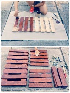

The next step is painting the surface of the parts with wood stain. We
chose a mahogany color, love it :) Wait till the parts dry completely (it depends on the wood stain)

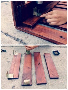

Use square brackets to the joint - 3 pieces for each corner (for the
front 2 is enough). For the inner slats also use square brackets. Almost the last step, clinch the 5 slats onto the bottom then, position the caster wheels on it and fix them with screws.
