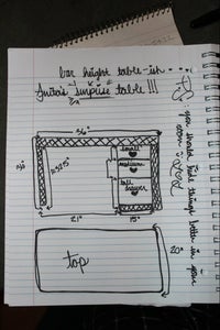

A little bit before Christmas my girlfriend asked me to make a desk for her. She came up with the dimensions and it was my job to get it done. Unknowing to her, she did not realize I was making it. When making it I didn’t want the top to just be a few boards so I decided to make the top out of a whole bunch of slats that I glued together. After making the top with the slats I decided I wanted to make as much as I could out of the slats. It seems like a good Christmas gift because she loves it.

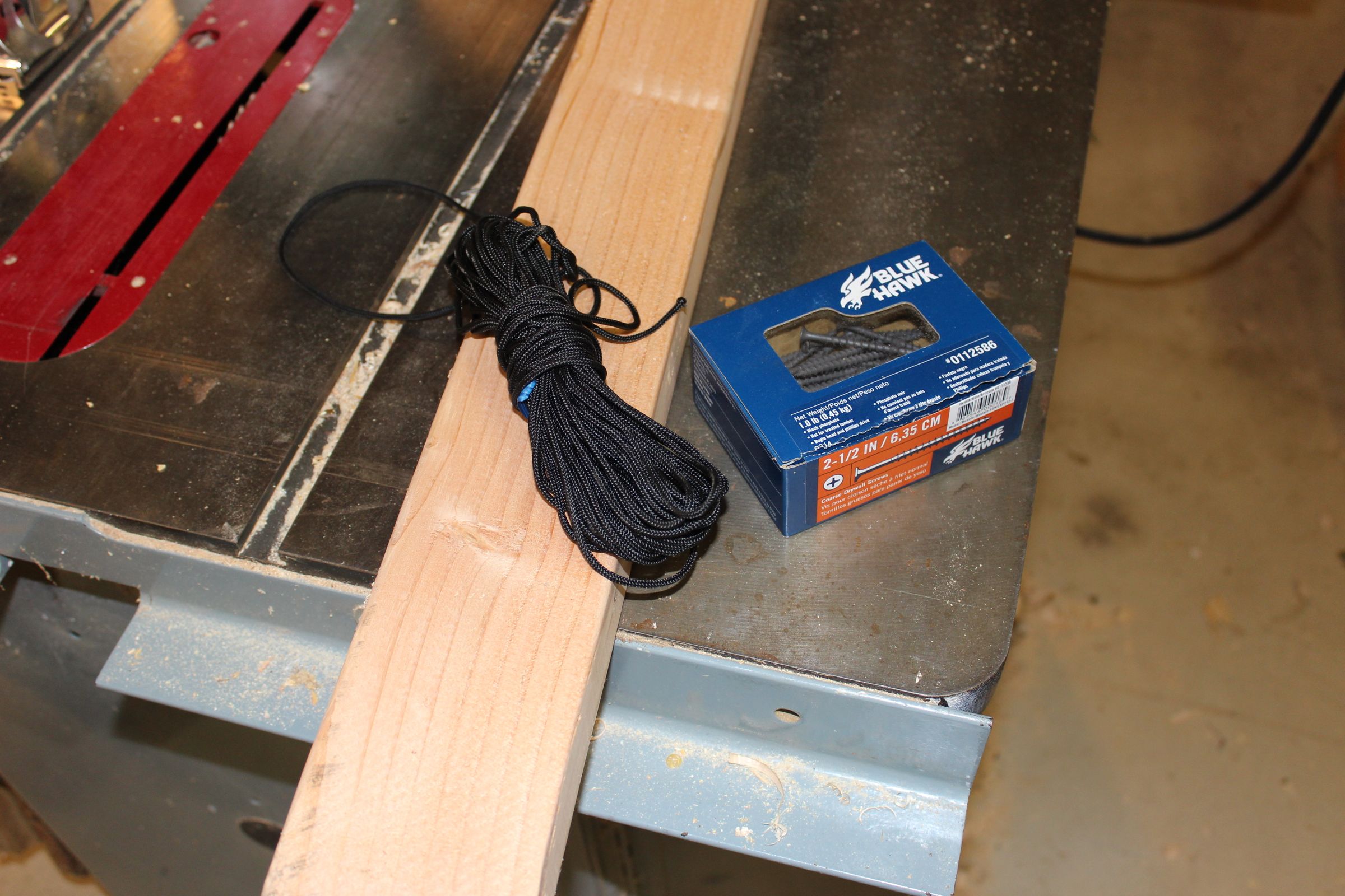

For this project you will need the following tools and materials:
Tools
- Table Saw
- Miter Saw
- Planer
- Clamps
- Chisel
- Orbital Sander
- Sand Paper
Materials
- Pallet wood
- Wood Glue
- Wax paper
- Para-cord
