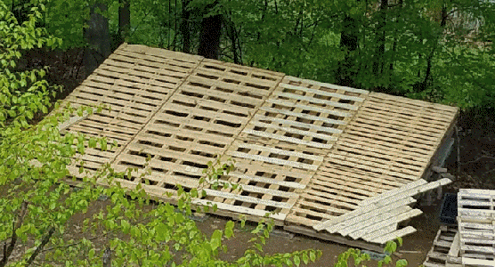

So I have pallets of all kinds of sizes. 4'x4' (or so) 3'x8', 4'x10' and the Rolls Royce of pallets: 5'x16'. the 5' by 16' drove the final decision to make the deck 16'x20': 4 of these pallets side by side for the top layer. The goal being to build up the other pallets to make a level deck just below that on any old configuration of pallets, with the penultimate layer being the 4' x 10' pallets configured 90 degrees out of phase with the top layer of 5'x16' (aka going the other way,) In the penultimate layer to the penultimate layer, (yeah that's right,) I also put several of the 5'x16' pallets to get it level. Shoot, I had a whole pile of the 5'x16' and the shop that had them said to come back anytime for more. If they weren't so heavy, I'd have done the whole thing in them and cut them down with a chainsaw instead.
I initially thought I would have to screw these pallets together, but heck they were so heavy and the boards ended up interlocking like lego pieces, they weren't moving at all. I just left them be.
Anyway I played back and forth for a while to get them basically level so that when I put the final 4 5x16 pallets down they were pretty much a solid deck right there with the exception of: 1) being butt ugly pallets, and 2) the gaps way too uneven and big.
Step 3: Finished Pallet Deck,
This is what the deck looks like when its finished with just the pallets. Pretty ugly. lets clean that up a bit with my main building material and expense: $1000 worth of 1"x6" x82" pressure treated wood boards from Lowes.
