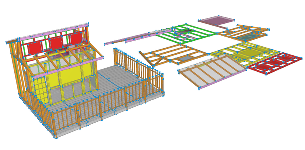

Well while that was going on, it was time to figure out exactly what to build. The town said it had to be under 100 sq feet, so after a bit of playing around, I figured that left me with one of two foot prints: either 10x10, or 8x12. 8x12 allowed me to build with standard sized lumber, and with playing around with 3D software and standard sized furniture, it really seemed that the 8x12 would work, Alas if I used Pallets as walls, with the pallets being pretty thick, the usable space on the inside would be reduced to about 7x11, and That was too small, so I resigned myself to standard 2x4 uprights, and a thin skin on the outside.
It actually took quite a bit of time and pencil drawing on graph paper to work this all out, I tried all kinds of configurations, and furniture to fit everything I wanted into the space but not have it too cramped. The town didn't have any height restriction, so I made the decision to go to 12 feet high: a 7.5 high first floor, and a 5'x7' loft area for 2 other people to sleep.
I then went to work with some CAD software (AC3D) to get all the sizes right, and allow me to easily move around doors and windows in a virtual environment to get what I wanted. Many, Many, hours were spent designing. I realized the problem with most of these types of Cabins is the lack of windows, so this one was going to have a lot. For safety I also wanted two exits, two doors. After months of trying, (and also planning out the deck,) I came up with the design as pictured in this step. I then modeled the walls, and the cutouts for the window and doors. I even made a paper model of the cabin and in photoshop did a 3d rendering of what I imagined what the house would look like from the window of my house.

With the 3D CAD done, I made some educated guess as to what it would look like outside my window and I photo-shopped an image of it. The first picture of this Step is what that looked like next to how it actually looked when I was done. Pretty Close IMO. Over the winter I built 5 24x16" windows out of plexiglass and paintsticks. I also spent about 15 minutes every night scouring facebook marketplace for supplies. over the winter I was able to make arrangements to pick up all sorts of materials for next to nothing and free. See the pictures. The best deal I got was when I got the big picture window for the front (36"x 24") for a whole $10, the seller through in "for free" a stained glass piece. I was expecting some kind of small sun catcher but instead it was a magnificent, albeit falling apart, 100 year old lead etched stained glass window. I was in shock, In good shape I imagine I could of sold this window for the entire cost of this project. This of course required me to re-consider half my design to put this piece of art facing South so it would cast the light in the morning into the cabin. Had to move the doors and windows to accomodate it, etc,etc. In addition, It needed major reconstruction of its wood frame, which was a whole project in itself, but I was hunkered down for the window anyway, so what fun it was.
