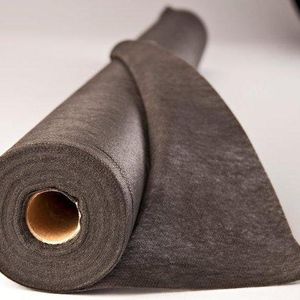

Step 8: Cut Big Sizes of the Landscaping Fabric Enough to Cover Each Plant Divided Section
Step 9: Cover the Landscaping Fabric Inside the Divided Plant Section Till You See No More Openings for Soil to Fall Through
Should look a little similar to this
Step 10: With a Stapler Staple the Fabric Inside and Outside the Plant Holders,
