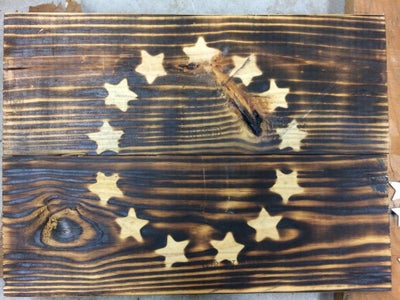

The first flag I made was a 13 star Betsy Ross style, with a Thin Red Line flag that someone ordered soon after, and later a standard 50-star as a Father's Day gift as well. The pictures in this Instructable will be a "best of" mix of these flags.

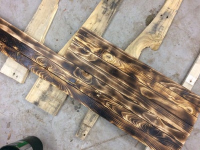

Step 6: Fire at Will!
Set out the stripes in the order you'll have them for the flag. You can number the ends in pencil to keep track of where they go.

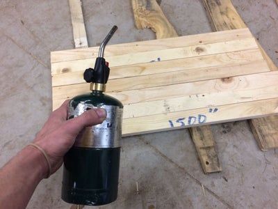

Pull out your torch and light it up! I have a small $15 one from Home Depot (I don't recall the exact one, it was similar to this), but you could overkill it and it would work the same.
Starting with the top strip, every other one will represent a red stripe (see last picture). Do your best to put the lighter colored strips where the white stripes will be, since they're meant to be, well, white.
Pull out the soon-to-be "red" stripes and bring them to a well ventilated area on a non-flammable surface and give them a once over with the torch. Don't burn too much that they crisp up, just enough to darken them slightly and make the grain really pop.
It can take a bit of practice to get the texture that you want, so be sure to practice on some scraps before burning your project. Remember, you can always burn it deeper later, but I have yet to figure out a way to unburn something.
Bring your new red stripes back to the rest of the flag and set them back in place. It should be starting to look like an American flag now.

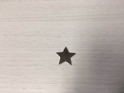

In order to torch over the field but leave the star areas unburnt, you need to mask off the stars while you torch it. I tried a number of ways for doing this- masking tape, wood, and some scrap steel plate.
The masking tape burnt easily and left some nasty glue residue on the wood.. that is, if it came off at all and didn't melt right onto the board. Tape was straight out of the picture.
Wood worked decently as a template, but wouldn't work for many in a row because well, the point of this step was to burn wood. If you don't have any metal plate around wood could work for a one-time use.
I was a little hesitant to use steel plate because I thought it would heat up too much and scorch the wood beneath it, defeating the whole purpose of using a template. But I was running out of other options and up for an experiment. I had an arrowhead-shaped scrap left over from a previous project and tried it out. It worked quite well! Very distinct edges and no scorching beneath the steel. From other tests I found that the edges would get blurred somewhat if the wood was uneven or the steel was warped, but that would just add to the rustic look.
Be sure not to use super thin metal or it can warp too much from the heat. I used .050" (about 1.3mm) thickness. 1" tall stars are pretty close to proportional for the 37" long flag.
I printed off some 1" stars from Google Images and cut them out on paper, then sized them onto some offcuts from the scrap bin. I used a bench shear to cut the steel to about 1.25" squares, then traced the stars on with sharpie and ground to shape on a belt sander with heavy grit sandpaper. I also touched them on a buffing wheel to get rid of any sharp corners that I would definitely cut myself on later, as well as to remove the heat discoloration from grinding, but that isn't necessary.
If you don't have a bench shear, you can use tin snips or a hacksaw to cut out the rough shape before grinding to the final star shape, or start with small scraps and simply grind a little more. You could also swap out the belt sander for an angle grinder. A dremel with a cutoff wheel might work but would take much longer and quickly wear out the wheels. Be sure to use gloves while grinding because the steel will get hot, and a breath mask so you don't breathe in the metal particulates.
I originally planned to make just a few stars and move them around as I burned the wood, but they were fairly quick to make so I made 5-10 a day after work and soon ended up with 50 after all. This makes the next step simpler. If you don't have enough steel to make all 50, you can do it with 10, 5 if you're pretty careful, or maybe even with 1 if you are highly skilled and want a challenge. Just set them out in one area, burn around them and move them to the next area. Be sure to use gloves to move the stars as the steel will get very hot.
Don't worry if the stars aren't all identical, you can barely tell later and it just adds to the character of the project.

I made a 13 star "Betsy Ross" flag the first time before I had all my stars finished, and a 50 star flag later on. I've included pictures of them both.
I wasn't able to find any dimensions online to position stars in the Besty Ross style, so I decided to set the stars around something circular and just eyeball it. I tried a handful of different objects: a 3-gallon bucket, a loop of wire, a dinner plate, but none of those seemed quite the right size. This multi-purpose antifreeze proved to be truly multi-purpose and worked perfectly to size my circle (I think a vinegar jug would would be the same size). It will change slightly depending on the size of your flag, so use a circular object that looks right for yours.

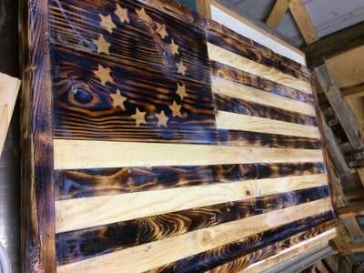

For a 50 star flag, set out 5 stripes of 6 stars each, then 4 stripes of 5 stars centered between the stripes of 6 (See photo 5 for a visual). I had planned to use the flag dimension calculator to figure out what the spacing should be, but ended up just eyeballing it until the stars looked fairly even. I left about 3/4" of space open on the top and left side that will be covered by the border in the next step.
Set out your stars and burn around them in the same way you scorched the stripes. I burnt the field a slight bit more to give it a bit of a difference from the color and texture of the stripes, as well as to give the stars more definition.
Be aware that if the wood is not fully dry and has a lot of resin in it, it will not work well for burning. The heat will cause it to bubble up and shift the stars around, as well as catching on fire quickly but not scorching the wood beneath. I had this problem with one of the Betsy Ross field halves, and ended up having to scrap it and make a new piece from scratch.
Be careful removing the stars after burning, they will be hot!
Add the field to its position in your stripes. Your flag should be looking like Old Glory!
