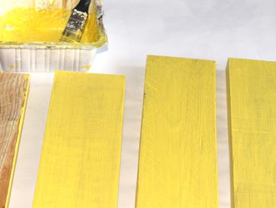

After all the pieces are cut and sanded, we painted the frames of the benches a lemon yellow to echo the gabion cage / metal shelving unit.

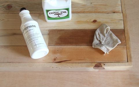

Step 5: Non Toxic Finishes
Before attaching the base to the tabletop, we applied wood finishing since it's easier. The finishing oil recipe we used here is from realmilkpaint.com, a 50% tung oil + 50% citrus solvent, to help the oil seep into the wood better. Now they offer this already mixed.
After applying a coat of this finish and let it cure for a day, repeat this process 2 more times. In my woodworking class we used a 'slurry method' where we sand with 220 -400 grit sand paper and create a oil-fine saw dust slurry mixture, which fill in the pores of the wood and create a marble like finish after doing it daily for 7 days.
We did not do it here, not that we are lazy ( well, hmm), but because we kept a lot of the surface character of the pallet wood. So we just wiped on the finish with a rag. Woohoo no long hours of sanding!
After the oil cures for a week, we applied a finishing wax, recipe from Amber Dusick. Melt 1 part beeswax to 4 parts olive oil in a double boiler, let cool, apply a generous amount onto the wood surface, and enjoy the delicious honey smell on your furniture!
There seems to be as many great wood workers as there are different recipes for wood finishes. You are welcome to share your favorites in the comment section!

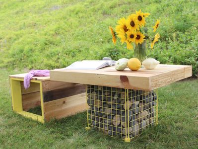

Step 6: Assemble and Enjoy the Outdoors
To assemble the table, collect some pebbles or rocks from your mountains and rivers nearby. We used beach pebbles, which make us think of the ocean.
And these chubby little pebbles weighed 50 lbs!
Center the hollow post inside the metal wire cage, fill pebbles all around the post to the top. Slide the table base inside the post. The pebbles heavy weight hold the post and table in place, and create a strong and sturdy base.
Now we can sit in the garden and enjoy a nice book outdoors accompanied by bird songs!
