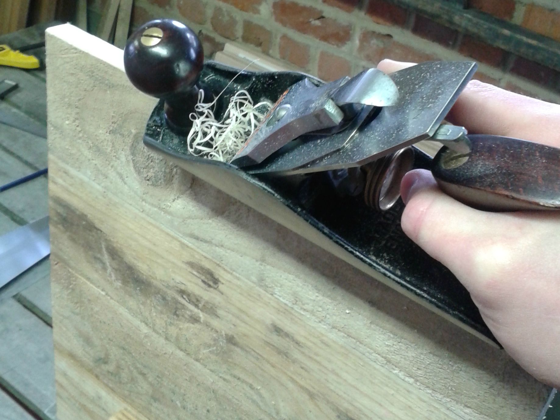

One of the pallets had slats that ran only half the length of the pallet, so they were the perfect length to glue up into a panel. A strong glue joint requires no gaps when you press the boards together by hand. Obviously, this wasn't the case, but luckily there's a tool for that: the hand plane.
Fold two boards together as if they were an open book, laying on its cover (see arrows on 1st pic). Clamp them into a vise and plane both edges at the same time, until you have two continuous shavings (pic 2). It doesn't even matter if you plane slightly out of square, because the angle on one board will compensate for the other. Do this for all boards and test for gaps. If you are satisfied, glue all boards together (pic 3). Notice the piece of wood clamped to the panel with yellow clamps. This keeps the boards level while clamping pressure is applied. Leave to dry for approximately 2 hours (more is even better). When applying glue, a zigzag line of glue on one edge of a glue joint is enough (pic 4). If you rub both boards together you'll distribute the glue evenly.
If you'd like to know more about setting up a hand plane, I can refer you to a video of Paul Sellers.

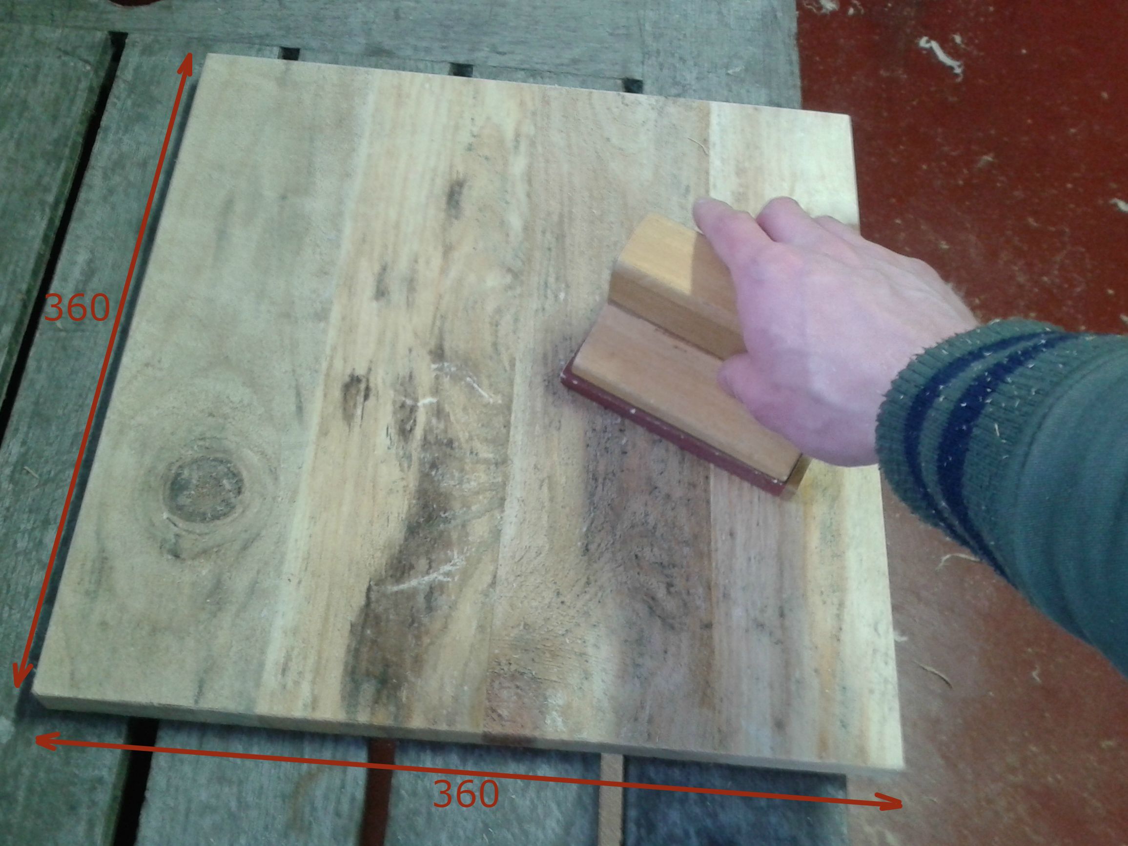

Once your panel has dried, you can cut it to exact dimensions: 360x360 mm. If you own a table saw, by all means use it. But hand saws work well too. You have to realize you need a saw for crosscutting (pic 5) and a saw for rip cutting (pic 6). Stay away from your pencil line and then plane to your line for best results. While you have your plane handy, also break all sharp edges:
Finally, give both sides of your panel a light sanding:

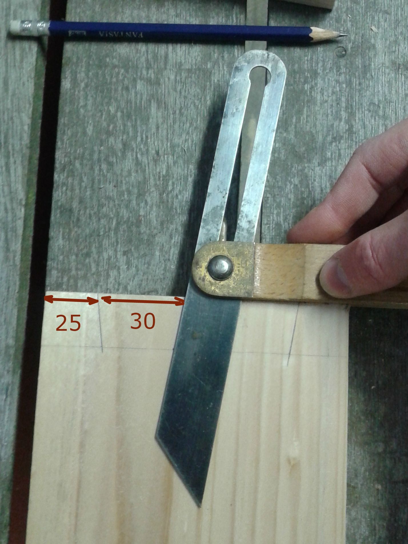

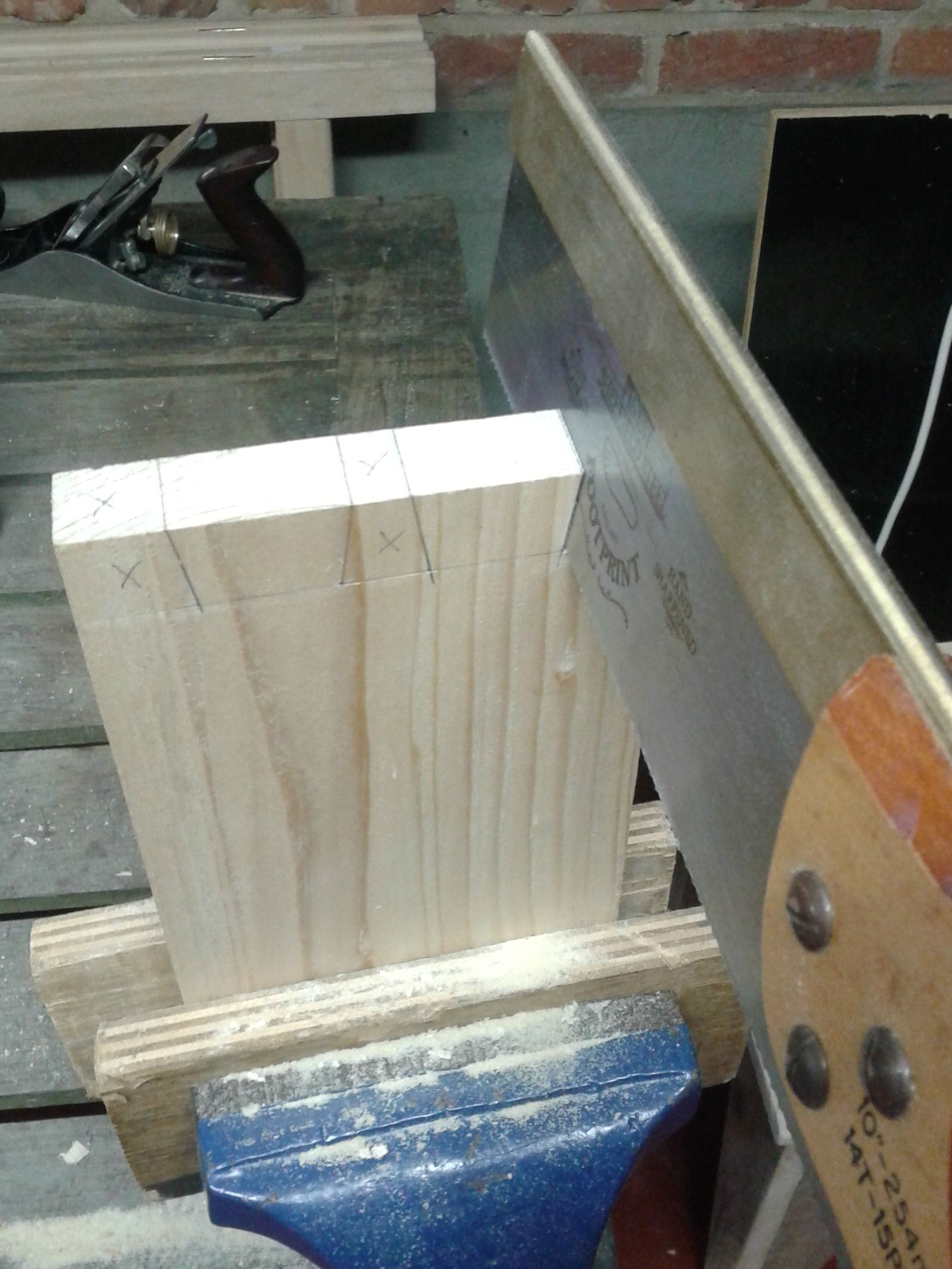

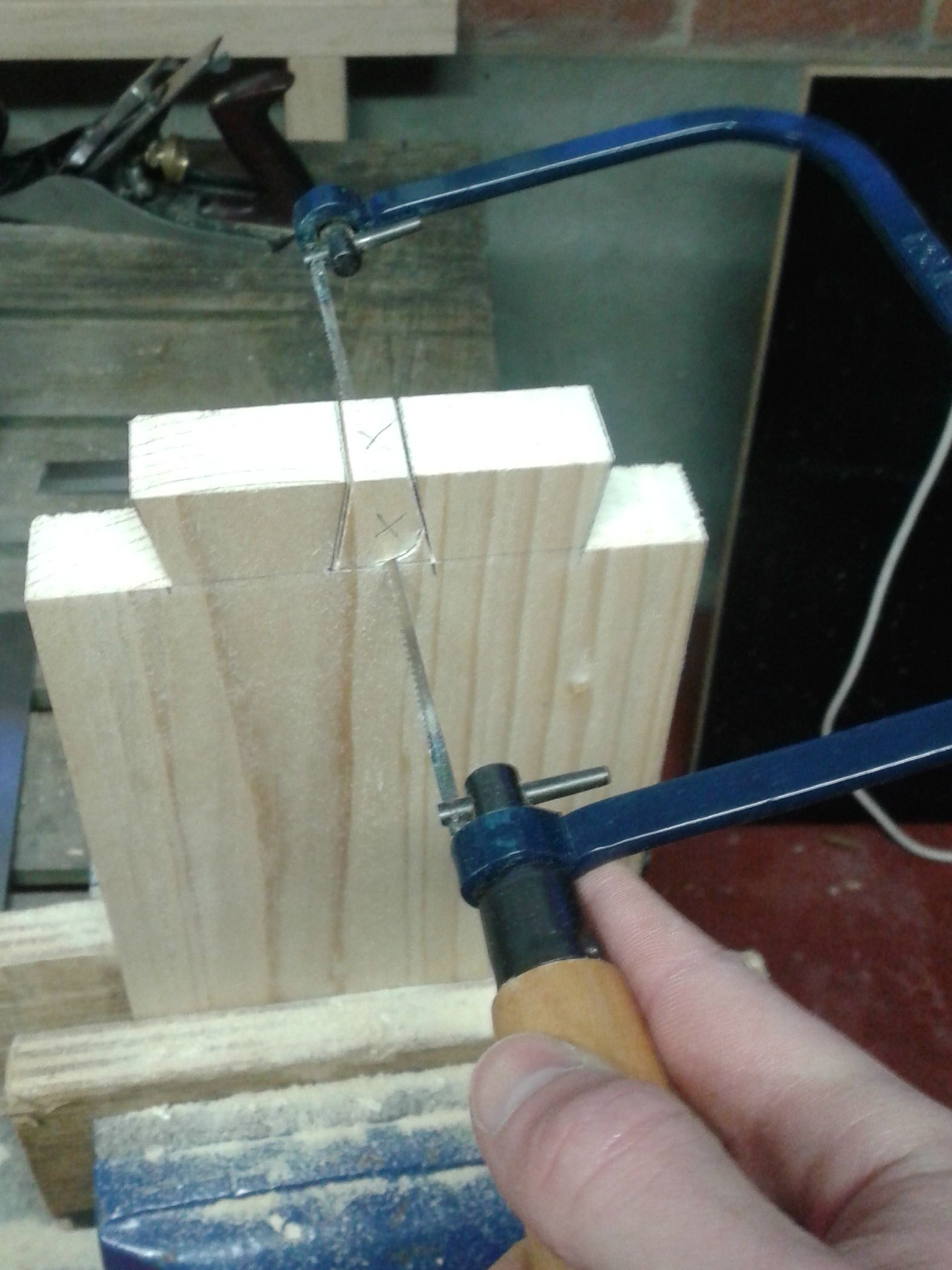

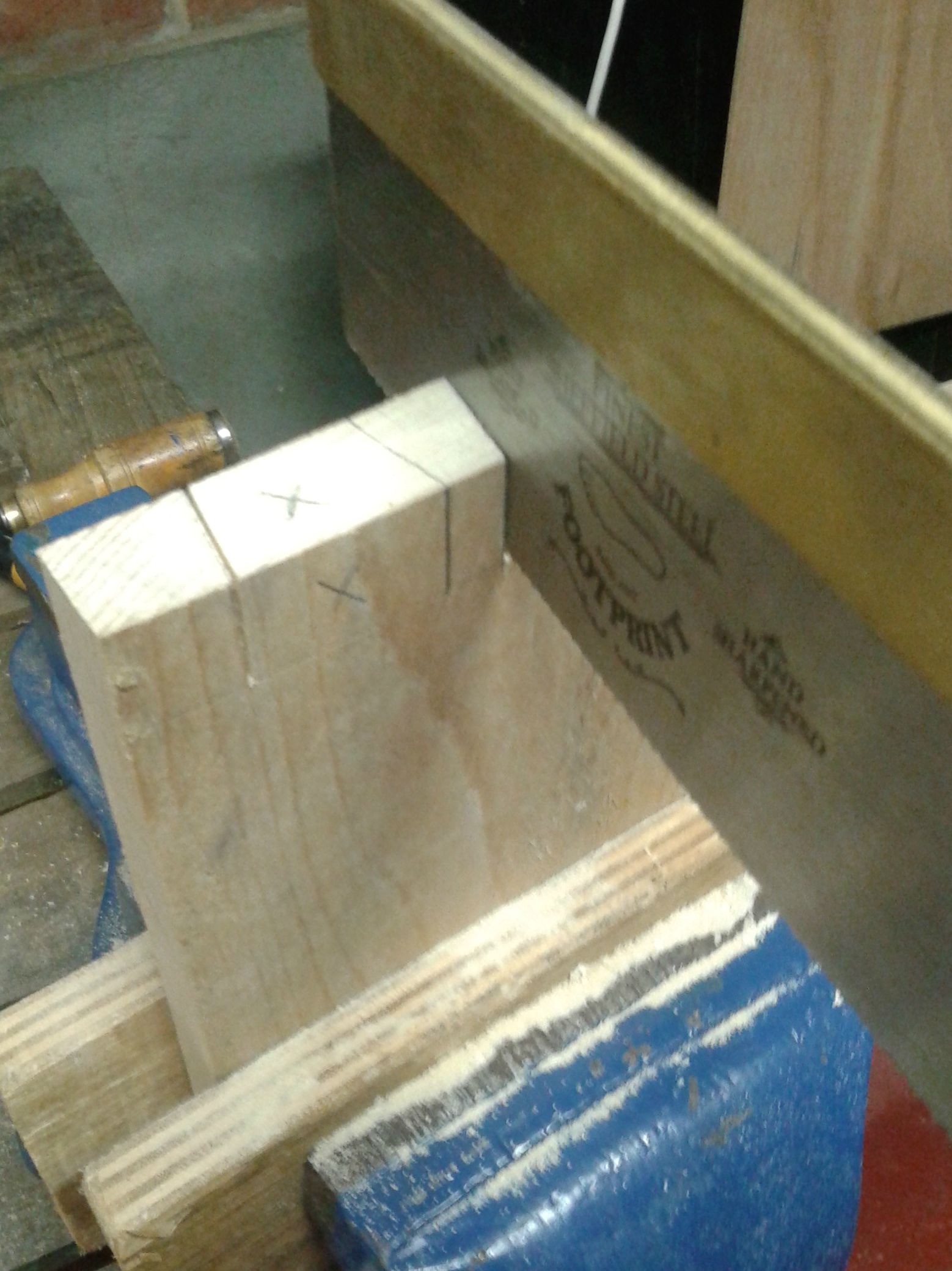

Originally, I wanted to make a simple drawer, held together with nails. But then I decided to make dovetails, just for the fun of it. I won't go into detail about how to make dovetails, because Paul does a far better job at it. And it would lead us too far for a beginner project anyway. So I'll stick to the essential steps, and put some photos of the dovetail process at the end of this step. Whether you use butt joints or dovetails is entirely up to you.

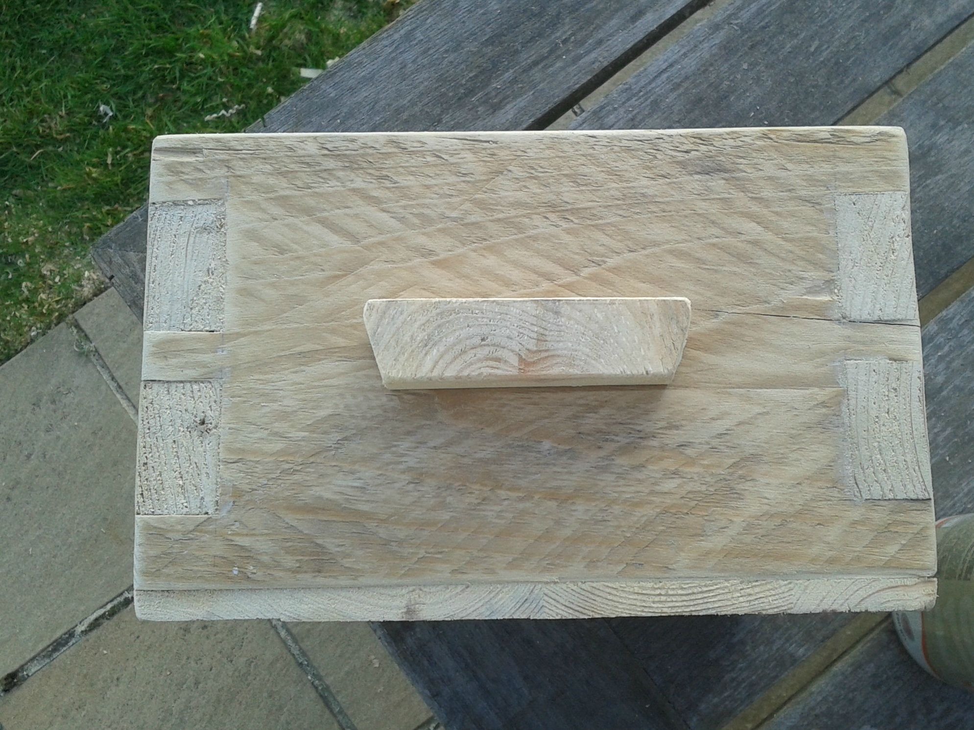

To finalize the drawer, I made a handle from a scrap piece:
I cut the angles with a hand saw and rounded the corners with sand paper. Initially I just glued it in place, but then I realized it was end grain, so I reinforced it with 2 screws on the inside of the drawer.

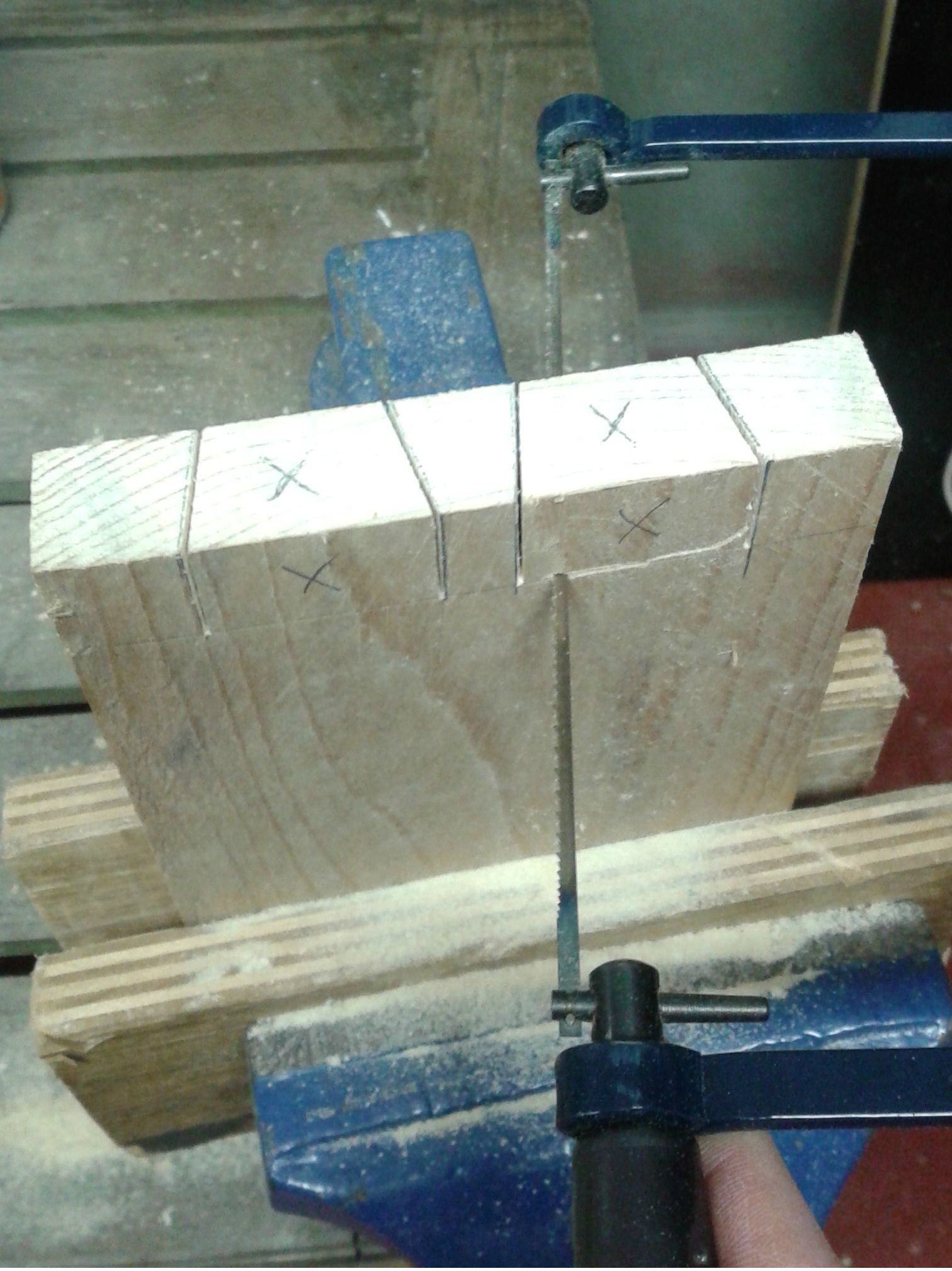

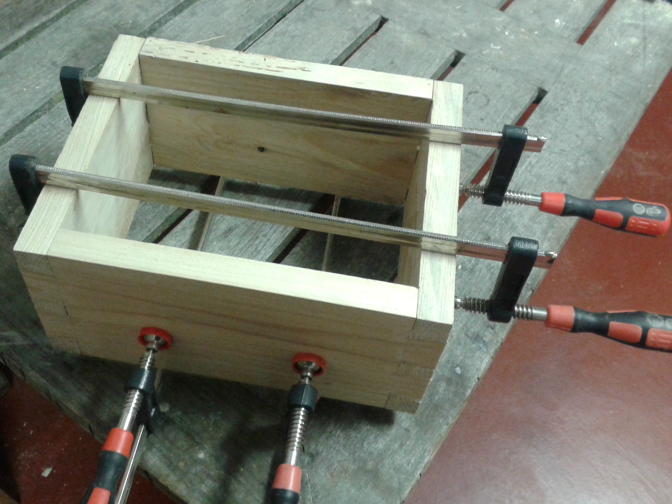

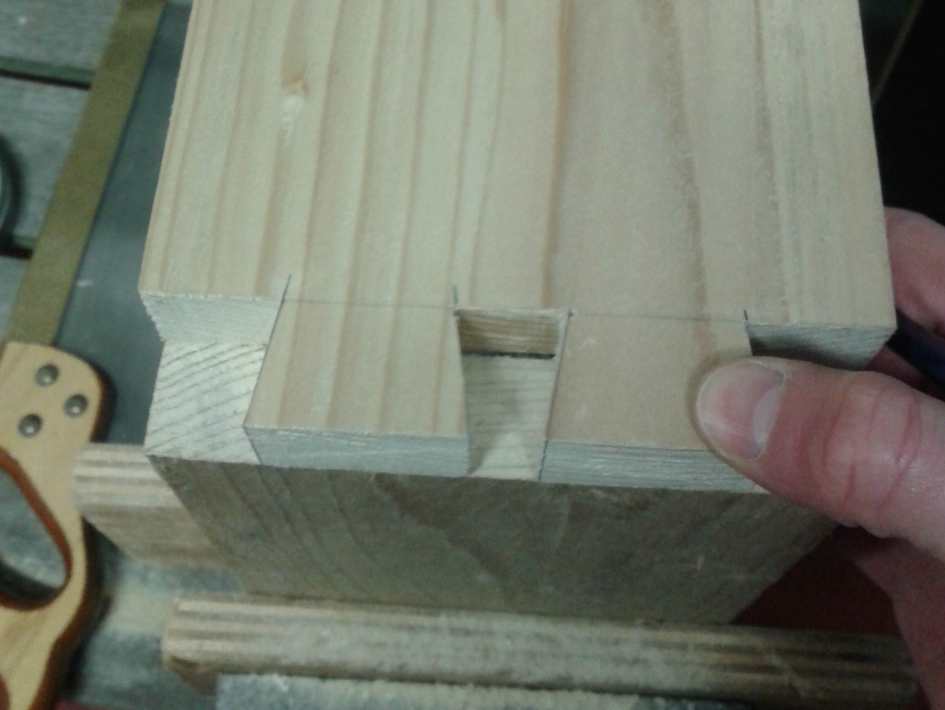

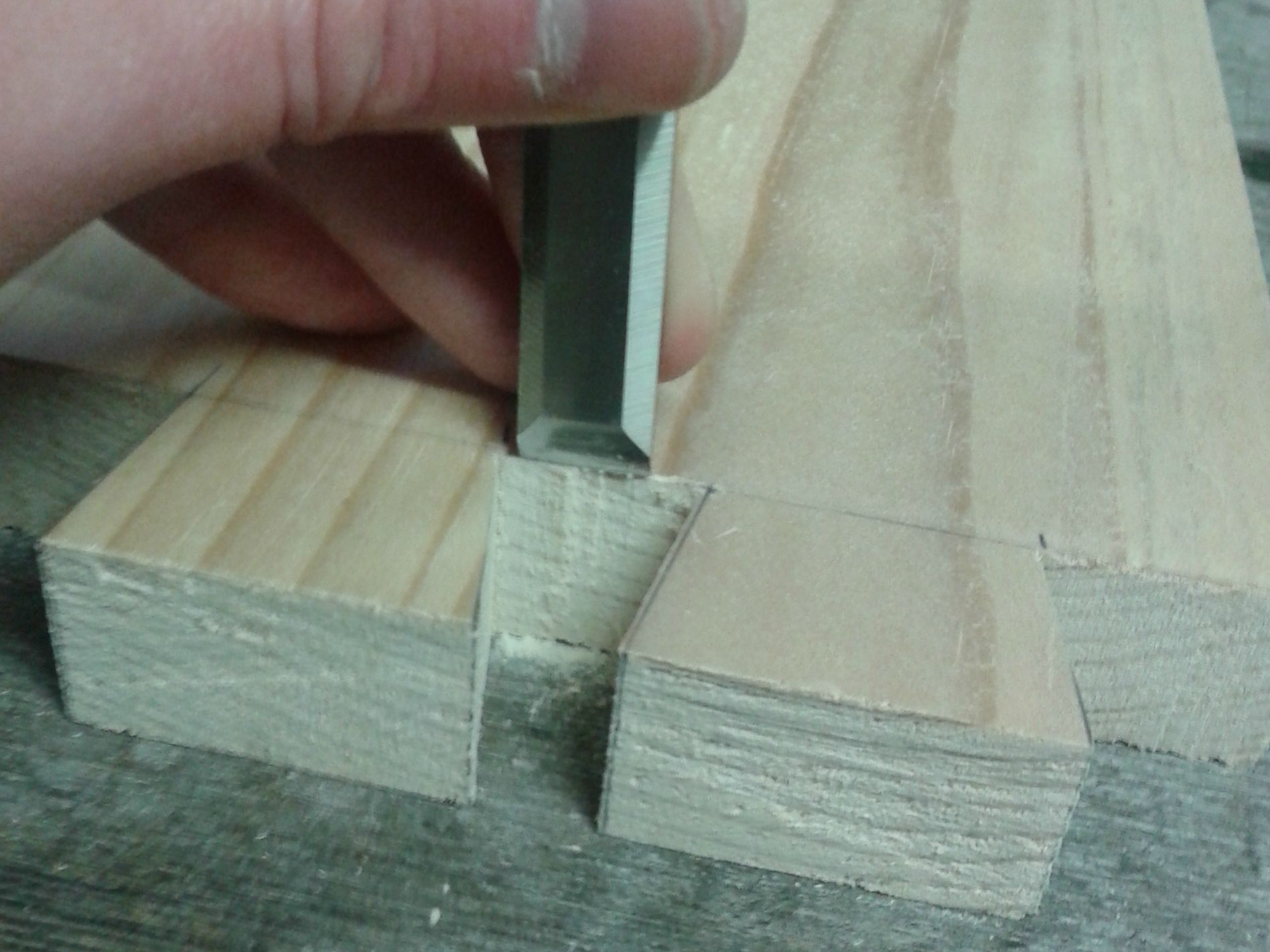

As promised, here are some additional photos of the process of making dovetails:

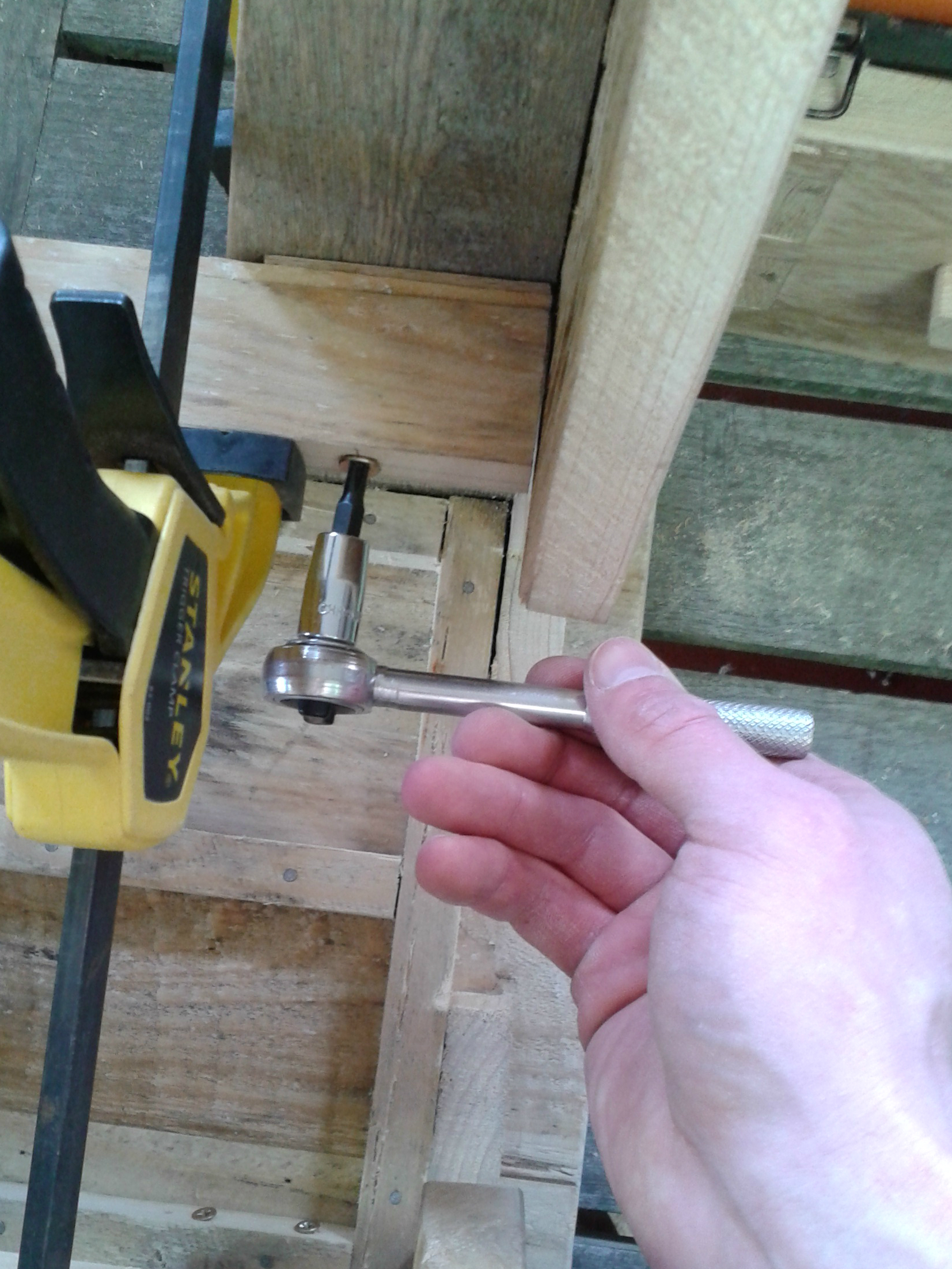

Test if the drawer fits, and trim where needed until it does (pic 4). The drawer runs on two supports called 'runners'. These runners are 40 mm wide and slightly less than 260 mm long. The side that contacts the drawer is planed smooth for easy gliding. Pre-drill both runners and position them on the bottom of the drawer, with a folded paper underneath (pic 5). This paper makes sure the drawer has enough clearance to run smoothly. Once you got the correct position, clamp the runner to the legs and put the screws in place (pic 6).
Repeat for the other runner. In my case, there wasn't enough room anymore for the drill, so I drove the two screws in manually:
Notice I had to put a shim in the corner to make the runner parallel.
