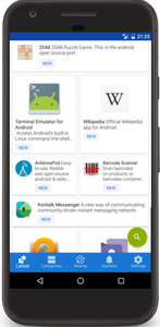

Step 1: Install F-Droid and Termux
F-Droid is an Android app store that allows you to download open source apps.
  1. On your mobile go to https://f-droid.org/
  2. Download the F-droid apk file.
  3. Install F-Droid by opening the apk file. (There will be a warning as the file is not downloaded from Google play store)
  4. Open F-droid and wait for the repositories to sync
  5. Use the search bar/button to find Termux (It is Termux not Termux:GUI or Termux:Tasker)
  6. The install might take a few minutes and might have a popup to allow F-droid to install apps
