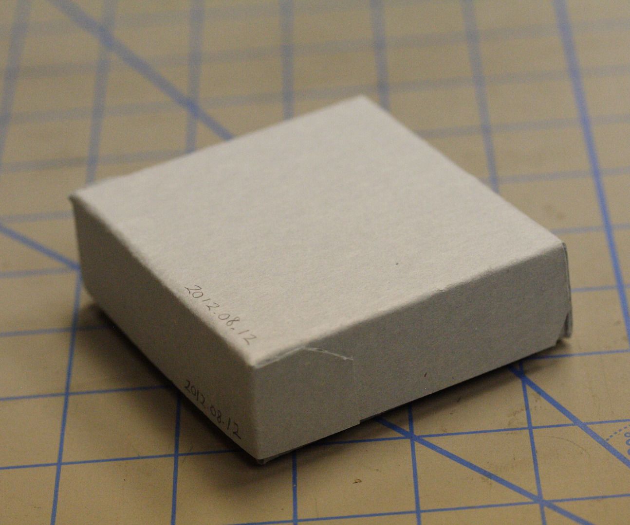

Step 16: Attach the Box
Mark the four-flap box with an arrow on the back (rear cover) to indicate the top (head), ensuring that the tab and slot are facing in the desired direction.
We have the tab on the right and the slot on the left, so the box in pushed closed as it is placed onto a shelf (rather than being pulled open by friction with neighboring books on the shelf). With the outer case, this becomes less important.
