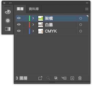

I use Adobe Photoshop for coloring and Adobe Illustrator for layout. Following the file requirements provided by the UV printer, I created two additional layers: the "Crosslinking" layer (green area) and the "White Ink" layer (gray area). This results in a file with three layers in total (the third layer being the CMYK color layer). Finally, I convert the file to PDF format to ensure compatibility with the UV printer.
