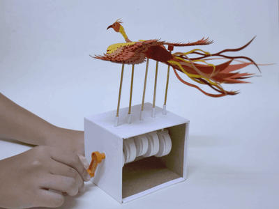

I made this paper automata toy during lock-down and I would like to share how to make it with you all.
It works on hand cranked, cam and follower mechanism which animates the flying Phoenix.
So lets get started!
Construction of Automata
The automata is mainly made up of three parts:
1. Box
  • The box acts as supporting structure for the mechanism and the moving parts.
2. Cam & follower mechanism
  • This mechanism is what animates the flying motion of the Phoenix.
  • It has a crank handle attached to rotate the mechanism.
3. The Phoenix (the object you want to animate)
  • This is the piece which gets animated or moved in a sequence by the cam & follower mechanism.
  • In this case, I have chosen a Phoenix but you are open to explore other birds too.
  • You can see in the diagram, the skewer sticks act as follower rod and transfers the motion from the cam to the bird.

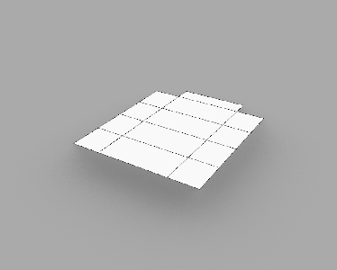

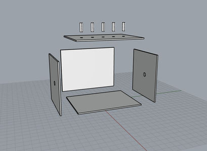

Step 1: Making the Box
I have attached a pdf file with schematic diagram for each part with its dimensions. Print the diagram on an A4 sheet and use it as a stencil.
Material needed:
  1. 2mm Mount board
  2. White cartridge paper
  3. Paper cutter
  4. Glue
Step 1: Use the diagram to cut out all 5 sides of the box.
  • The bottom and front side do not have any hole cutout on them.
  • The two side wall have 1 hole of size 8mm diameter each.
  • The top side has 5 holes of size 5mm diameter each.
Step 2: Using glue, paste all the 5 sides to make a box as shown in the gif animation. Set it aside to dry out completely.
Note :Make sure you align and match the hole positions on the side faces while pasting.
Step 3: Till the box is drying, cut out a clean white paper to paste it on each side. You can use the same diagram to cut out the hole position on each side.
Step 4: Finally, make 5 paper cylinders of height 15 mm and diameter 5 mm.
The easiest way to do this is to find a straw or a stick of 5mm diameter and roll a 15mm wide paper strip around it to make a roll.
Step 5: Paste these cylinders around each hole on the top side as shown in the gif animation. These cylinders act as guides for the skewers stick.
You box is ready!

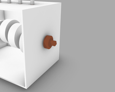

Step 3: Assembling the Axle and Crank Handle
I have attached pdf files with schematic diagram for each part with its dimensions. Get all the parts laser cut in 5mm MDF.
Material needed :
  • 5mm MDF sheet
  • Wooden dowel (Diameter - 6mm, Length - 20mm)
  • Glue
Step 1:Make the crank handle
  • Refer the gif animation and insert the dowel in the MDF laser cut part and glue it together.
  • This is the crank handle you will use to rotate the cam assembly.
Step 2 :Assembly
  • Refer the gif animation to assemble the axle and 5 equally spaced cams inside the box. You can also refer the schematic diagram inside the pdf file.
  • After inserting all the cams, attach the stopper on one end and the crank handle on the other end to lock the whole assembly. You can glue it together if the fit between the parts is loose. Refer the gif animation.

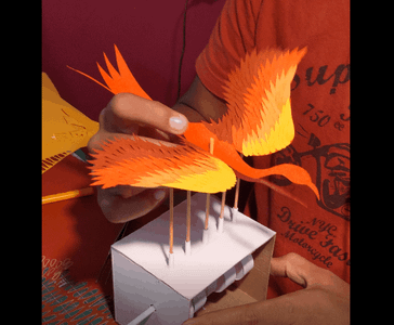

Step 6: Final Assembly

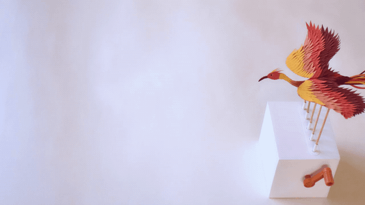

Step 1: Insert central skewer stick through the Phoenix as shown in the gif animation. Adjust the position such that it is aligned centrally with the box and parallel to the ground.
Step 2: Apply glue and paste the two halves together in the exact same position.
Step 3 : Refer the second image above, to paste the remaining skewer sticks to both the wings. Using a strip of paper, create a roll (like quilling) and paste it around the tip of the skewer. This will create enough surface area to glue the skewer to the wings.
You automata is ready!
