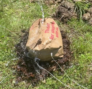

Step 7: Prepare to Place the "Pig"
- Wet the paper bags, containing the pork butt.
- Place a thick bed of wet leaf litter on top of the oven rack with handles.
- Place the wet bag of pork on the leaf litter.
- Jab a temperature probe (or two) through the bag and into the pork.
- Cover the pork bag with more wet leaf litter.

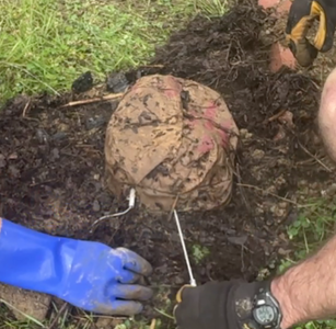

Step 9: Wait, Monitor, and Exhume
The new guidance on pork is that a roast needs to reach 145 degrees Fahrenheit in order to be safe to eat. But people who know their pulled pork say that a pork butt needs to get up to around 200 degrees to achieve easily-pullable, melt-in-your-mouth consistency. I'm not sure what temperature ours reached. It had climbed to 156 when I went to bed, and it was down to 143 the next morning. I'm guessing it peaked between 160 and 165.
- At the very least, for safety, wait until the pig reaches 145 degrees.
- Again, for safety, remove the pork butt before the temperature drops into the "danger zone," around 140 degrees. We waited about 19 hours, and our roast never dropped below 140. We could have stopped it earlier, but we're late risers.

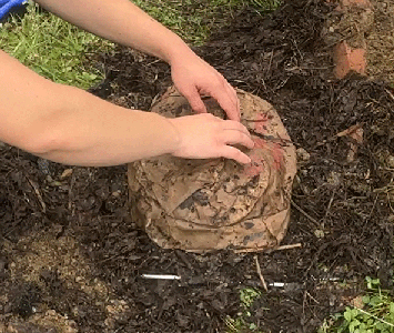

- Dig down until you hit the top oven rack. Then dig more carefully. Tug on the wire handles occasionally to see if the pig and lower rack are loose enough to lift. It would not be good to break a wire, so don't pull too hard on them.
- Use the wires to lift out the pig. Brush away the dirt and leaf litter. Peel back the wet paper bag and try a sample taste. You should be able to easily pull some off with your fingers.
- Use some lifting forks to transfer the butt to a clean cookie sheet.
