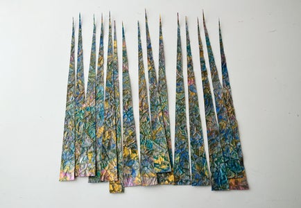

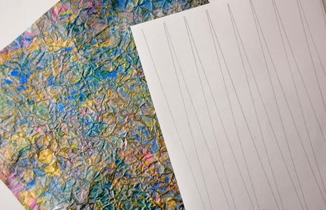

Step 3: Cut the Strips You Will Make Into Beads
Take the flattened brown paper fabric and a 1 inch tapered bead template. If you do not have a template, you will need to measure out some triangles on the back of the paper. To do this, measure 1 inch sections along one edge and then half inch sections opposite, along the top edge. Using a ruler, draw lines to create long triangles all across the width of the paper.
For info on how to get the templates for various size beads, see my web address at the end.
If you are using a template (I would recommend getting templates or making your own if you are going to make lots of beads), turn your brown paper fabric over so the messy side is facing you. Turn the template over to the blank side and using the roll-on re-positionable glue tape, put four lines of glue across the template,
Stick it with light pressure to the back of the brown paper fabric.

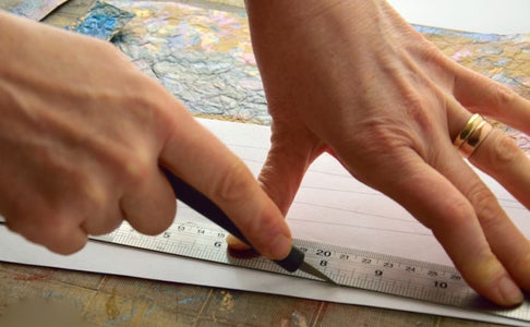

Using a craft knife and metal ruler or a paper trimmer, carefully cut along the black lines to create your bead strips.

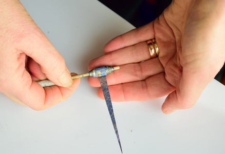

Step 4: Roll Your Beads
Using either a tooth pick or a bead roller, carefully roll each strip reasonably tightly.
Although many people get along very well using tooth picks, I have never been able to get the knack of getting the end rolled under nice and tightly to start rolling.
I gave up and started looking at bead rollers. There are many for sale online but in the end, I set out to make my own. I used a few different things in the beginning (including a cotter pin from the hardware store). That little slit is just perfect for trapping the end of the paper so you can roll quickly and easily but I found I couldn't get it off the cotter pin. In the end, I made a bamboo bead roller (shown in the pictures here) and it has taken the frustration out of using the tooth pick method. If you have the knack, then carry on with the tooth pick. My fingers just couldn't get it!
My home-made rolling tool is similar to many for sale on line. It has a large removable bead on one end and a fixed rolled paper handle at the other. I simply remove the bead, slide my paper strip into place and start rolling it fairly firmly until it is nicely caught up. Before it gets too far into the winding, I remove the bead and then gently wiggle the paper strip down nearer to the end of the tool for easy removal once it is fully wound. Practice does make perfect and once you are actually doing it, it's all quite intuitive anyway. You kind of 'feel' your way with the beads.
Just try to roll them nice and evenly so you get a good taper at either end. Keep them firm. If your bead gets a bit uneven, just ease it back and re-roll it. It really does become second nature. You will find yourself easing back and adjusting as you go to produce beautifully shaped beads.And remember, they are handmade so you don't want a factory produced look anyway.

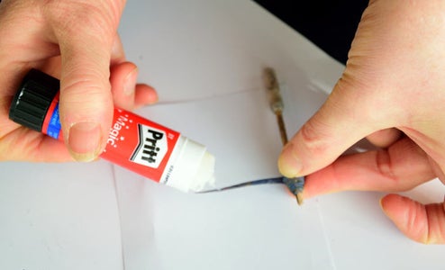

When you have about an inch of paper left, gently squeeze some white tacky glue onto it and wipe any excess off with your finger. I try to keep a wet cloth handy for wiping gluey fingers across but I mainly use my jeans!!! I sometimes use Pritt Stick to glue the ends instead of white glue. Then finish rolling and firmly smooth down the end.

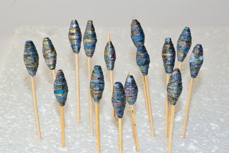

Next you need to give your beads three coats of sealer. To make this easier, as each bead is finished rolling, I put it straight onto a tooth pick and stand it up by pushing the end of the tooth pick into white foam packing material. We used to call it Styrofoam not sure if it is still called that.
Tip: When your bead comes off the roller, the end where you started by pushing it into the bead roller slit will still be across the opening of the bead holes. (See pic above). Although you ultimately will want to straighten this out - don't do it just yet. I find that if I stick the toothpick up the narrowest part of the bead hole, the bead sits snuggly on the toothpick while I am painting the sealer on and I can twirl it against the paint brush. If you straighten this out before you are ready, the beads will just slide up and down the tooth pick and become a nightmare to paint.
Let each coat of sealer (glossy decoupage glue) dry for an hour before putting the next coat on. I let the last coat dry overnight. I also put a coat of Diamond Glaze on these beads because I thought the extra glossiness would suit the bead. Then let the glaze, if you use one, dry overnight too.
Tip: To keep track of which beads have been glazed and how many times, I have a large square of Styrofoam with the numbers 1 to 3 marked at three corners. As my beads come off the roller, I stick them in the corner with no number until they are all done. Then as I put each coat of sealer on, I move them round to 1, 2, and 3. When I am doing huge numbers of beads at once, this system works really well.

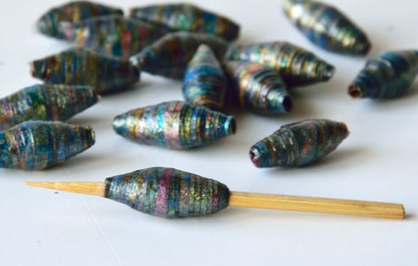

Once your beads are sealed. glazed and absolutely dry, take a bamboo skewer and push into the bead holes to get rid of the flap created by rolling. Make sure you have a clear hole straight though and snip off any extra bits of sealer or glaze that may have built up around the edges of the holes.

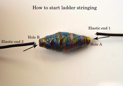

Step 8: How to Ladder String the Beads
Take 4.5 feet of 1mm black elastic and lay it on the table with end 1 facing bead hole A and end 2 facing bead hole B as per picture.
Push the ends into the holes so they pass each other inside the bead and come out opposite ends.
