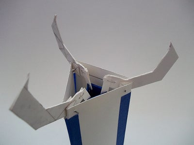

I made a paper claw a few months ago on instructables, and that design wasn't very good, it was small, it had rubber bands on it so the outside didn't look too great and it couldn't pick stuff up. I knew that I could make it better, the way of how it moved and was put together was not created until then, and I so far haven't seen any claws that use a design like this. This claw is based loosely off that design by that it has the same way how it is held together, every thing else is different and better.
This new design is bigger, it can now pick stuff up,and it uses a different way of making the claw open and close, so there is no external parts except the claw segments. It could also be made to suite to what you need, metal for heavy duty, it being longer to pick up stuff for the disabled, plastic for the cost and strength, or any thing else that is flat that you have laying around!

Step 8: Puting It All Together
Get the inner segment, the outer segment parts, the paperclip, and the tape.
Cut the paperclip to three segments, each one is 3/4 in. long and put it in the upper hole on the claw segments, as in picture 2. Get one of the body segments and fold the little things at the top inward, and put it on like shown in picture 3. Keep on doing it for the other 2 body segments and make sure it looks like picture 4
Get the tape(any tape) and tape around the edges, make sure to not get in the way of the movement of the claw and try to make it look like picture 6
Step 9: You Are Now Done!
Congratulations!
To use it you hold onto the outer segment with one hand and the inner segment in the other hand, bring the inner segment out to close it, bring it in to open it.
