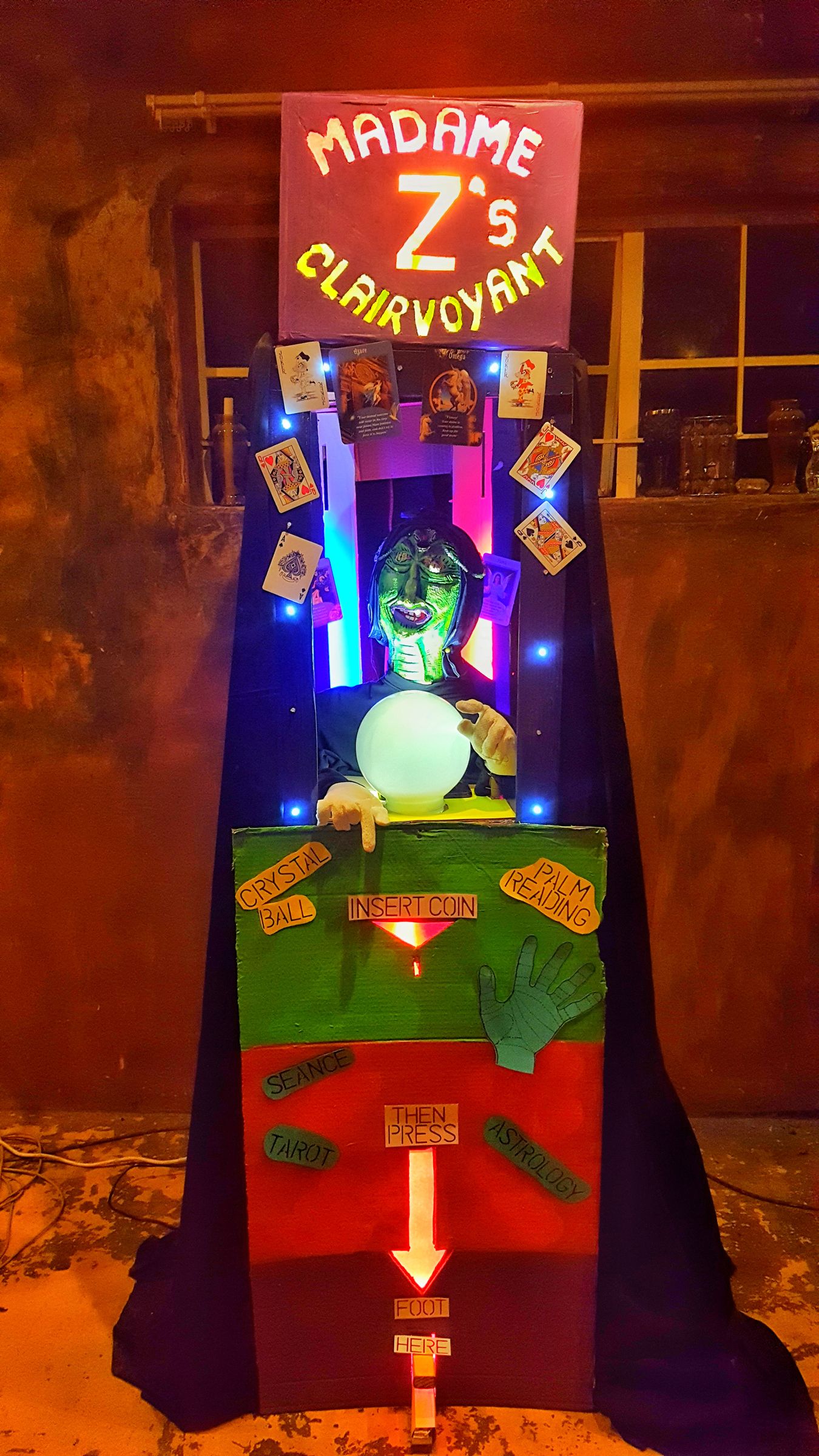

Step 10: Other Stuff to Make
Once you got the hang of it, there's all types of objects you can make, using the same process.
The Killer Croc I did within a week including drying time in the sun.
In (photos 4-7) this project I've tried to do as much fine detail as possible, which takes a lot of patience, and shows how effective paper clay can be.
