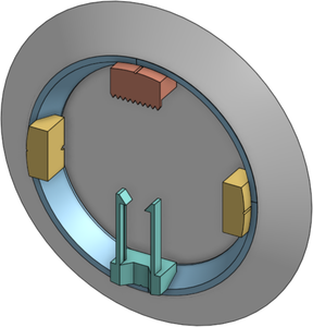

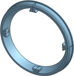

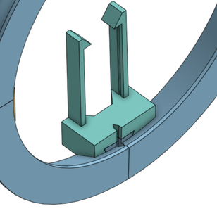

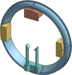

The LED strip is 60 cm long (60 LED at 100 LED / m), which determines the basic diameter for the frame: 60 cm / 3.141 = 19.09 cm. Unfortunately that is too big for my small 3D printer so I split the frame into multiple segments that will be clipped together.
The frame consists of
- 4x identical quarter circles
- 2x connecting clips (side)
- 1x connecting clip (top)
- 1x connecting clip (bottom)
You can print them all at once if your printer is big enough, or print them one after the other.
The frame will be practically invisible, so don't worry about achieving perfect print quality. Just try to make sure that there is no steps at the joints, or otherwise the paper cover would warp unsightly when attached.
I designed the parts in Onshape. If you want to modify the design (different LED strips, different boards etc.) then you can clone it directly from this link.

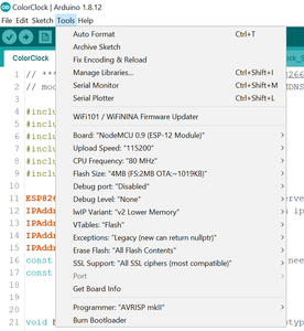

- Download the code from Instructables or from my github.
- Open it with Arduino.
- Choose your board (mine is a "NodeMCU 0.9").
- Go to Tools > Library Manager and add the libraries
- ESP_EEPROM by j-watson
- FastLED by Daniel Garcia
- WiFiManager by tzapu,tablatronix
- Go to code tab "01_ColorClock_Time" and change the time zone in line 36 to match yours. Find the right string to use here on github.
- #define MYTZ TZ_Europe_Brussels
- Connect your clock to your computer's USB port.
- Select the USB port in Tools > Board
- Click the Upload button

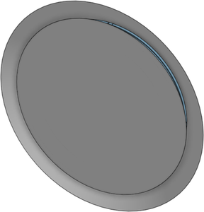

Cut a disc of 230 mm diameter. You can use a circle cutterto make the job much easier and give you a perfect circle.
Apply glue (use thin double-sided tape or solvent based glue for best results - water based glue might wrinkle the paper) to the plastic ring and place it onto the paper disc. Take care to center it well.
Cut a cone (link to calculate) by first cutting a circle (310 mm diameter), then, without lifting the circle cutter change the diameter to 208 mm and cut a second circle. You will now have a ring.
Cut a line through the center of the ring. If you happen to have a gridded cutting mat use it for alignment.
Now wrap it around the assembled ring in a cone shape and mark where the ends overlap.
Remove the paper cone and trim the section you marked, removing 2-3 mm extra. This will form the 12 o'clock gap.
Now put the cone back in place and secure it with some transparent sellotape from the back.
When you plug in the power the clock's 12 o'clock LED will light up red. Adjust the ring rotate so the gap lines up perfectly.
The paper construction is finished!

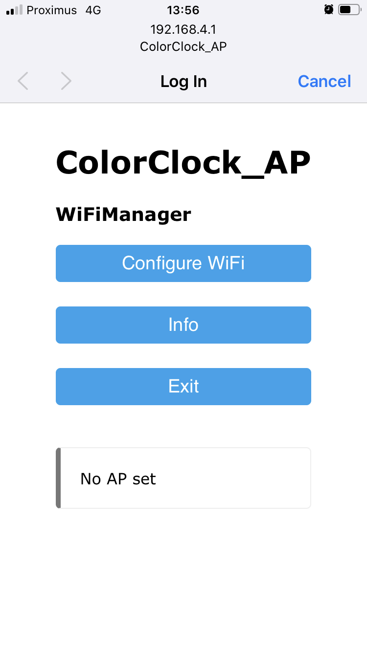

The clock will attempt to connect to WiFi to obtain the current time from the internet. If it cannot connect to WiFi it will make an AP (access point) available called "ColorClock". Connect with your phone or laptop to this WiFi network (default password "12345678"). You should automatically be redirected to the configuration portal, where you can select which WiFi network the ESP should connect to and enter the password. If it does not appear automatically you may browse to "192.168.4.1" while being connected to "ColorClock".
This portal will be available after power up until the clock connected to the internet to retrieve the time.

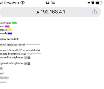

Choose colors
Once the clock can connect to the internet it will start to display the time. The default colors might not be to your liking - no problem, just change them!
Connect to the ColorClock AP, then browse to 192.168.4.1.
Tap the color box for the background / hours / minutes / seconds and choose the colors you like. You can also deactivate displaying the seconds. The order of drawing the different elements is seconds over hours over minutes over background. Confirm by tapping the "Submit" button, or tap "Reset" to cancel the changes.
You can also use the "Random colors" button to let the clock choose colors for you. After that you can still tweak them.
Set up dimming mode
You may want to increase the LEDs' brightness during the day to be easily seen, and dim them for the night.
Choose the relative brightness for these modes with the slider bars.
Choose the time to start dimmed mode (usually in the evening) and the time to go back to normal mode (in the morning).
Tap the "Submit" button to confirm your selection, or "Reset" to cancel the changes.
Demo mode
Press "Start Demo" and the clock will fast forward from the current time so that you can see what it looks like at different times, including the dimming mode. Tap "Stop Demo" to switch back to displaying the current time.
