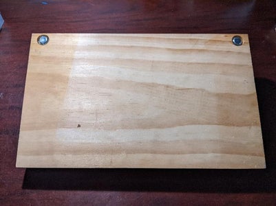

Step 3: Drill Base
Position the clamp board along the left long edge of the base and mark the location of the two holes at the edge of the clamp board. Drill a 5/16 hole at each location. Flip the board over and drill a 3/4 inch clearance hole with a Forstner bit deep enough for the head of the bolt and a washer to fit without sticking out.
Step 4: Glue Clamping Bolts
Feed a bolt with a washer through each hole in the bottom of the base. Flip it over and slide the clamp board over the bolts and tighten down with the remaining washers and wing nuts. Flip the base back over and position on a table so the bolts hang over the edge and the base lies flat. Mix the epoxy and fill around the bolt heads to lock them in place. Allow the epoxy to dry.
