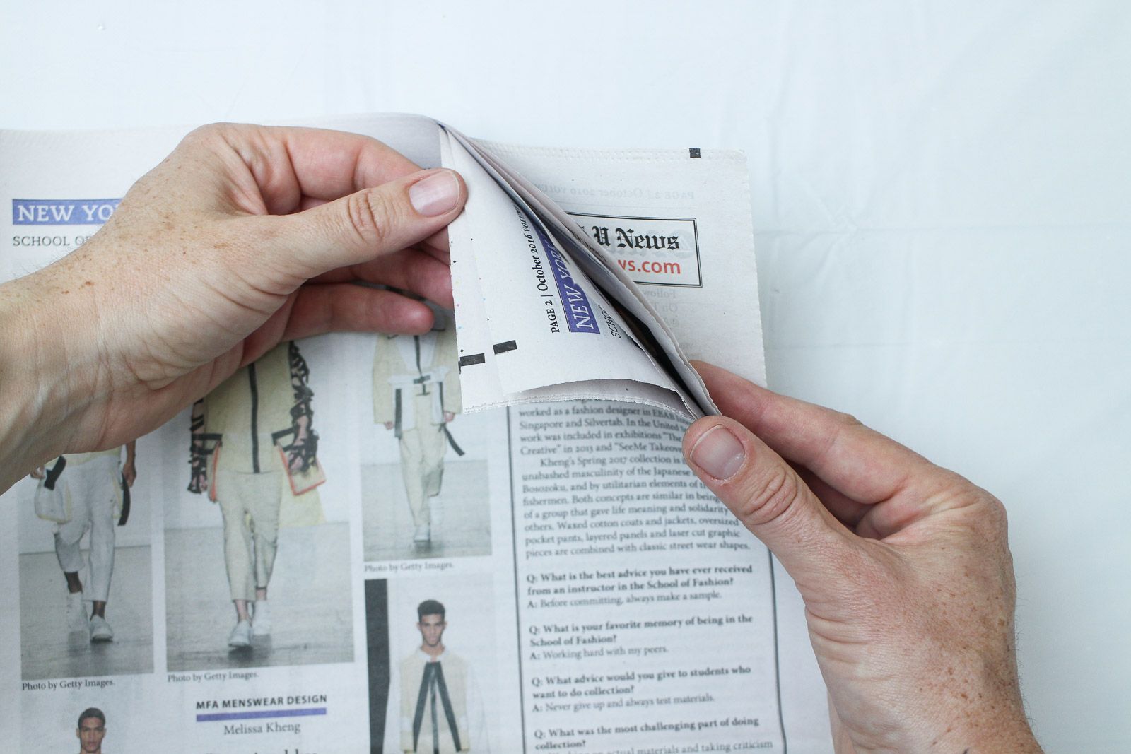

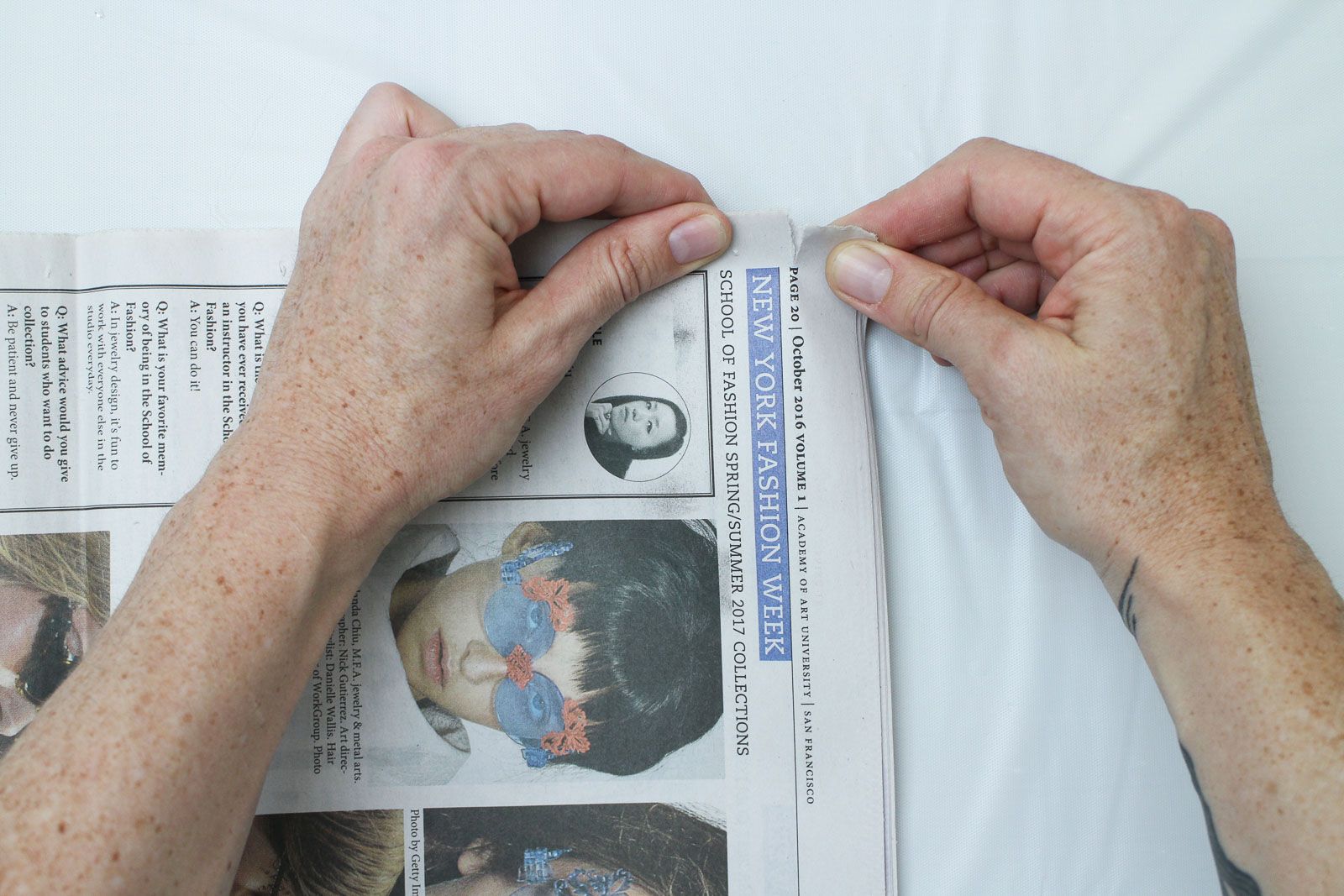

No matter what kind of paper you're using, you always want to tear your strips, not cut them. Tearing creates a soft feathered edge on the paper that will make each strip blend smoothly into the next instead of creating a sharp line when they are layered on top of each other.
An efficient way to create strips is to stack about 6-8 layers of paper on top of each other and tear them all at once.
Most paper, including newspaper, has a grain. If you tear with the grain, you will get nice, straight lines, if you tear across it, you will get jagged edges like I am below. Make sure you are tearing with the grain.
The width of your strips will depend somewhat on what are working on. For detailed areas, you want thin strips, for large uncomplicated areas, you can use wider strips. 1" is a good average width for most projects.

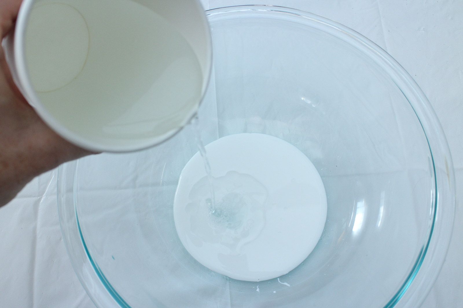

To make a glue paste, simply pour some white glue or wood glue into a mixing bowl and dilute with just enough water so the glue gets a bit less sticky and can soak more easily into the paper. I usually use around a 1:1 ratio. Stir thoroughly until the glue and water are mixed together.

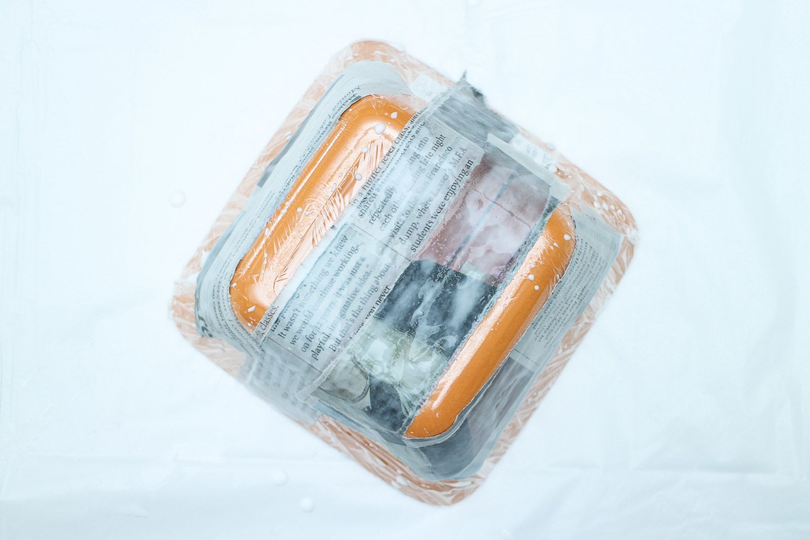

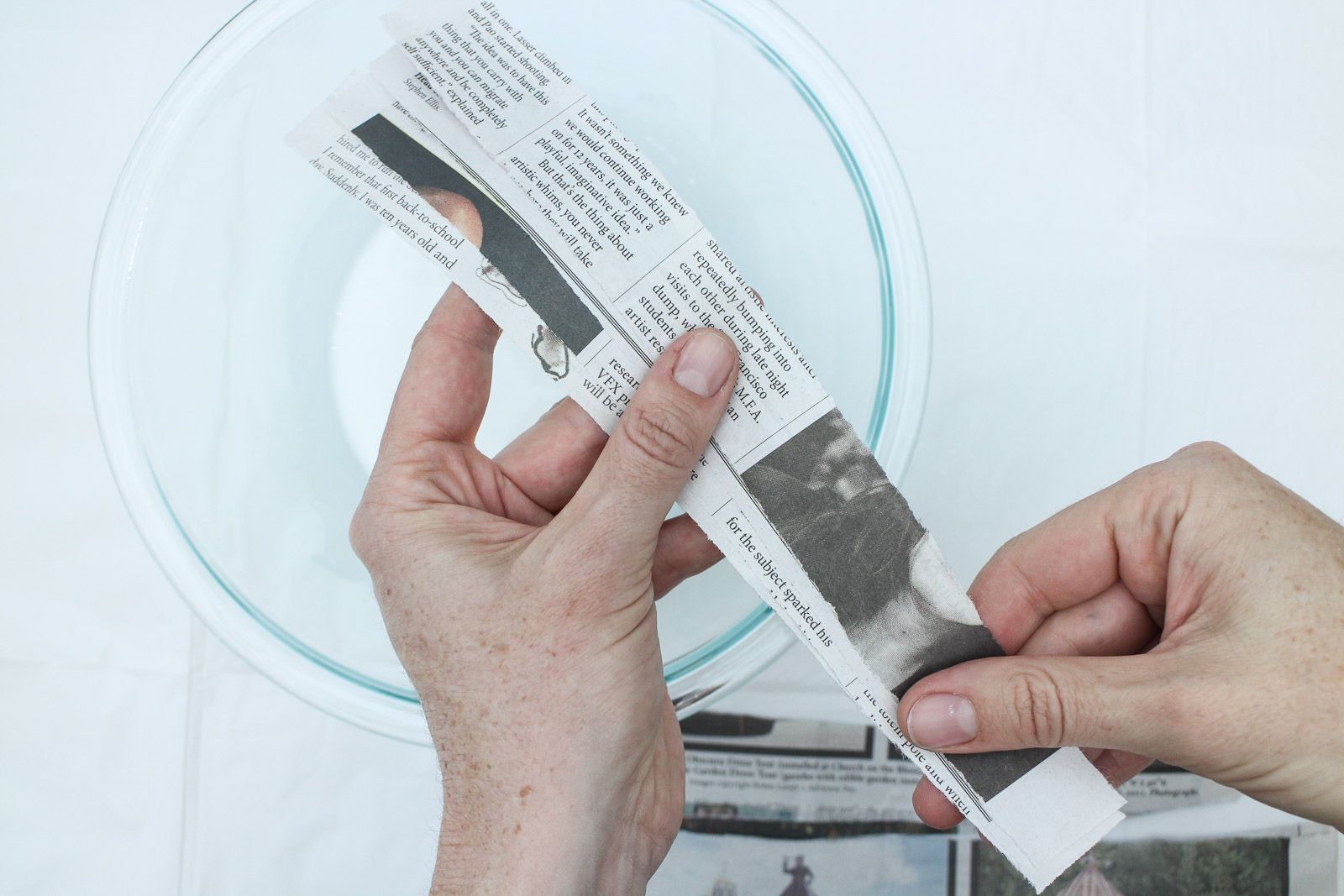

When you are working with a solid armature like the dishes we are using here, a good method is to first dip your hands in the paste and spread paste all over the base. Then apply dry strips onto this wet surface, smearing more paste over the top of each strip as you add them, and adding more strips overlapping the first. Or, you can try dipping your paper in the glue mixture and then applying it. You can even dip several layers of strips at once, separating the layers a little in the mixture so they all get covered in glue.
As you remove them, squeegee them together with your fingers to remove the excess glue.

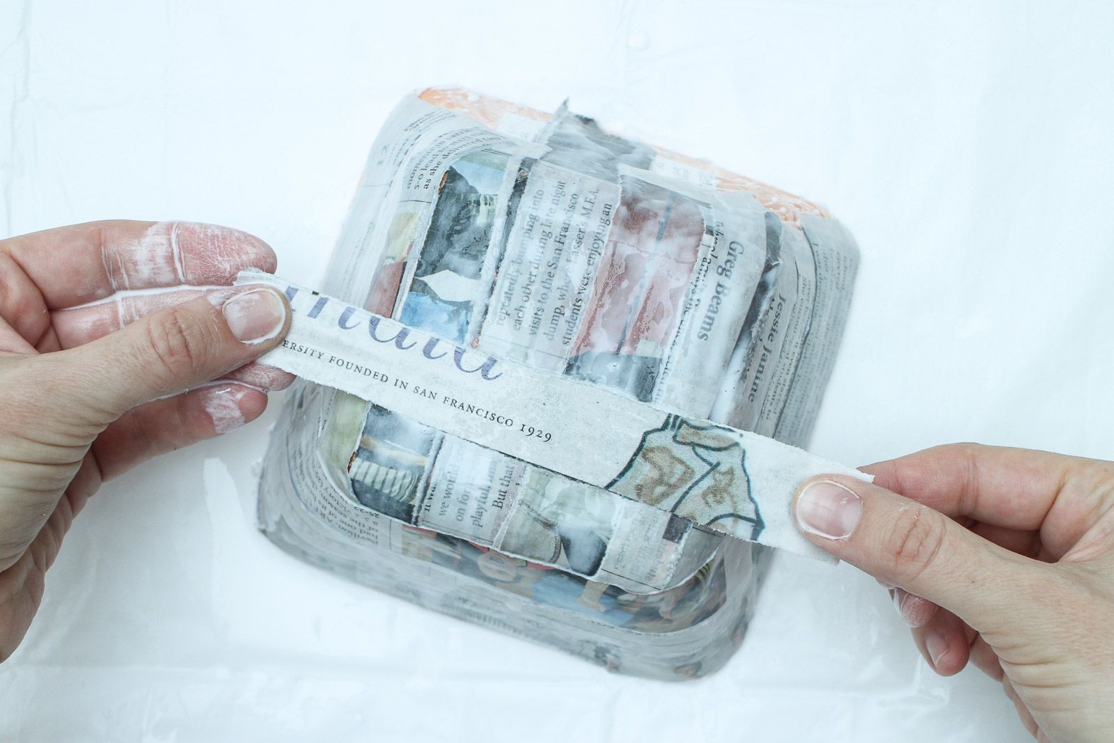

Then apply the strip or stack of strips to your surface, angling the strips so they contour to the shape of the form. Smooth them down as you go to create an even surface. Apply one layer of overlapping strips over your entire project before you start adding another layer. Glue strips can be slightly more slippery than flour strips, so it sometimes takes a little finesse to get them to stick to each other smoothly. If the multi-layer method isn't working for you, you can always just use single layers
When you add the second layer, you can give your project more strength by applying these strips perpendicular to the ones below, and switching back and forth with each layer. If you are using stacked strips, you can build up a thick shell of paper fairly fast, about 4-8 layers of paper total (so about 2-4 stacked layers) will give you a strong structure. When you create your last layer though, you should go back to using only a single layer so the outside of your shape is smooth.

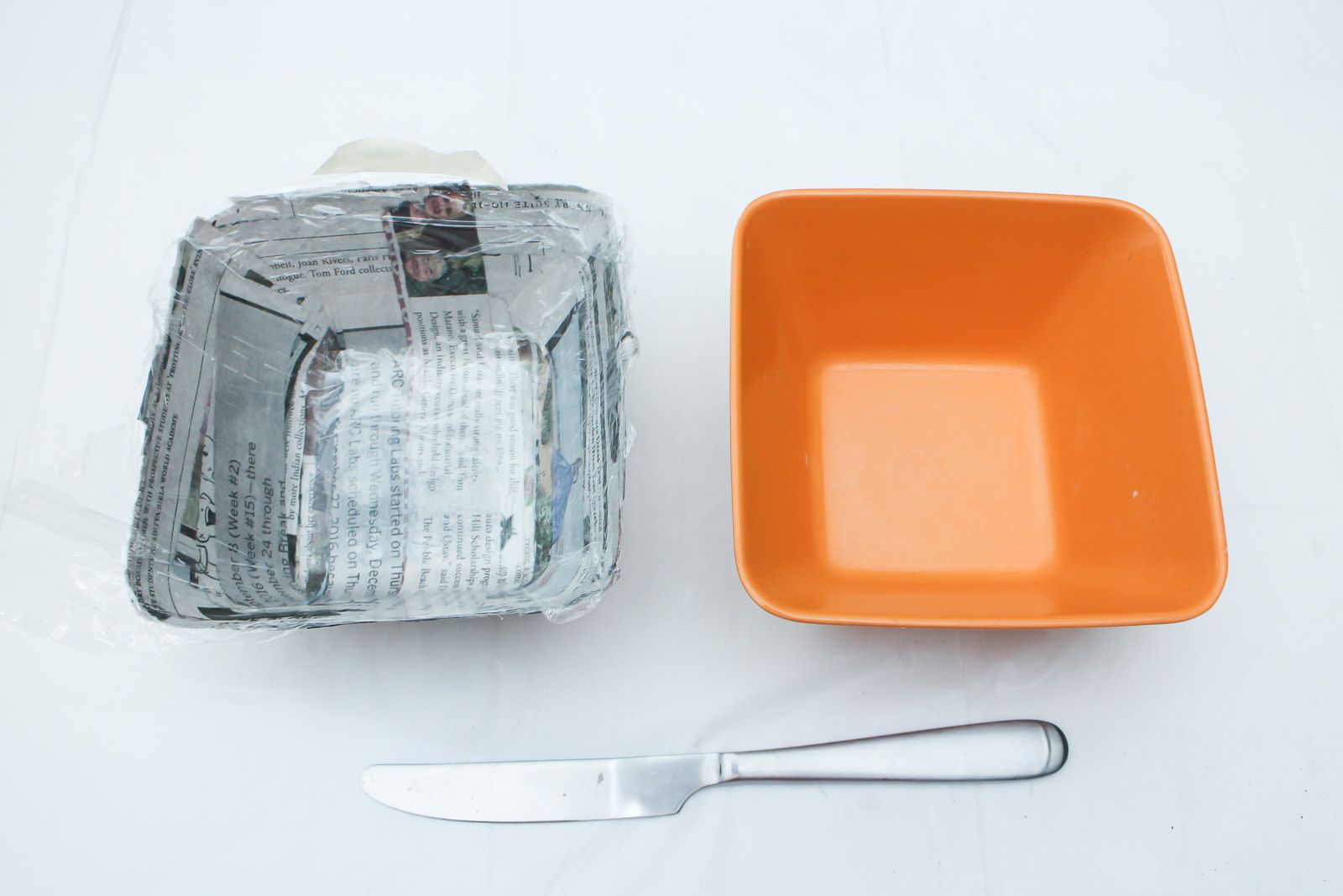

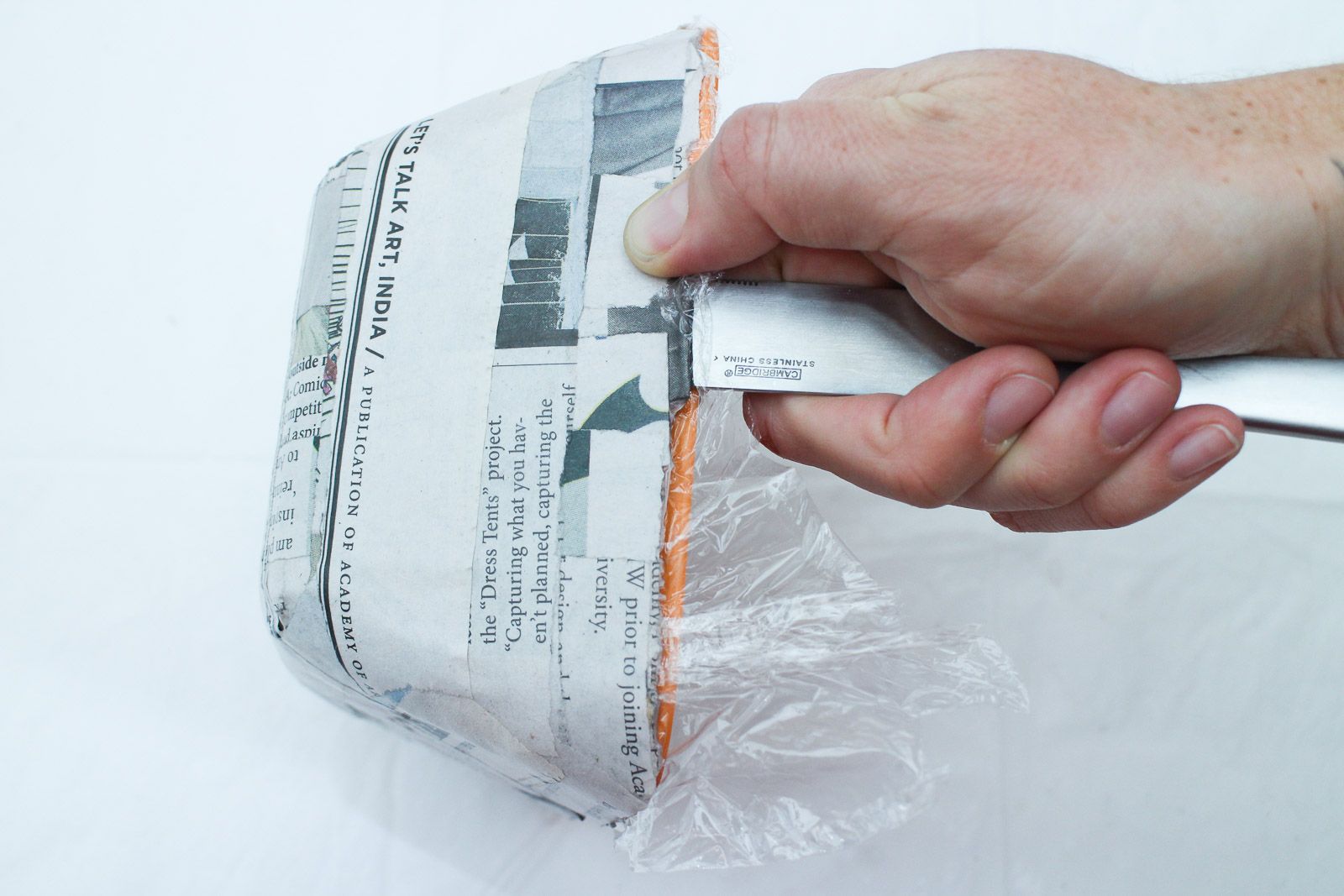

When your paper is dry, remove it from the form.
You will probably need to use a butter knife or something similar to help loosen it.

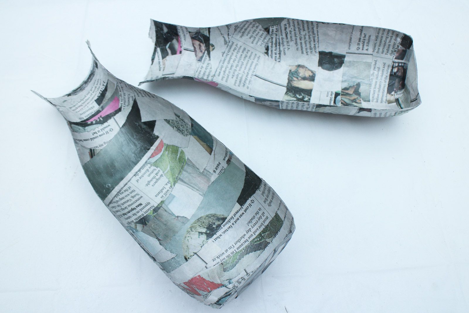

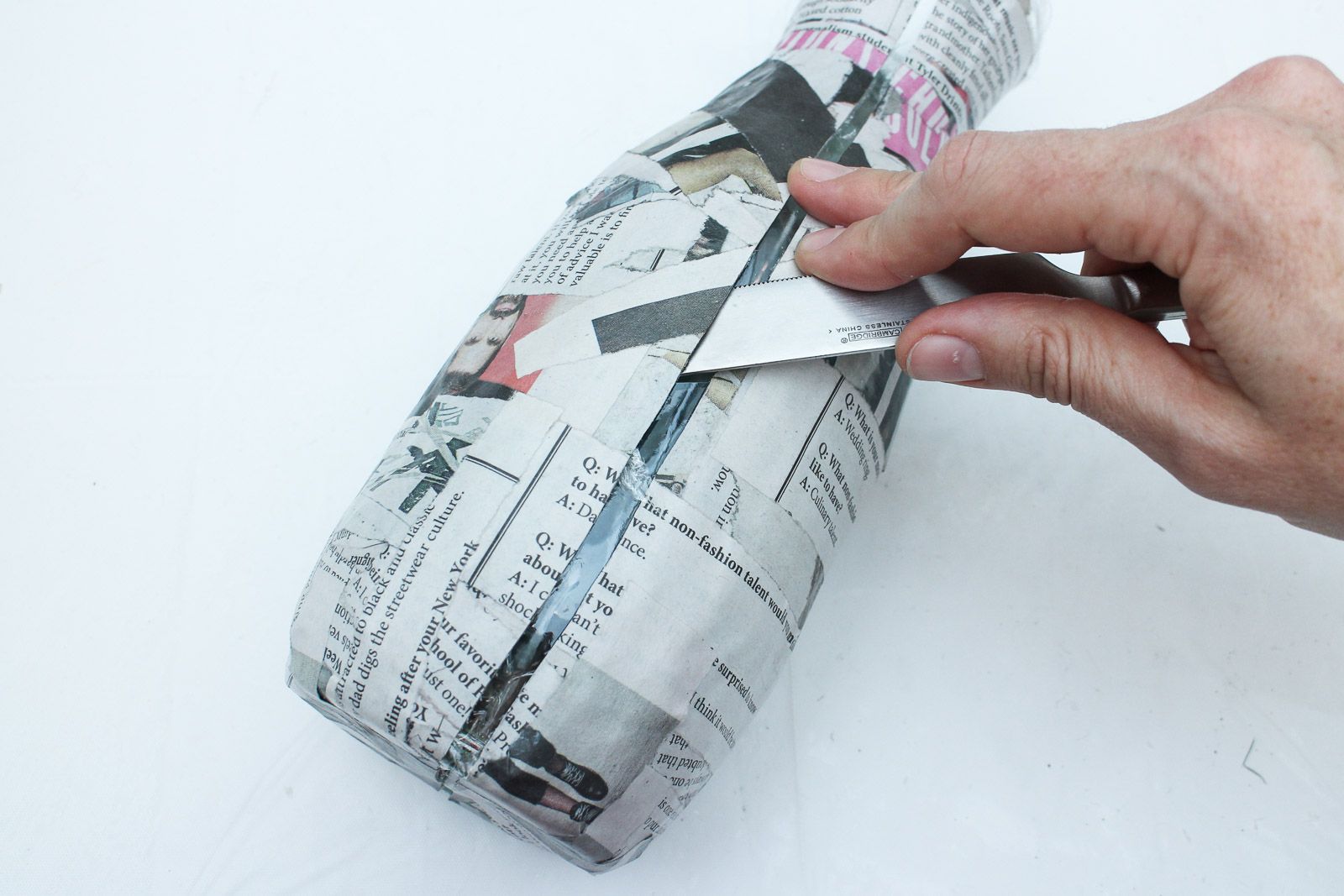

If you have to cut it off to remove it, like I did with this vase shape, use a craft knife or scissors to cut neatly through the layers of paper. Try to make as few cuts as possible so it will be easier to glue back together.
Pry the pieces gently apart with a butter knife.
Use a hot glue gun to glue your form back together if you need to, then apply more strips over the seams to hide them. You can, of course, also just use pieces of these casts to create other forms, or glue them back together in a different way to make a new shape!
