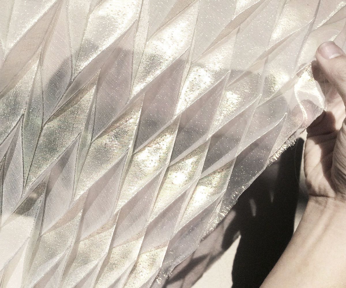

Step 8: Bake the Sandwich~ (paper Mold)
Put the paper mold into an oven, set the temperature around 160 Celsius or 350 Fahrenheit for 25 minutes.
Step 9: Check the Results
Open the paper mold to see the Origami Fabric!
