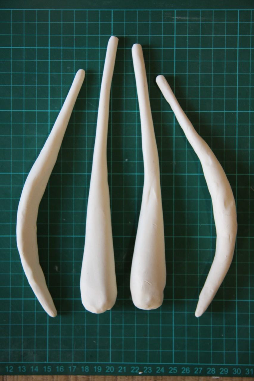

We will create two legs and two wings and join them on top to create the head
From the 250g of clay:
  • Prepare 4 chunks of clay: two of size x1 (50g), two of size x1.5 (75g)
  • The two smaller ones are for the wings. Shape them as long and thin ovals.
  • The bigger ones will make the legs. Shape them as elongated tear-drops

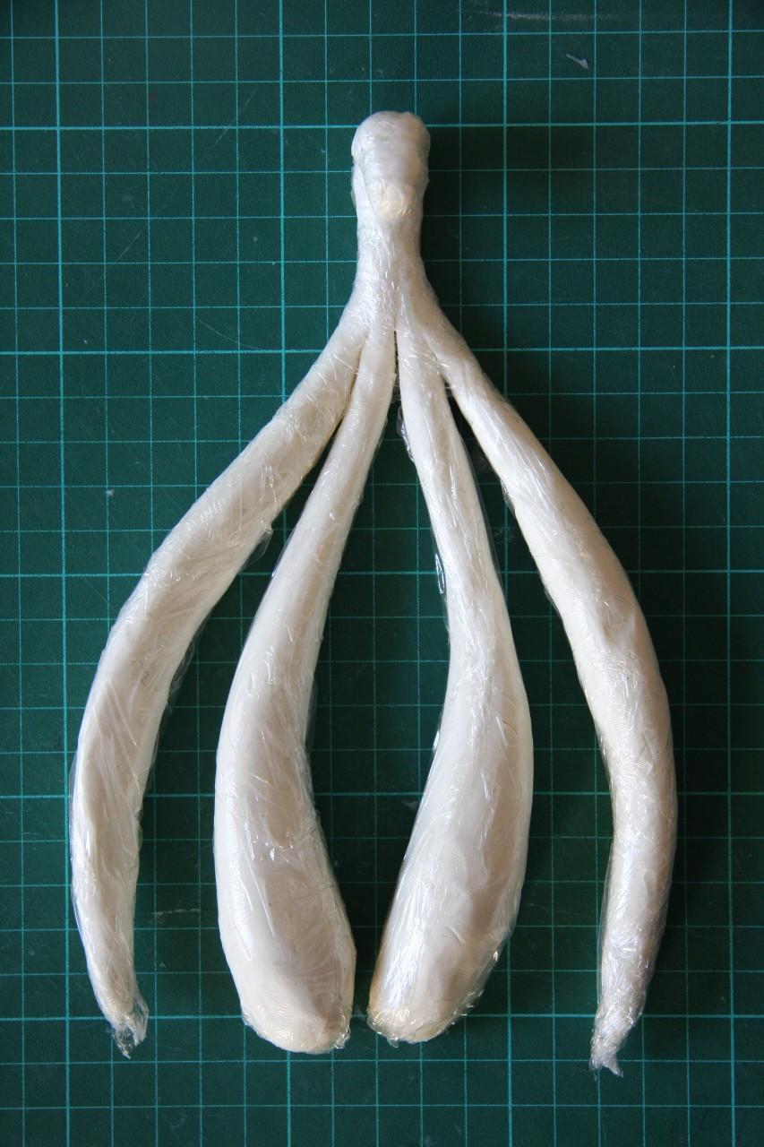

  • Assemble the shape by compacting the four top ends together,
  • Round up the top and bend it to create the head
Finally, wrap the legs, wings and head independently in saran wrap. Add a quick thin spray of cooking oil. The wrap and oil will prevent the paper to adhere to the clay.

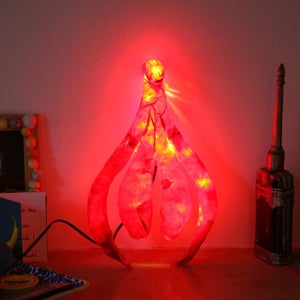

And voilà, let there be light !
