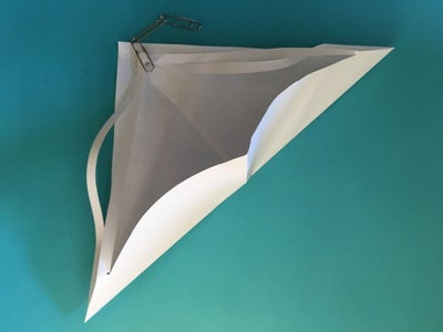

Step 1: Square Your Paper
Start by making a square sheet from your rectangular sheet of paper: fold the top left corner to the bottom edge and crease. Then cut off the rectangular leftover on the right. (Keep the leftover rectangle, you can a make a straw rocket with it.)
If you are starting with square origami paper you will not need to cut off the excess, but still fold the paper as shown.
Step 2: Fold in Half
Fold the paper in half — folding the bottom left corner up to the top corner — and crease.
Step 3: Cut Along the Long Edge
Starting at the bottom fold, cut along the long edge. Cut close to the edge (1/4 in or less). You want to cut a thin strip, but not so thin it will break. Cut up to 3/4 of the length of the side and stop (do not cut off the whole edge!) It may help to draw a line to guide the cut.
Step 4: Unfold
Carefully unfold the paper.
Gather the two “strings” together and paper clip together. A chain of about 4 clips makes a good starting payload.
