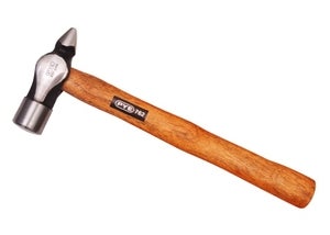

Tools
- Nails
- Hammer
- Hexsaw
- Paper tape

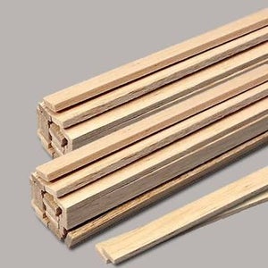

To start with, I cut wooden strips of
15cm, 19cm,15cm each
Using fevicol or PVA glue stick them to make a guide. I used wooden strip which was 20mm x 3mm, perfect for the project
Using Two 5cm long strips manner stand or legs...
Please note that we cannot use nails as the wood strip is thin and starts to split, so I have used fevicol and clamped it using paper tape or under heavy furniture
