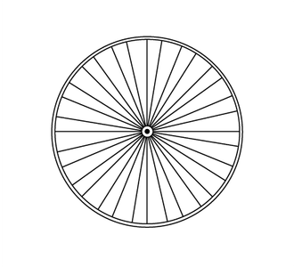

Step 1: Starts With a Bicycle Wheel
ok so you take a basic Bicycle wheel a mountain bike one would be ideal as the channel is wider where the inner tube goes, also would be better to use a larger wheel say 26" or more but it will have to be steel so you can weld it.
you need to weld the spindel to the main wheel so when it spins it spins the wheel with it not just the spindel on its own, you could take this out and replace it with a long rod which will go off to our generator.

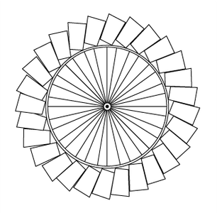

Step 3: Adding the Cups
Now you need to hot glue the cups at slight angles around the wheel so that they will catch the water as it falls. hot glue these to the wheel as well as the cup next to it.
by using hot glue it means it wont react with the water and go mushy like some glues would.

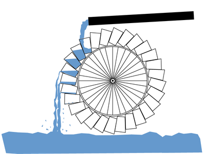

Step 4: Placement
you now need to place the wheel, i would recomend placing this over a body of water such as a pond.
place a flume above the wheel so that the end comes past the center of the wheel, guttering is ideal for this.
you will need a water source as well, ideally you would have a stream running through your garden so you could use that to channel water down your flume and run your wheel.
so it works by water coming down the flume, hitting the wheel, the weight and force of the water turn the wheel generating electricity through our alternator which can be hooked up to charge car batterys or leisure batterys for cars, electric fences (if your on a farm), or for other projects, you could even hook you phone up to it to charge it by water power.
i would like to make another suggestion, if you channel the drain pipe from you house to the flume the rain water collected from your house can be used in the wheel and then you could channel it to a water butt or drain. this would work really well here in the UK where we have a fair bit of rain.
